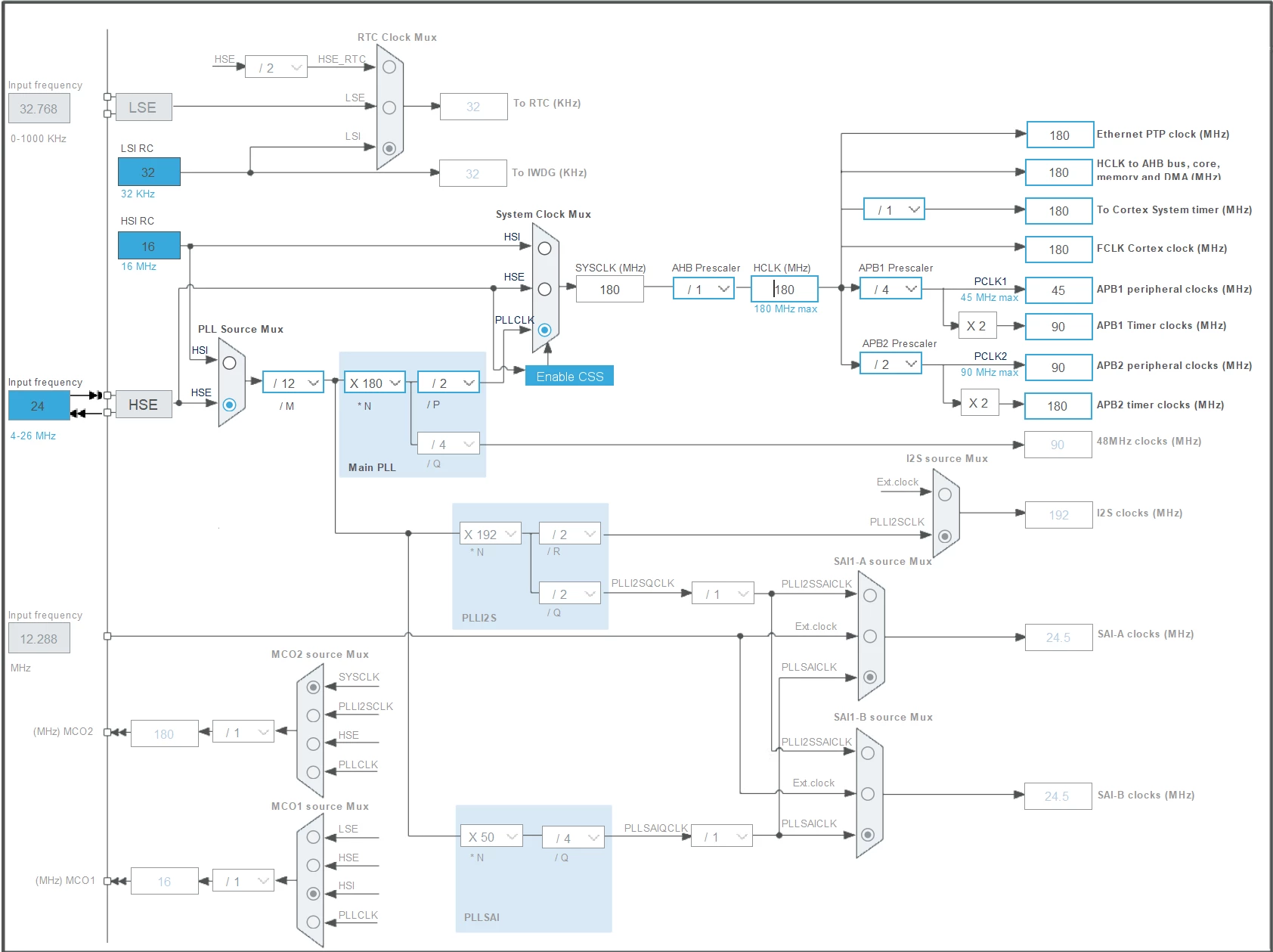

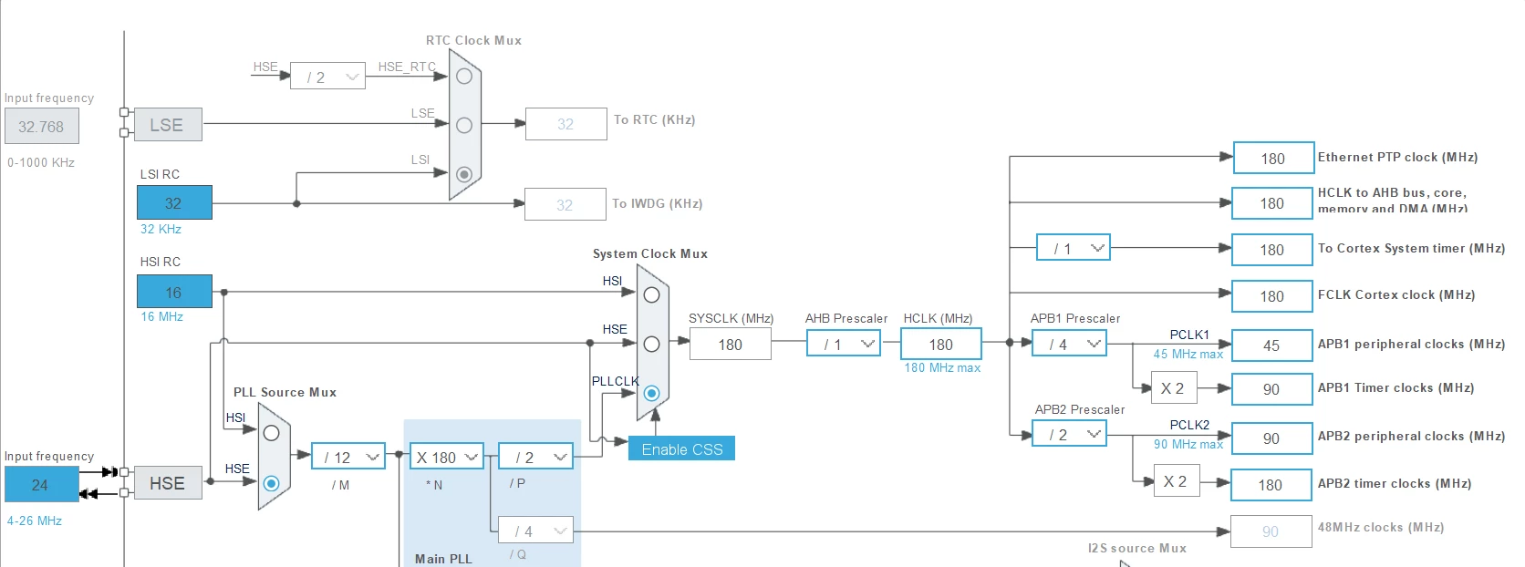

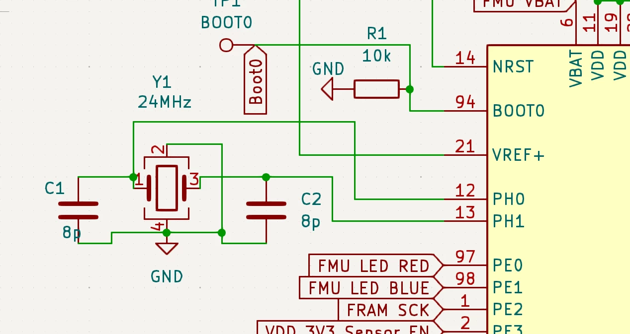

I have designed my PCB with stm32f427VIT6 and a 24Mhz crystal oscillator. I was trying to upload and test the normal blink code and it's not working. If I disable the external clock, the LED works and does not work with an external clock. I am completely new to STM, I did not know exactly whether I messed up with the design or could not configure the clock properly. I am attaching the schematics of my connection and a screenshot of the clock configuration that I have tried. Kindly help me :)
oscillator circuits are delicate and need to be layed out with care. Can you post a screenshot of how you laid out the crystal and capacitors in your PCB near the MCU chip? How did you choose the 8pf capacitors?

Have you tried using the debugger to see exactly where it fails with the external clock ?
When you used the internal clock, did you still have the SYSCLK at 180 MHz ?

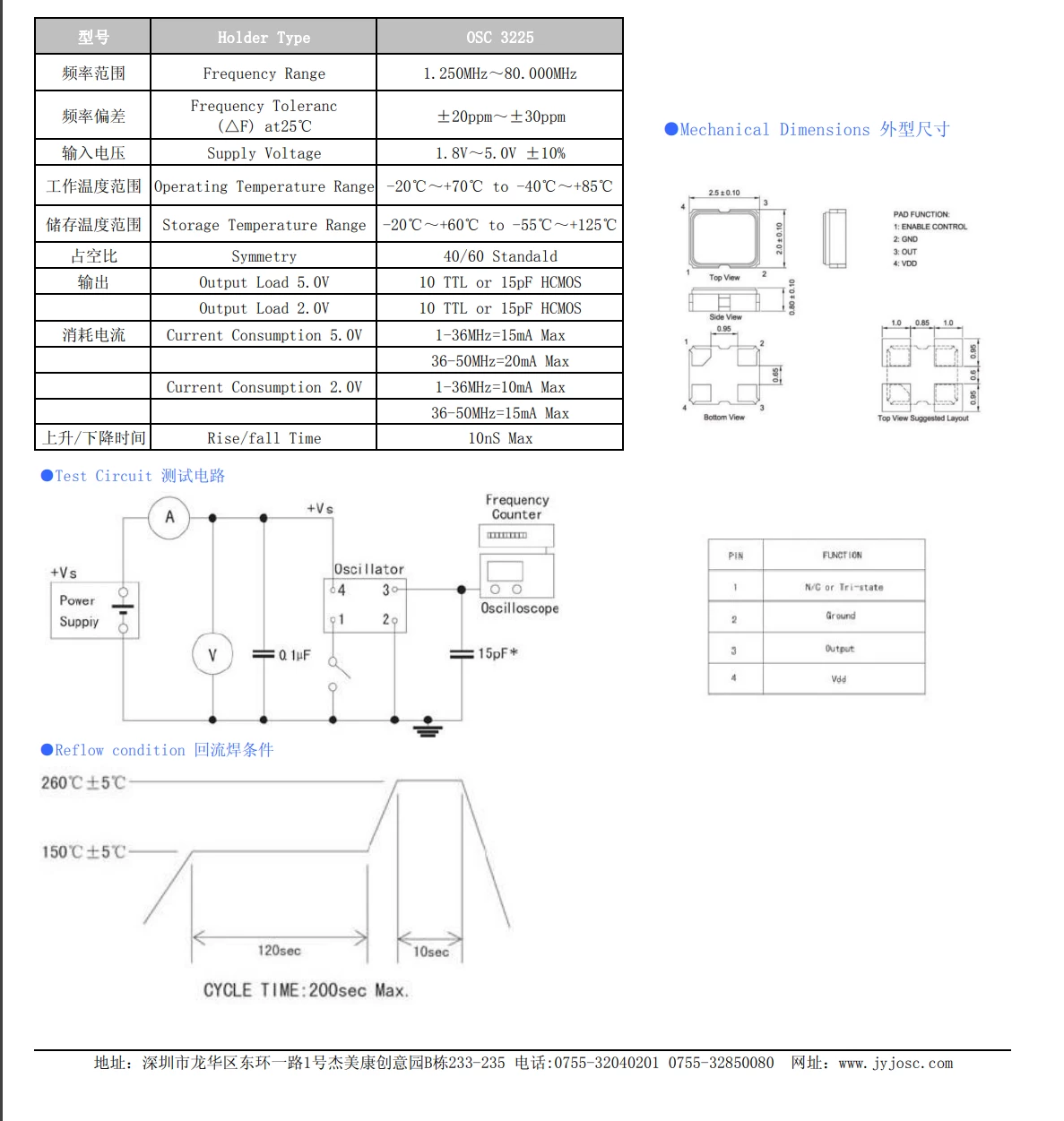

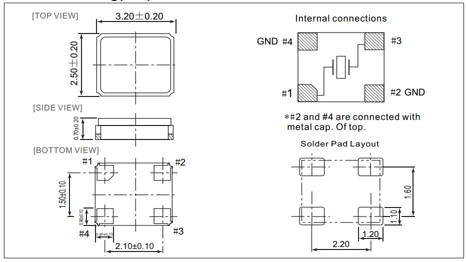

Hii.., Thank you for your reply. I have found the issue. the issue was with the oscillator only where I used the wrong one. the pinouts for the oscillator I used are different from the circuit I made. replacing the oscillator would solve the issue.
Andrew Neil
Jun 28, 2024 9:13 AM UTC
One of those is an actual, active oscillator;  the other is just a passive crystal !
The circuit you showed is designed for the passive crystal.
See:
https://community.st.com/t5/stm32-mcus-products/stm32f4-osc-problem/m-p/664136/highlight/true#M241592

Probably stuck and died in Error_Handler() perhaps have that flag one of your LEDs, or use the debugger.
Have code starting the HSE fail more elegantly when the crystal doesn't start.
Tesla DeLorean
Guru
Jun 27, 2024 1:13 PM UTC
Check the code in SystemClock_Config() using HAL_RCC_OscConfig(), perhaps add code to alternatively use HSI (16 MHz) + PLL to get the operational speed you want in case HSE fails to start.
Then debug the component choices / loading of the HSE, that precludes it starting, or start sufficiently quickly.
