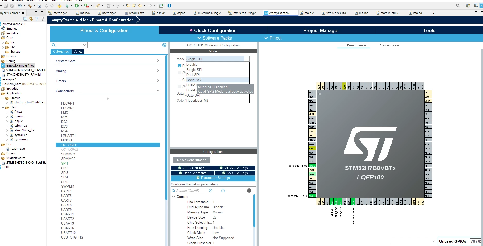

Hi EveryOne,
                  I have made a custom board with STM32H7B0 and  W25Q128 . where W25Q128 has to hold the user application . I hoped that i can change OSPI in STM32H7B0  to a QSPI config and work with W25Q128  ( which will only work with SPI or Qspi) . I can't able to select QSPI config ( which is mentioned as it is already activated ) in Octal SPI parameters . i'm using  firmware version :FW H7 1.12.1
 since this is a personal one i can't change the  W25Q128 to another OSPI supported flash memory  IC. Is there any example or any other way to make   W25Q128 (changing OSPI to single SPI or using any one SPI communication)  as a external memory to hold user application for  STM32H7B0.

Hello @Yuvaraj
The issue you are encountering with selecting the QSPI mode configuration in CubeMX is a known CubeMX defect. This has already been reported in the community, and an internal ticket (number 213708) has been created to track and resolve this issue.
In the meantime, you can configure the external flash interface to operate in single SPI mode to hold your user application, although with potentially reduced throughput compared to QSPI.
