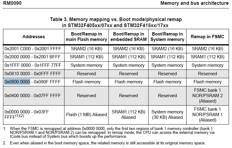

EWARM St-Link debug of STM32F4 Discovery board not using .intvec
Posted on June 17, 2014 at 23:59
The PC is always pointing to 0x08000188 (after the .intvec allotment )
So as a workaround I put a B <label> there. The label value is incorrect.
This is not using the flash loader. If I use it it fails citing writes to the CCM area.
All the generic STM32F4 manual don't mention the 0x08000000 as even being in the memory map. And i can't set the intvec to flash load at 0x0.
Is there information about these issues anywhere?

    Not sure I fully understand the complaint. The PC never gets set to the bottom of memory, 0x08000188 is likely the ResetHandler address that the STM32 loads when it starts, ie SP @ +0, PC @ +4
    The memory that gets shadowed at zero will depend on the BOOTx pins. The address the image get built for is determined by the linker, and it's script or .ICF file.

    I agree with all you showed me here. Both boot jumpers are on. My ST-link download shows my intvec is located at 0x08000000. Yet it does not set the sp according to intvec+0 or set the pc to intvec+4. The pc starts at 0x08000188 ( right after the complete intvec ) The sp is unset.
    This is an asm only project, if that makes a difference.
    When I run in the simulator it does start up correctly.
