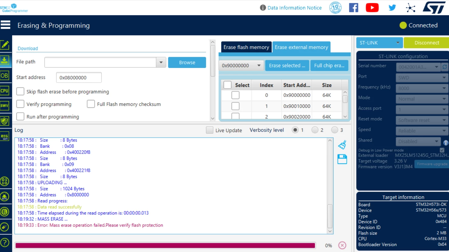

Error: Mass erase operation failed.Please verify flash protection stm32h5 board
I faced this while erasing external memory from programmer

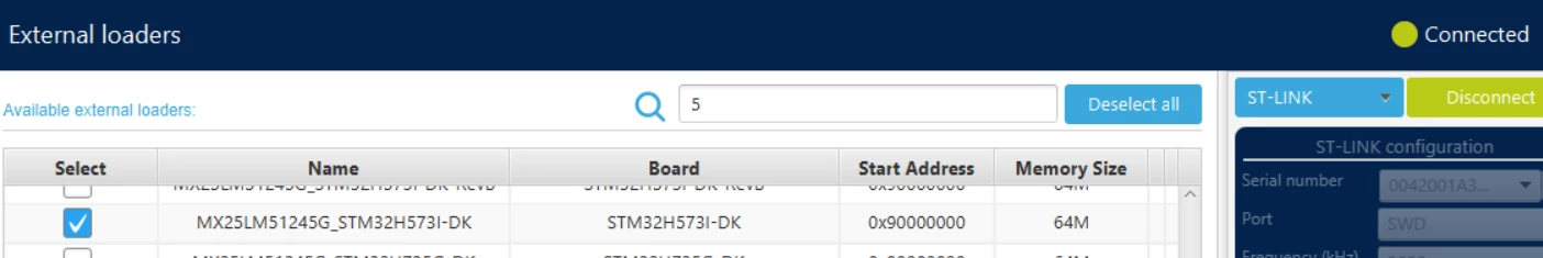

Please provide more detail of the exact board configuration, external memory, and external loader.
Provide logs from STM32 Cube Programmer, with Verbose Level 3

May 22, 2024
Here is screens and level 3 log file

Hello @Ahmed_hassan and welcome to the Community :),
Thank you @Tesla DeLorean  for your contribution in STComminty and for bringing issue to our attention.
Which board revision are you using?
If you have a STM32H573I-DK-RevA board , please use MX25LM51245G_STM32H573I-DK.
If you have other boards revisions like as RevB or RevC, please use MX25LM51245G_STM32H573I-DK-RevB.
Please let me know if the issue is solved or not?
Thank you.
Kaouthar
May 23, 2024
It works thank you for helping.
