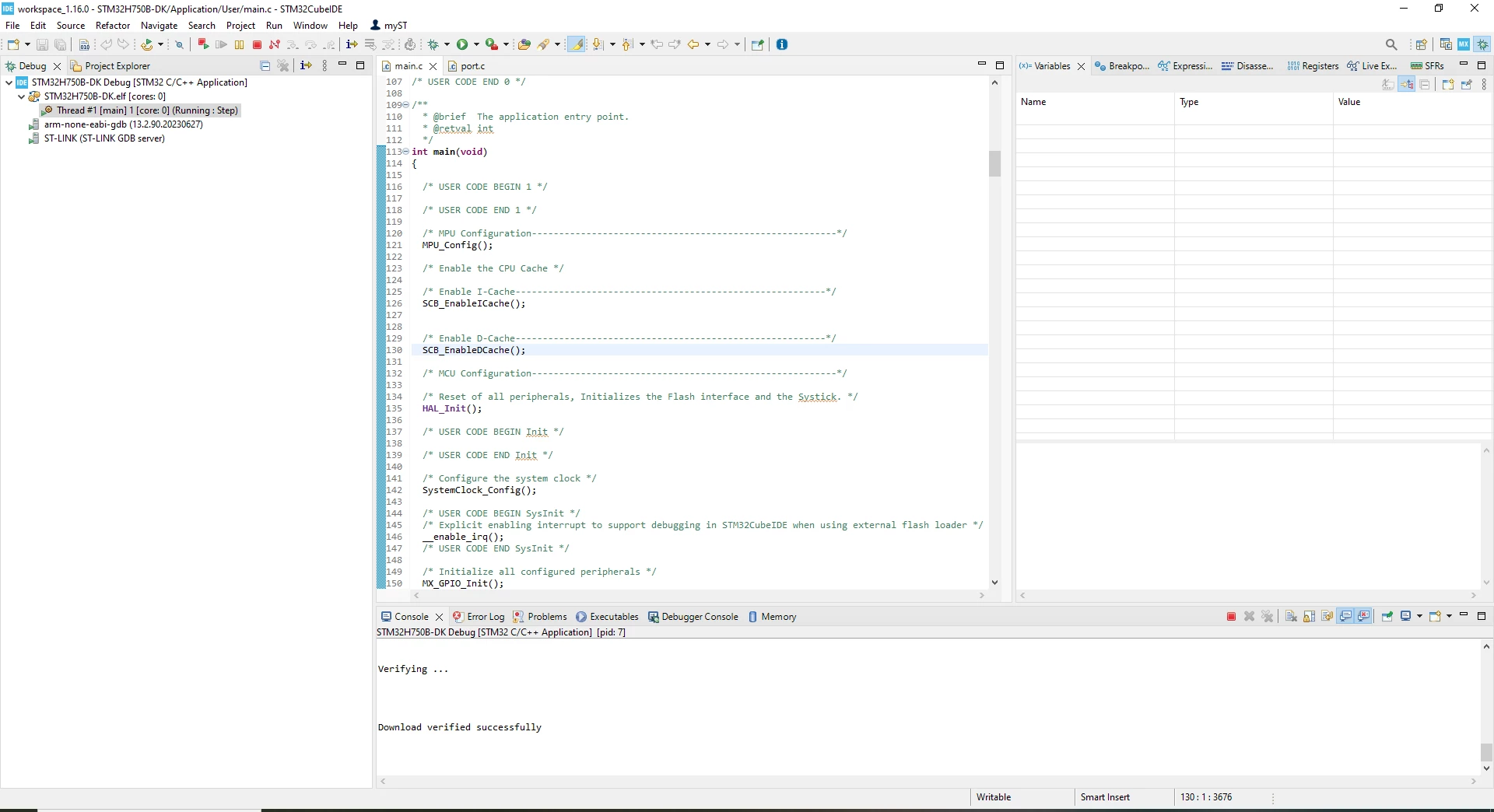

I'm using stm32H750B-DK and i'm trying to send a frame via LIN protocole every one second .
but when i run the code nothing happen .
when debugging i found that the code blocked in an endless loop in SCB_EnableDCache() function

Thank you for sharing your project but I didn't reproduce the issue and the application passed SCB_EnableDCache() step and I see this screen (stepped over SCB_EnableDCache():(
Your project is running well in debug and in standalone.
Try maybe to use the latest tools CubeMx/CubeIDE and clean/rebuild your project.

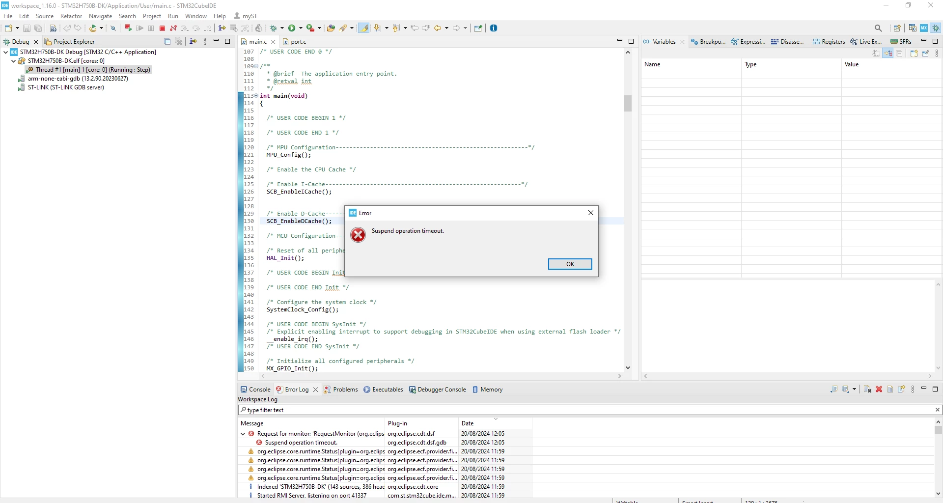

The problem isn't solved ,the code blocked in an endless loop in SCB_EnableDCache() function .And while debugging this is what happen

i tried toggling a LED and it worked fine and when debugging  the SCB_EnableDCache()  take a lot of time so i stepped into the function and debugg it manually and it worked . But when i connected a logic analyzer to see if the frame of the LIN protocole was transmitted there is nothing
August 20, 2024
I created a new project and i called the SCB_EnableDCache() function
and when i runned the code , the toggle works fine but when i debugg the SCB_EnableDCache() function takes a lot of time running . So when i stepped into the SCB_EnableDCache() function i found that it is working and decrementing its values but i didn't know why it takes a lot of time when debugging ?
Why are you stepping into SCB_EnableDCache()?

You didn't answer my question: Why are you stepping into SCB_EnableDCache()? There is no need for that. You need just to step over it (F6) not into it. And as I said your project is working well from my side.
August 21, 2024
When i step over it , it takes a lot of time running so i stepped into it to see what is the problem .
