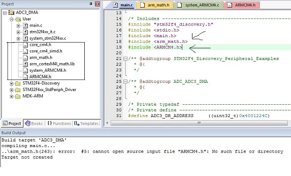

I need to use DSP libraries such as  BasicMathFunctions, but I have a lot of error messages, you might describe the procedure to include these libraries??
error messages like:
.. \ main.c (18): error: ♯ 5: can not open source input file ''ARMCM4.h'': No such file or directory

Posted on October 15, 2012 at 12:01
After my understanding, ARMCM4.h is a generic core include file from ARM.
Replace the reference with ''stm32f4xx.h'' (if you build for the M4), or add a version that includes this file.
See this for reference:
https://bitbucket.org/thweber/cmsis-v3/src/21d75dc52207/Device/ARM/ARMCM4/Include/ARMCM4.h

Posted on October 15, 2012 at 12:50
If you look at the contents of this ARMCM4.h, it defines just the same things as the stm32xxx.h files - only less. It is the ARM version for a generic M4 core, and thus should match the STM32F4xx, LPC45xx, LM4Fxxx and others.
I believe ST should have removed all references to this file before releasing the F4 firmware library, because their version (stm32f4xx.h) is a superset of this file.
If you build for an stm32f4, just remove the line
#include ''ARMCM4.h''
and replace it with
#include ''stm32f4xx.h''
or create your own version of ARMCM4.h, which only includes stm32f4xx.h.
I had built a project with some DSP lib files some weeks ago, and succeeded this way.
Edit:
Looking at your picture, you probably just need to remove the include.
The other file (''stm32f4xx.h'') should already be pulled in by former includes.

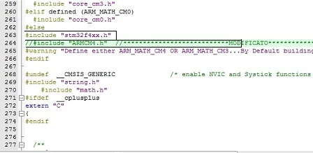

Posted on October 15, 2012 at 14:04
I tried to replace with ARMCM4.H STM32F4xx.h but I get many errors when I try to use the mathematical functions or control as the pid...

Posted on October 15, 2012 at 14:20
I tried to replace with ARMCM4.H STM32F4xx.h but I get many errors...
If the file stm32f4xx.h is already included, remove ARMCM4.h, i.e. the include.
''Invalid redeclaration ...'' is a typical error when including a header file twice.

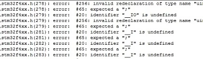

Posted on October 15, 2012 at 15:24
gives me error for all types defined as  __IO uint32_t
for example IO uint32_t  take me back to a mistake
but unit32_t don't return an error message...
I can not fix .... :( Help me....

Posted on October 15, 2012 at 16:04
You need to look at the first error, subsequent ones often come as a result if it trying to recover/restart.
The include file you want is in \Keil\ARM\Device\ARM\ARMCM4\Include
You NEED to ensure that you project has Include pathing set up correctly so that it can find the files requested.
Options -> C/C++ -> Include Paths

Posted on October 15, 2012 at 16:20
clive, as always, I thank you! :) I've included the file but I have new errors, I think there are conflicts, you may help me for this new problem?

Posted on October 15, 2012 at 16:41
system_armcm4.c and startup_armcm4.s are duplicative of files provided by ST, remove them from the project.
