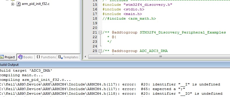

Posted on October 15, 2012 at 10:55
I need to use DSP libraries such as  BasicMathFunctions, but I have a lot of error messages, you might describe the procedure to include these libraries??
error messages like:
.. \ main.c (18): error: ♯ 5: can not open source input file ''ARMCM4.h'': No such file or directory

but mostly just add functions pid gives me these error ...
please give me a hand

Your file
arm_pid_init_f32.c
pulls in
arm_math.h
In
arm_math.h
, you find this:
#define __CMSIS_GENERIC              /* disable NVIC and Systick functions */
#if defined (ARM_MATH_CM4)
  #include ''core_cm4.h''
#elif defined (ARM_MATH_CM3)
  #include ''core_cm3.h''
#elif defined (ARM_MATH_CM0)
  #include ''core_cm0.h''
#else
#include ''ARMCM4.h''
#warning ''Define either ARM_MATH_CM4 OR ARM_MATH_CM3...By Default building on ARM_MATH_CM4.....''
#endif
So, just add the define ARM_MATH_CM4 to your project settings.
The file
core_cm4.h
is coming with the DSP_Lib, so there shouldn't be a problem.
Tesla DeLorean
Guru
October 15, 2012
Posted on October 15, 2012 at 17:22
Do you have the define ARM_MATH_CM4 set for the project?

Your supposed to pull in the library file to your project (the .lib file), not the source for it. I presume you just want to use the functions within the library? If you want to compile the DSP library source you'll want to review the project files.

I just want to use the functions pid ...
how do I define the file ARM_MATH_CM4 in the project?
Tesla DeLorean
Guru
October 15, 2012
Posted on October 15, 2012 at 18:38
#define ARM_MATH_CM4
#include <arm_math.h>
or
Add it into the project
Settings -> C/C++ -> Preprocessor Symbols -> Define

I ''solved'' in this way:
#include ''stm32f4_discovery.h''
#include <
stdio.h
#include <
main.h
#include <
arm_math.h
#include <
arm_pid_reset_fc
#include <
arm_pid_init_fc
I do not know if it works, because it does not give me errors when it compiles, but crashes when microcontollore must perform operations on float ..... for example this operation blocksthe program:
A0 = Kp + Ki + Kd;
//where Ao, Ki, Kd and Kp are declared or float or float32_t
to operate on a float must include something? I do not understand why it crashes ...do you have any thoughts on this?? I know I am repetitive, but thanks and thanks again!!!!clive :D
Well there are a couple of things to review. Options -> Target ->Floating Point Hardware -> Use FPU Enabling the FPU in hardware Either in startup_stm32f4xx.s

To confine the problem step through the code to identify the failure point, or install a Hard Fault Handler which can assist you in identifying the instructions which are faulting. Joseph Yiu has published an example in his book, and on the forum.

I can now work with floats! :D I hope to solve the network pid, I'm looking at the examples of the DSP library! I'm trying to ''take'' my project in an example of the DSP Library, but I always have problems with header files STM32F4xx.he ARMCM4.h
if I find a solution I will place in the forum.
