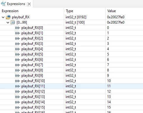

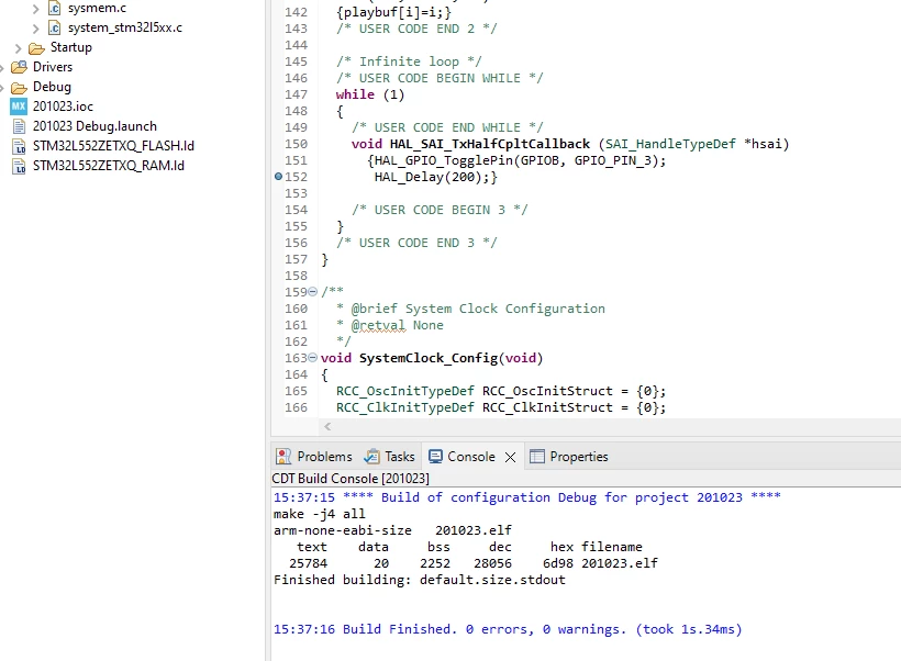

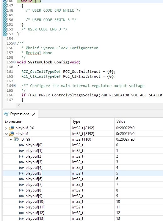

I would like to use DMA with SAI but I am having difficulty writing the code. Can you check if my code is correct and why I cannot retrieve the RX values ?
/* USER CODE BEGIN 2 */
HAL_SAI_RegisterCallback(&hsai_BlockA1, HAL_SAI_RX_HALFCOMPLETE_CB_ID, HAL_SAI_RxHalfCpltCallback);
HAL_SAI_RegisterCallback(&hsai_BlockA1, HAL_SAI_RX_COMPLETE_CB_ID, HAL_SAI_RxCpltCallback);
fresult= HAL_SAI_Init(&hsai_BlockA1);
if (fresult != HAL_OK)
return HAL_ERROR;
fresult = HAL_SAI_Receive_DMA(&hsai_BlockA1, (uint8_t *)playbuf_RX, (sizeof(playbuf_RX))/4);
HAL_SAI_RegisterCallback(&hsai_BlockB1, HAL_SAI_TX_HALFCOMPLETE_CB_ID, HAL_SAI_TxHalfCpltCallback);
HAL_SAI_RegisterCallback(&hsai_BlockB1, HAL_SAI_TX_COMPLETE_CB_ID, HAL_SAI_TxCpltCallback);
fresult= HAL_SAI_Init(&hsai_BlockB1);
return HAL_ERROR;
fresult = HAL_SAI_Transmit_DMA(&hsai_BlockB1, (uint8_t *)playbuf , (sizeof(playbuf))/4);

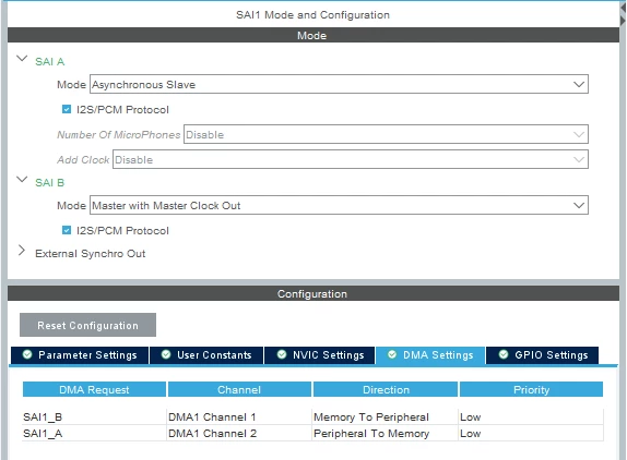

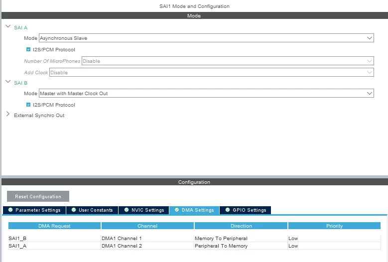

With CubeMX I have configured 2 DMAs.
One to send the data and the other to read the data again.

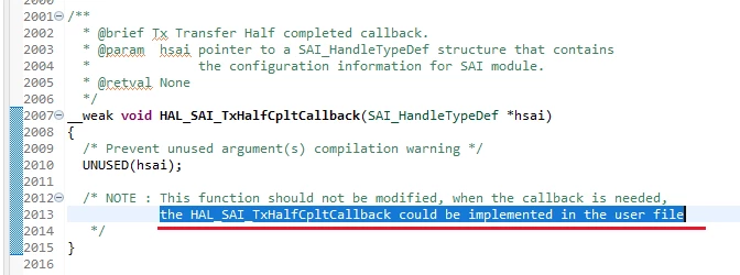

I think I'm missing something for the callback but I don't know how to use it to retrieve the values.
