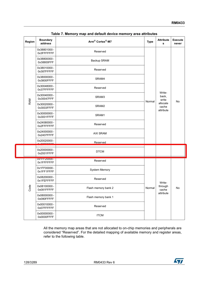

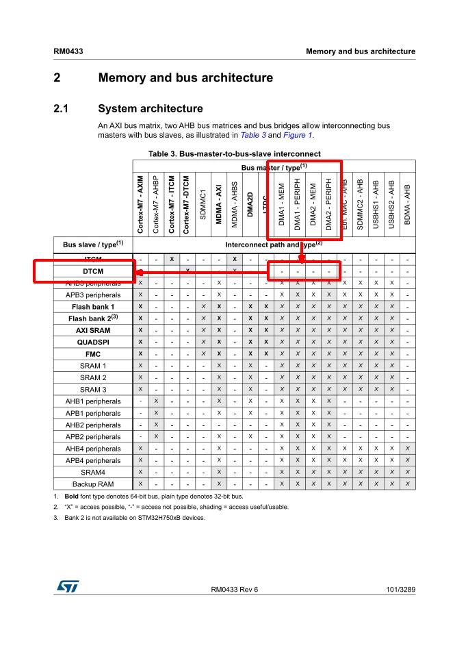

0x20009d84 is in DTCM
In 'H753, there's no route from DMA1/DMA2 to DTCM:
8 replies

 DMA2_Stream0 CR=0x0000001a NDTR=0x000003ff PAR=0x40022140 M0AR=0x20009d84 FCR=0x00000021
waclawek.jan
waclawek.janBest answer
Jul 16, 2024 3:30 PM UTC
dknipeAuthor
Jul 16, 2024 8:25 PM UTC
Thank you! I didn't even consider it was the memory region that was the problem. Creating the buffer on the HEAP resolved the issue.
