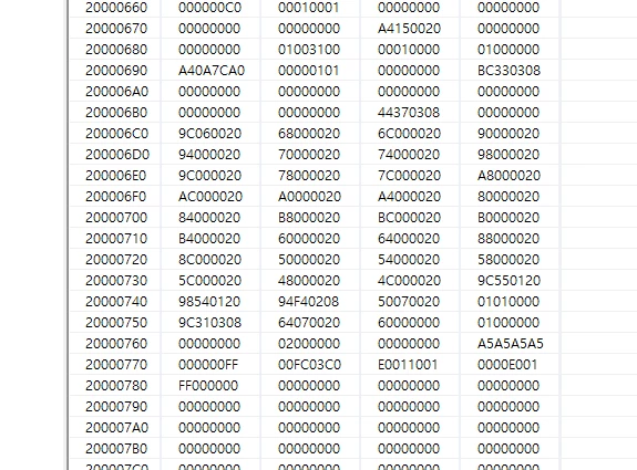

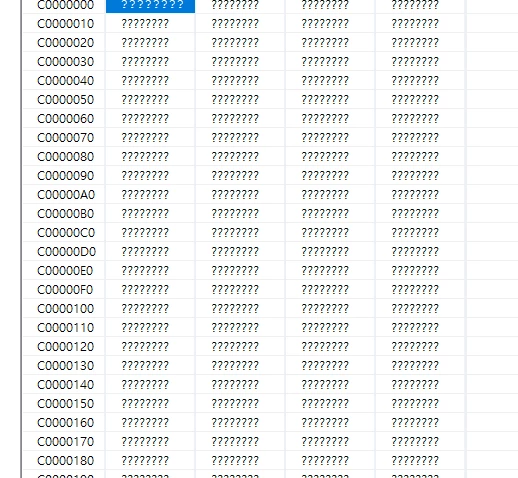

Additionally, after debugging and inspecting the memory, I can see the values written to the internal RAM, but I cannot see any values written to the SDRAM.

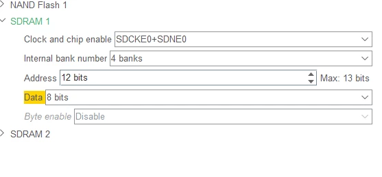

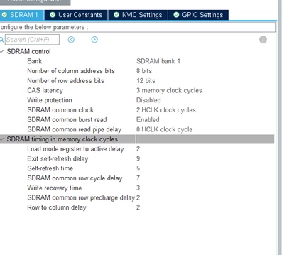

The SDRAM model I am using is the MT48LC4M32B2B5-6A_IT. I will attach an image showing the parameters I set in CubeMX.
To provide some details, the system clock is set to 216MHz, and the data width is 8 bits because the environment only supports an 8-bit configuration. The CAS Latency is set to the maximum performance of the SDRAM, and the SDRAM common clock is set to 2, resulting in 216/2 = 108MHz, which I intended to ensure would not cause issues.
At 108MHz -> 9.26ns
  • tMRD = 12ns / 9.26ns = 1.29 -> 2 clock cycles
  • tXSR = tRFC + tRP = 78ns / 9.26ns = 8.42 -> 9 clock cycles
  • tRAS = 42ns / 9.26ns = 4.54 -> 5 clock cycles
  • tRC = 60ns / 9.26ns = 6.48 -> 7 clock cycles
  • tWR = 12ns / 9.26ns = 1.3 -> 2 clock cycles
  • tRP = 18ns / 9.26ns = 1.94 -> 2 clock cycles
  • tRCD = 18ns / 9.26ns = 1.94 -> 2 clock cycles
I have configured the settings accordingly.
