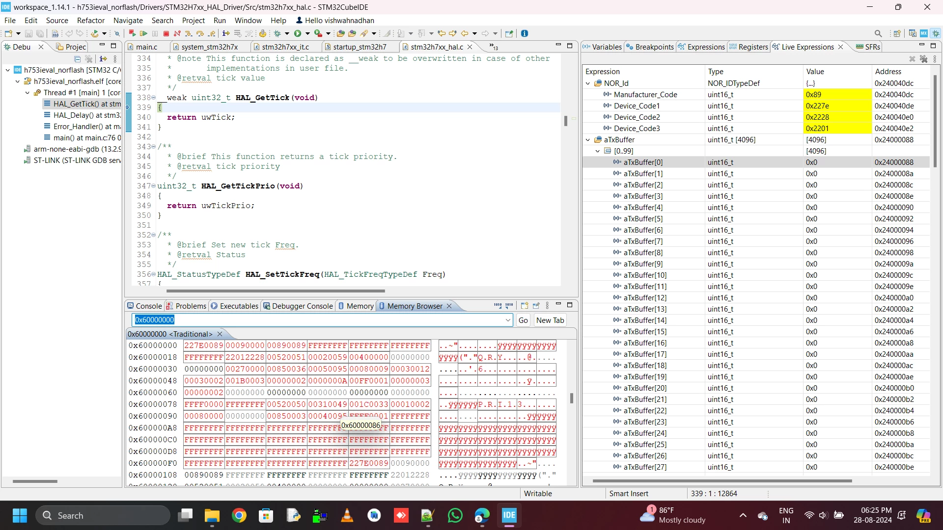

HI,
For testing and debugging FMC_norflash(MT28EW01aba) with custom h753 board, I used h743i-eval example as it is for read,write,erase, hence, i could read Manufactring code in memory browser, but in live expression i see address is different, so, where should i check for proper tx and rx data to be match.

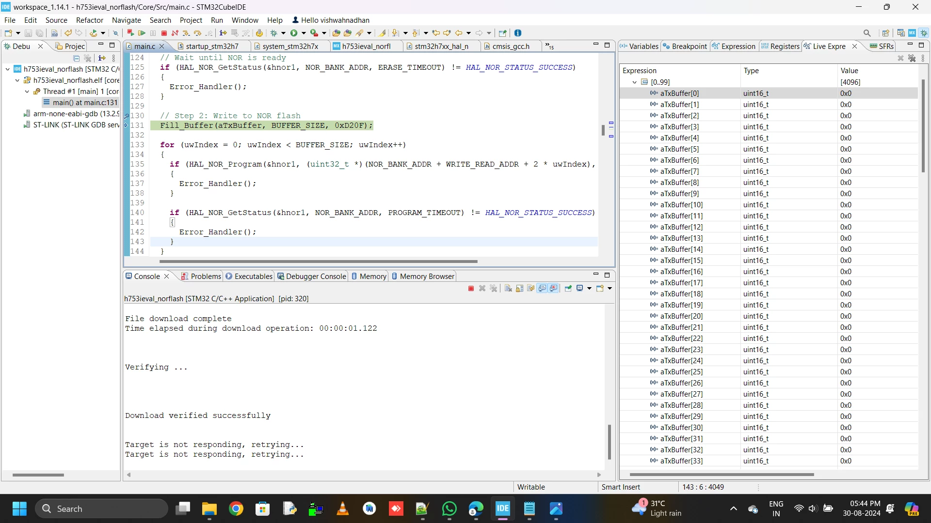

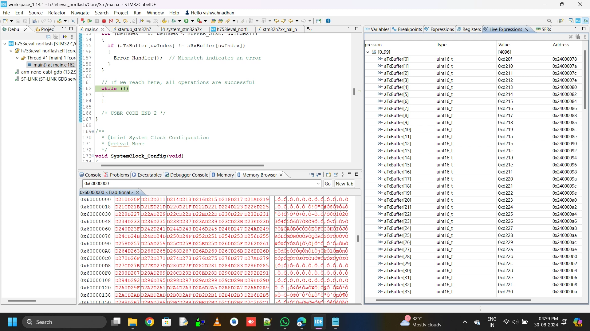

Thank you for guiding me on how to post code. I wanted to provide you with an update. I was able to see the TX buffer and RX buffer data at the address 0x60000000. I believe this indicates that I am successfully writing and reading data from the NOR flash.

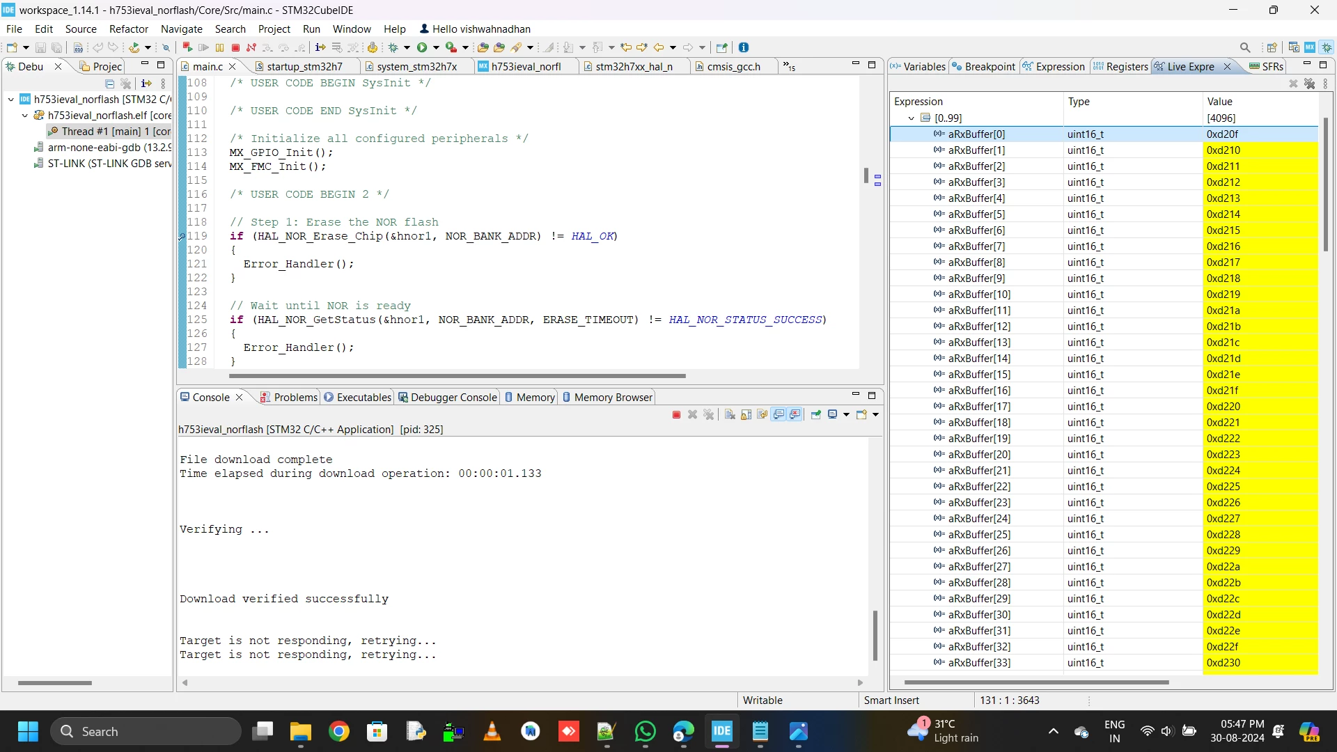

I set breakpoints before the erase, write, and read operations. When I reached the erase function, I saw 0xFFFFFFFF, and I observed data in the TX and RX buffers. Could you please confirm if this indicates that the NOR flash is functioning correctly? This is my first time working with NOR flash and FMC, so I want to make sure everything is as expected.
I also have a few questions:
  1. TX and RX Buffer Addresses: Why are the addresses of the TX and RX buffers showing as 0x24000078?
  2. Target Not Responding: I'm encountering an error that says "target not responding" when I place a breakpoint at the Erase_Chip function. Could you please help me understand why this might be happening?
  3. next how to take this for creating external loader to combine with my touchgfx project.?
I’ve attached all relevant images and code for your reference.Thank you for your assistance!
Tends to be indicative that you've crash the core, or it's stalling with wait-states trying to access a memory that isn't responding, or timeout is longer than the debugger is willing to wait around.
