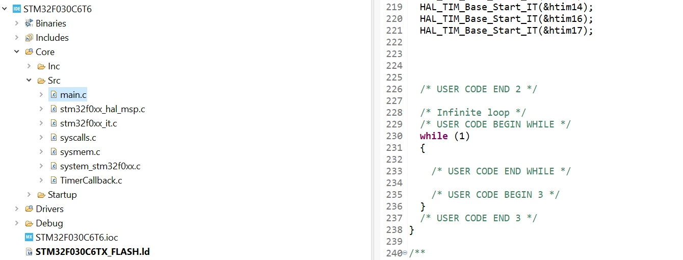

You uploaded the wrong project. It doesn't have the TimerCallback files.

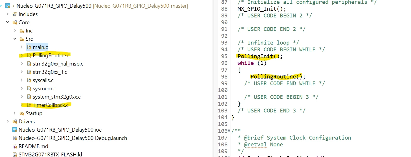

Your project still looks the same. Your while loop is empty so not much is going to work.
Your project tree should look like this

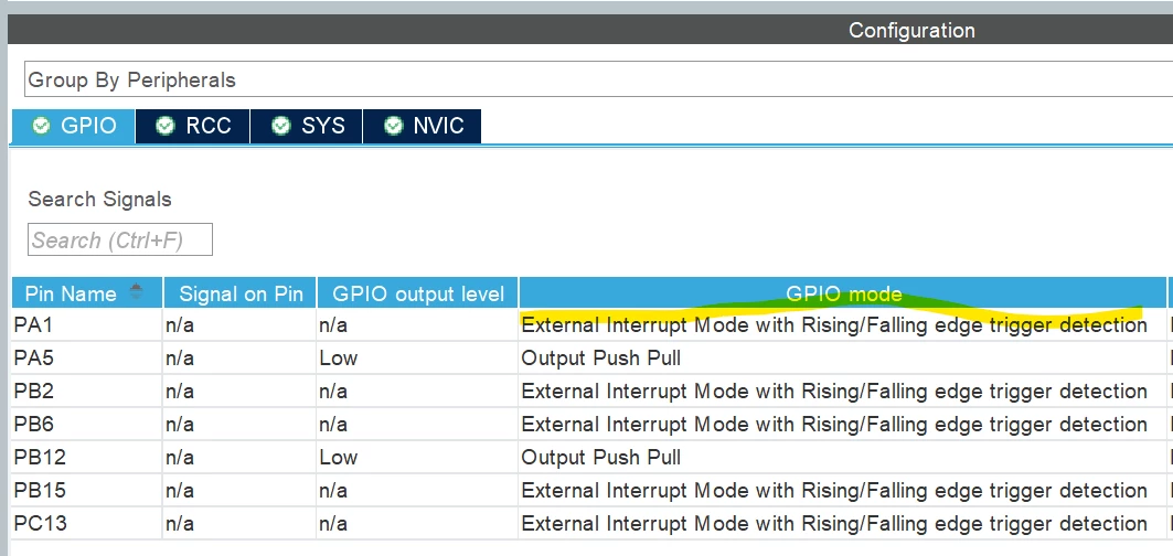

You don't have GPIO set up correctly for the ones that use EXTI. Only the pins that you are polling use Input mode.
I highlighted from my IOC what it should be like.
The TimerCallback.c/h and PollingRoutine.c/h just drop in your project. The only thing you need to do is change the GPIO names i've used to the name you used.
If a reply has proven helpful, click on Accept as Solution so that it'll show at top of the post.CAN Jammer an open source CAN bus hacking toolCANableV3 Open Source
