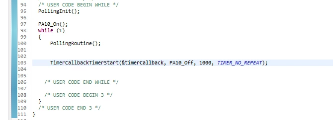

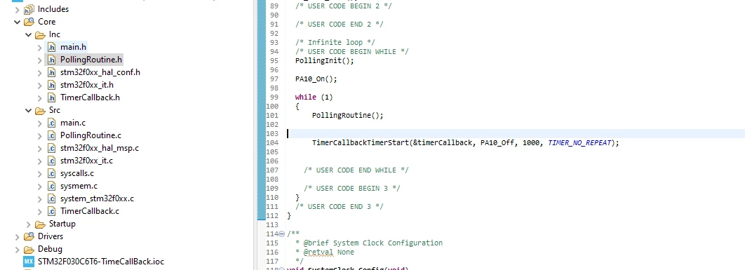

I've attached a project that uses your STM32F030C6 that compiles with no errors.
If a reply has proven helpful, click on Accept as Solution so that it'll show at top of the post.CAN Jammer an open source CAN bus hacking toolCANableV3 Open Source
XooMAuthor
Nov 18, 2024 8:39 AM UTC
PA10_off does not work after 1sec. PA10 "1" is always
It should be "0" after 1sec but timercallback does not work.
Karl Yamashita
Nov 18, 2024 4:12 PM UTC
It's because you keep calling it in a while loop. Each time you call it, it resets the callback timer.
Look at my signature and watch the video
XooMAuthor
Nov 18, 2024 9:40 AM UTC
If the PA10_off function was used after 1 second, it would be something to look for..
My aim was to make a PAx? that was active anywhere in my project passive after a period of 100 200 500ms... but it doesn't work.
