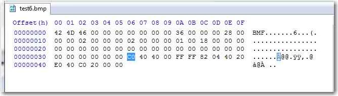

    I have test6.bmp which is 2x2 pixel 24 bits:
    Is offset 0x36 which value = 0xC0 equal to coordinate 0,0 (red color) ?
    Red color is defined from 0x36 until 0x38 ? ==> 0xC0,0x40,0x40, then (0,1)
    green color 0x00,0xFF,0xFF, then (1,0),blue color = 0x82,0x04,0x40,then (1,1) yellow color =
    0x20, 0xE0,0x40
    and then following :

    Am I on the right calculation and way of thinking ?
    thanks
    antonius
    antoniusAuthor
    April 22, 2014
    Posted on April 22, 2014 at 02:30
    Does it always begin from offset 0x3E on the file no matter the resolution of the picture ?
    It's the same for 1bit,8bits,16bits and 24bits picture ? I can see from every pictures, it's started from 0x36, reference :
    Start of pixel array (bitmap data)
    36h 3
    00 00 FF
    0 0 255 Red, Pixel (0,1)
    http://en.wikipedia.org/wiki/BMP_file_format#Bitmap_file_header
    Thanks

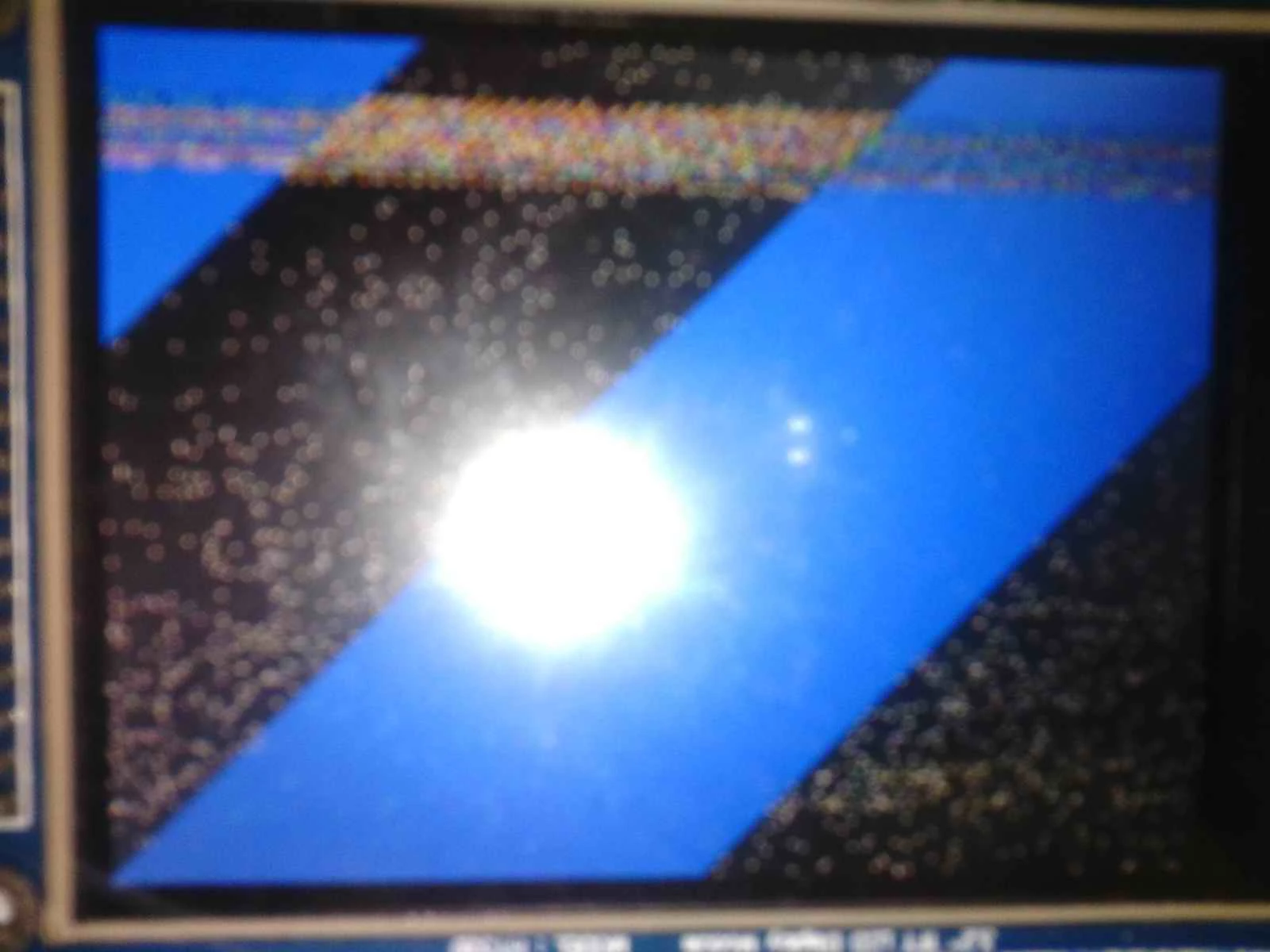

    I tried this code :
    //262K picture

    for displaying :
    http://iphotobucket.com/albums/p231/picture_77/test32_zpsa24eb6e1.png
    but it's displaying :
    http://iphotobucket.com/albums/p231/picture_77/IMG_20140427_095513_zpsd8864b8e.jpg
    Does anyone have a clue ? thanks
    Tesla DeLorean
    Guru
    April 27, 2014
    Posted on April 27, 2014 at 18:40
    Yes, the logic there seems rather broken, and the PNG won't be handled by BMP code

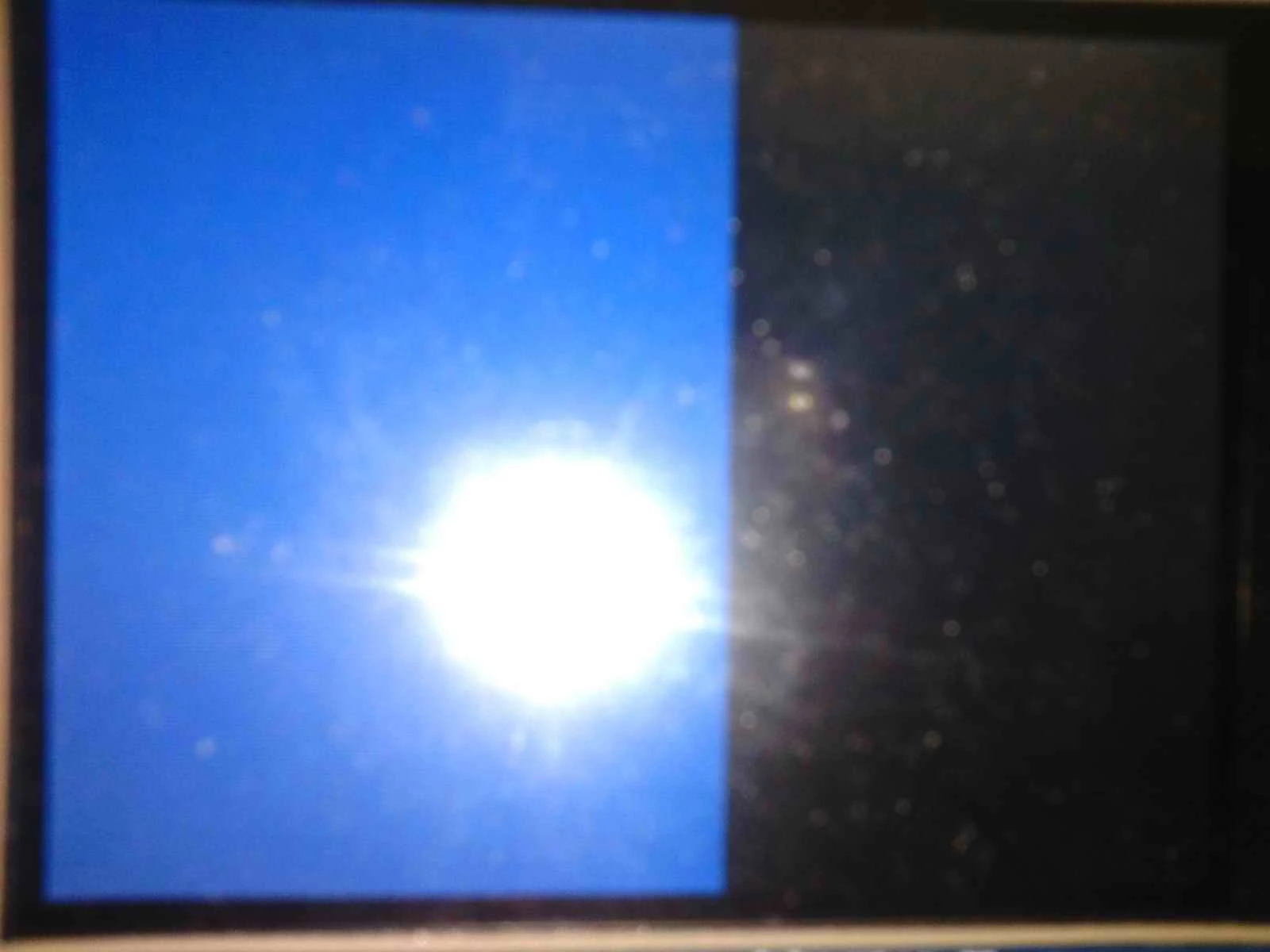

    I was trying to display
    0690X00000602dMQAQ.jpg but I got like this on LCD : 0690X00000602uPQAQ.jpg The code I used :

    Any clues ? thanks

    antonius
    antoniusAuthor
    April 28, 2014
    Posted on April 28, 2014 at 14:38
    It does the task but why can't I see the white color ? suppose to be blue and white,
    but on LCD blue and dot dot white not complete white ? Have a look...
    Thanks
    Tesla DeLorean
    Guru
    April 28, 2014
    Posted on April 28, 2014 at 15:31
    I'd look at the BMP, but the JPG/PNG provided so far are not usable by me, attach the real BMP to your post as an attachment.
