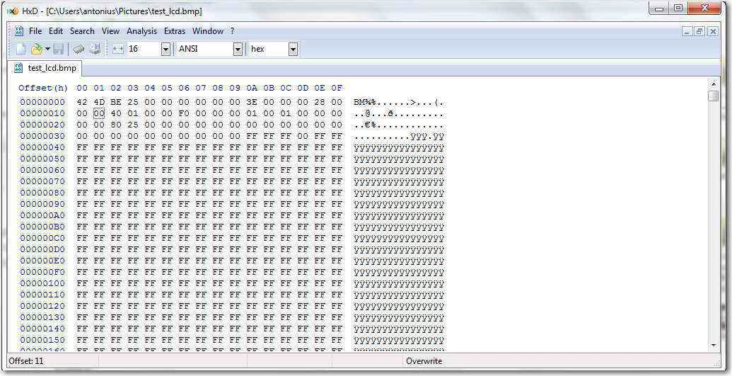

    antonius
    antoniusAuthor
    April 12, 2014
    Posted on April 12, 2014 at 03:26
    Tesla DeLorean
    Guru
    April 12, 2014
    Posted on April 12, 2014 at 14:13
    The picture data begins are 0x3E (62)
    You'd need to decode the bit stream, describing each line, into a pixel format suitable for your display. It's a monochrome image, black/white going by the RGB palette.

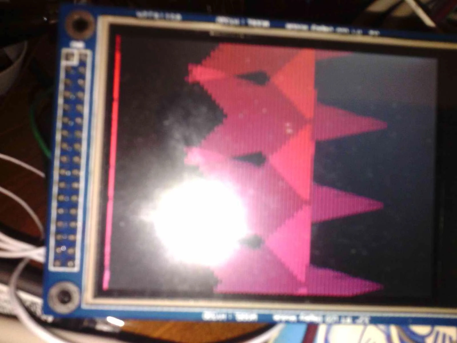

    antonius
    antoniusAuthor
    April 17, 2014
    Posted on April 17, 2014 at 06:45
    I modify a little bit,
    f_seek(&fsrc, 0x3E, F_SEEK_SET); // Seek to the data <== I can't find SEEK_SET so I commented out, It can display bmp but smaller and 4 times, do I miss something in the loop ? suppose to be : 0690X00000602Q0QAI.bmp I got : 0690X00000602tHQAQ.jpg
    LCD_SetCursor(0,0);
    res = f_open(&fsrc, ''test1.bmp'', FA_READ);
    //f_seek(&fsrc, 0x3E, F_SEEK_SET); // Seek to the data
    //f_lseek(&fsrc, 0x0A);
    for(y=0; y<320; y++)
    for(x=0; x<240; x+=2) // advance 8 pixels (one byte of bits)
    uint8_t b;
    UINT bytesread;
    f_read(&fsrc, &b, 1, &bytesread); // Read byte
    for(i=0; i<8; i++) // Process bits in byte, MSB first
    if (b & 0x80) // Pixel On?
    LCD_SetPoint(x+1, y, 0x0000); // Colour
    else
    LCD_SetPoint(x+i, y, 0xF0F0); // Black
    b <<= 1;
    } // x
    } // y
    f_close(&fsrc);
    thanks

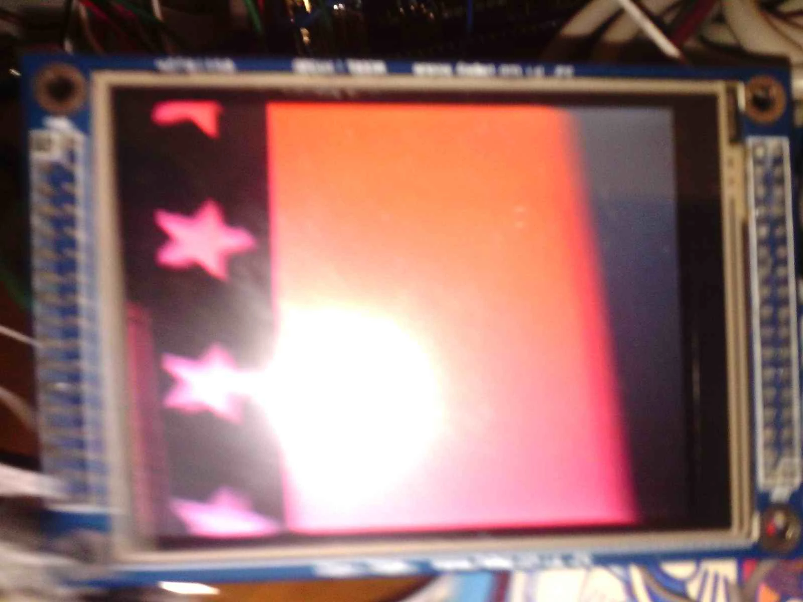

    antonius
    antoniusAuthor
    April 17, 2014
    Posted on April 17, 2014 at 06:51
    if I used
    1.
    for
    (y=0; y<320; y++)
    2.
    3.
    for
    (x=0; x<240; x+=8)
    I got : 0690X00000602tMQAQ.jpg Do you have a clue ? thanks
