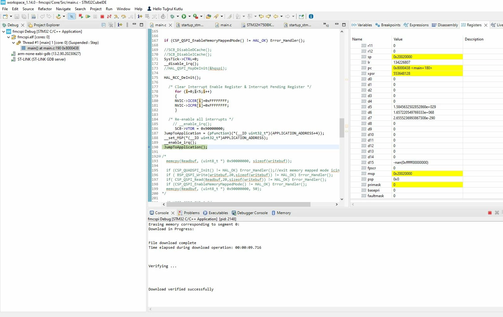

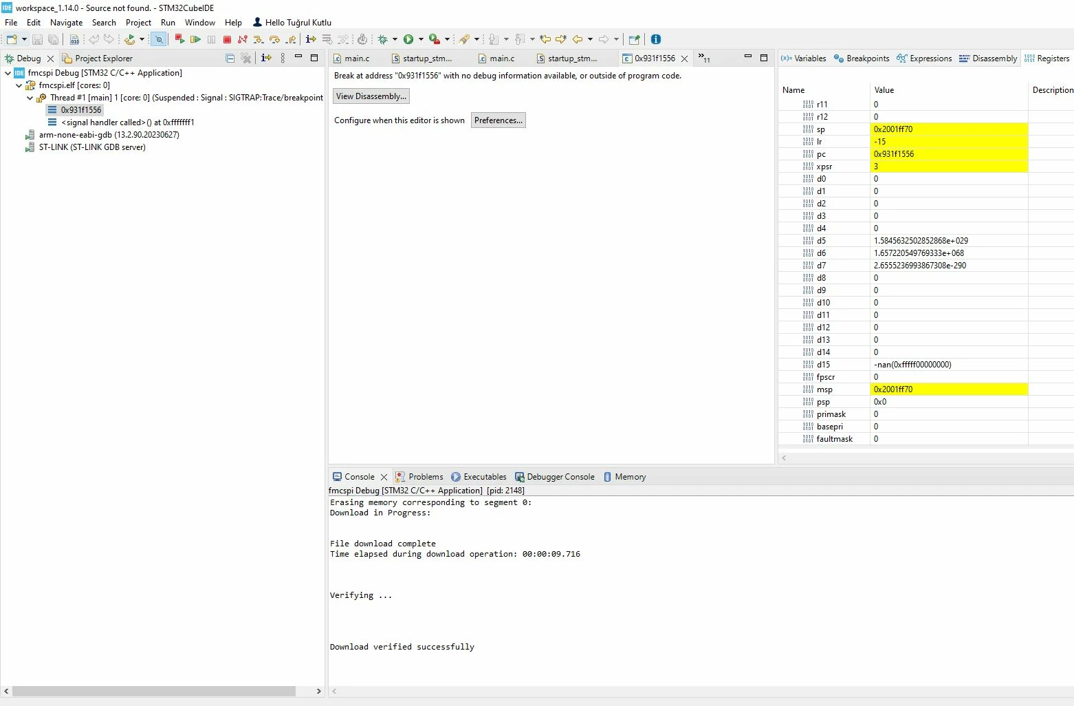

Actually it is sufficient if I can debug only my external application alone since the internal application or the bootloader just initializes the clock, QSPI and jumps to external application. But since I could not manage to debug it alone i decided to start from the internal application(bootloader)
Attached I am sending some files that show the status of the registers when starting a debug session from bootloader(the project name is fmcspi ), before jumping to the external application, after jumping to the external application  application jumps. I can see that the external application is running when I make a jump to external app but the debug session gives error that there is no debug information available. Please see attached pictures.

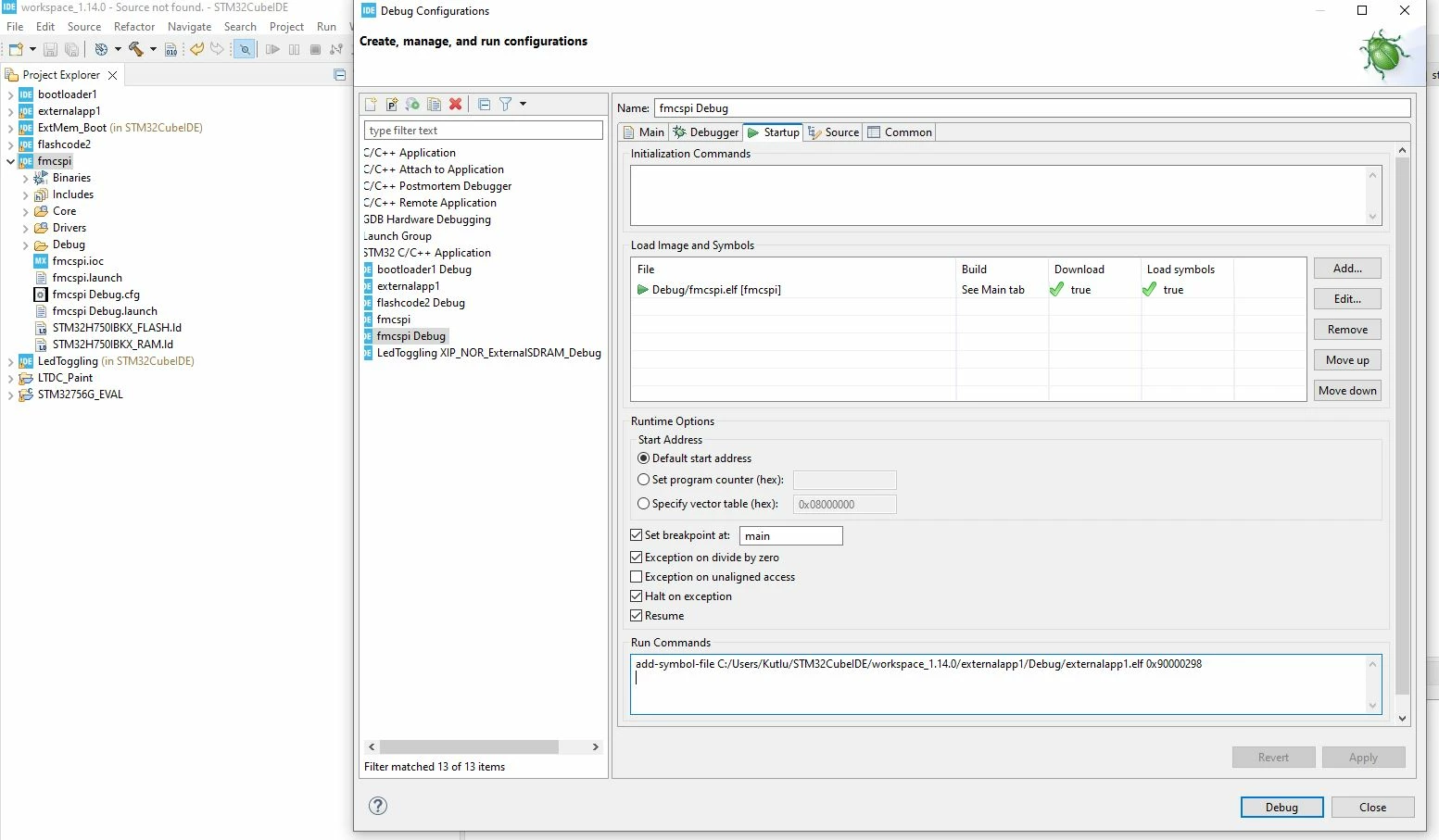

I have also attached my debug configuration for the loader.
As you have stated I have added the elf file of the external application to the debug configuration of the internal bootloader.

I compiled and flashed the real application elf file into the external qspi flash using an external loader and cube programmer.

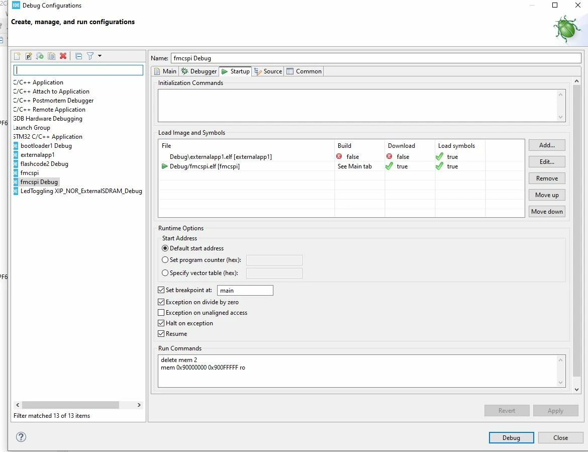

Then in the debug configuration of the bootloader application in Cube IDE, I have added the elf file file of the external application under the startup tab.(Please see the attached picture).I have only loaded the symbols.
Starting from bootloader in the internal flash i can jump to external app and single step through the code.
I was not able to set break points on the external app at first but when I added delete mem 2 and mem 0x90000000 0x90FFFFFF ro lines in the Run Commands window and I can set break points now.

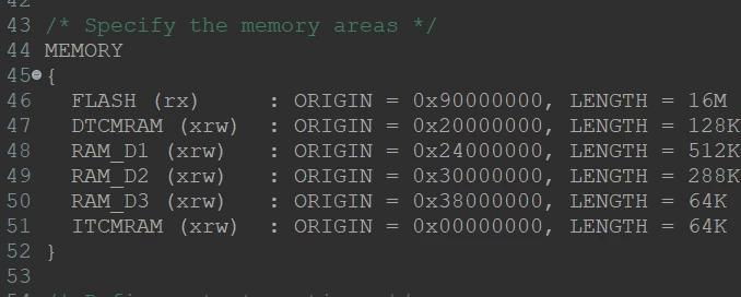

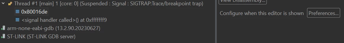

I use the same MCU and flash as yours. When I added the `delete mem 2` and `mem 0x90000000 0x90FFFFFF ro` in the run commands, the debug was blocked as below
The below is the ld configuration
May I know if you can debug the application on the external flash? If you can, may I know if any other configurations need to be set?
