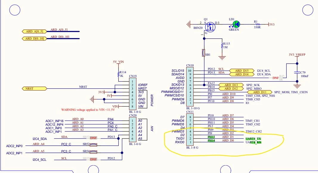

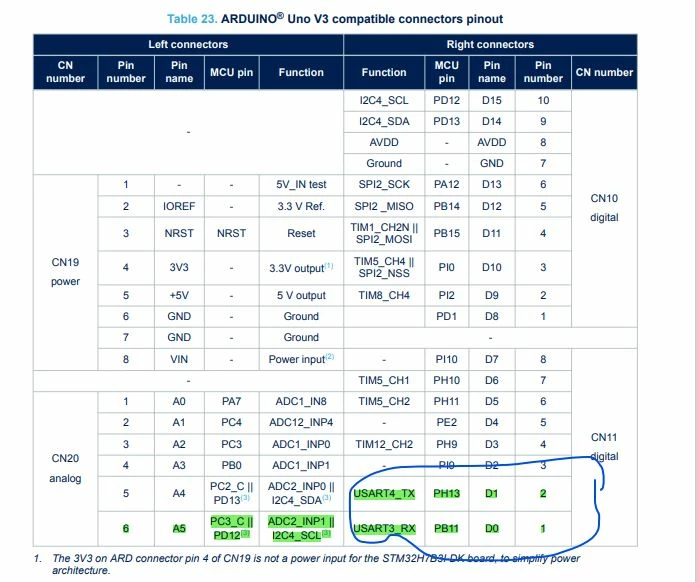

I am plannimng to connect the arduino and and STM32H7B3I-DK (MB1332B)
I see that in the document USART4_TX PH13 D1 and USART3_RX PB11 D0
I am getting confused how RX is on USART 3 and TX is on USART 4.
https://www.st.com/resource/en/user_manual/dm00610478-discovery-kit-with-stm32h7b3li-mcu-stmicroelectronics.pdf
some thing which i am not able to get it right in the document
I have attached the images that shows the that UART TX4 and UART RX4 has the pin PH13 and PH14.
https://www.st.com/content/ccc/resource/technical/layouts_and_diagrams/schematic_pack/group1/e0/e5/29/92/9d/37/47/91/MB1332-H7B3I-B02_Schematic/files/MB1332-H7B3I-B02_Schematic.PDF/jcr:content/translations/en.MB1332-H7B3I-B02_Schematic.PDF

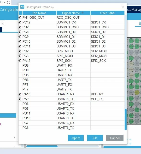

But when i tried to enable the code in the STM32IDE i see that the pins being used as
PB8 and PB9 for UART4
so how can i configure the UART pin in the code so i can use uart4 and receive the data

How is it conceivably going to work with PB8/PB9?
You're going to have to drive the user interface to select PH13/PH14 and associate them with UART4. These aren't my tools.
I thought we'd already established that the VCP used USART1 on PA9/PA10
>>I did not undertand what do you mean by pin/change in chip level
These aren't my tools, my expectation is you have to click on the chip pin diagram to select the PH13 pins and associate them with UART4, similarly disassociate the PB8/PB9, which I have no idea why it fixated on for this board.

Surely it is not that hard to figure out what's actually connected to what?
https://community.st.com/s/question/0D53W00000LdOOySAN/interfacing-stm32-and-arduino-uno-v3-shield
>>But when i tried to enable the code in the STM32IDE i see that the pins being used as PB8 and PB9 for UART4 so how can i configure the UART pin in the code so i can use uart4 and receive the data
That's presumably ONE choice for UART4, need to change at a pin/chip level

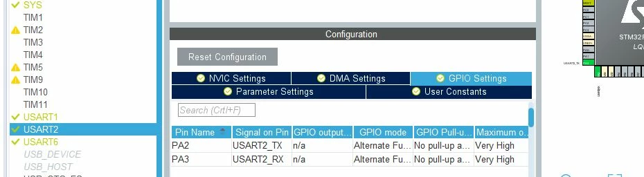

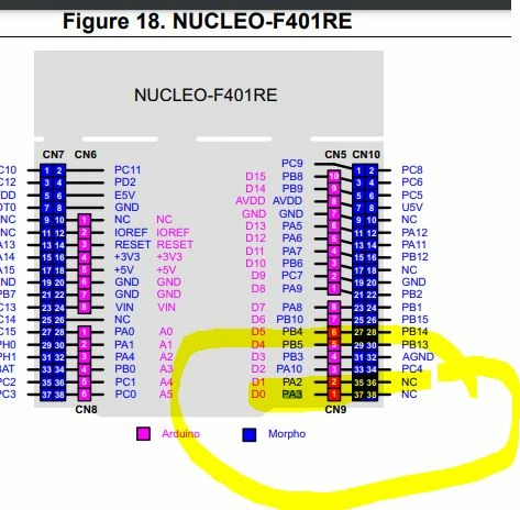

I have another board STM32F401RE
I see that the reference manual and the code has the same pins being used attached the screenshot
Thnak you

I'd be inclined to believe the schematic over the user's manual. Toggling the pin with GPIO and measuring should also provide your answer.

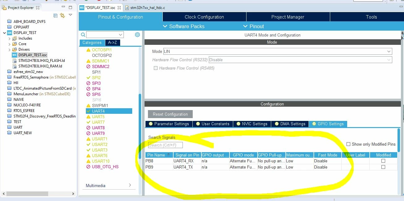

Change pins by selecting the pin you want in the pinout view and changing its function to what you want. In this case, select PH13 and set its mode to UART4_TX.

Can you please let me know
what chnages are needed for Toggling the pin with GPIO and measuring should also provide your answer ?
Is it like just make the connections and try something ?? can you pleas eprovide information more
how can i change the pinout view I see that following configurations are there to ph13 ad PH14
Attached the pin configurations
