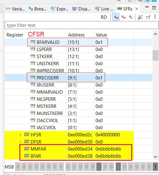

May 16, 2024
@waclawek.jan thanks!
I put breakpoint at start of hard fault handler, now I can check the registers when debugging.
What I see is what I saw earlier, when sometimes the saving of the registers in the hard fault handler worked:
CFSR:
BFARVALID and PRECISERR are set
BFAR and MMFAR hold the same value, this time it's 0x6B6B6B6B
This "address" seems to be a recurring pattern: it has always been this kind of four times alternating hex numbers (like 0x1D1D1D1D, or 0x23232323, or as above the 0x6B6B6B6B)
Does this make sense to anyone?
I thought with BFARVALID the address in BFAR would make sense
But where can I find what actually triggered the hard fault if the BFAR content does not make sense?

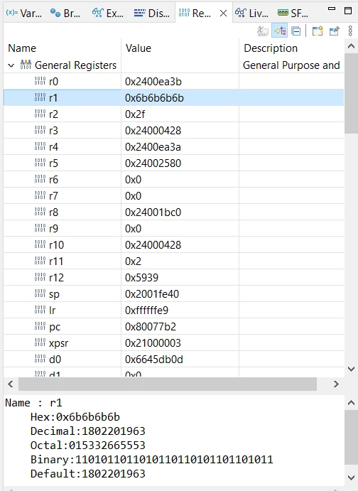

LCE
LCEAuthor
Principal III
May 16, 2024
Addition to the post above:
I find the BFAR value 0x6B6B6B6B also on the CPU register R1:
LCE
LCEAuthor
Principal III
May 16, 2024
Checking list / map files, some of the registers contain addresses pointing to some lwIP / http / SSI / CGI functions.
This could actually make some sense, because the client (PC browser) gets a self-refreshing html page to display update progress.
Getting closer...
