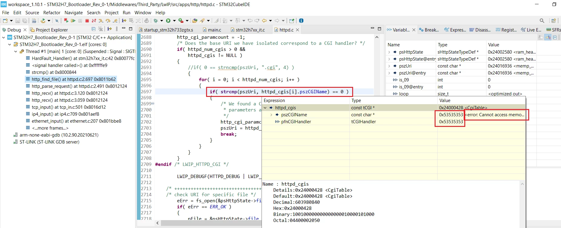

I hope and think I got it:
lwIP's httpd calls http_parse_request() calls http_find_file() which also checks the URI for CGI commands.
CGI application info is stored in a table containing 2 pointers for each entry, one to a constant string (like "/fileup.cgi") and the other to the respective function (called something like CGI_Handler_FileUp()).
These are constants stored in flash.
I check the contents and addresses of these at http server init and get these results, which make sense:
CGI HttpServerInit():
CgiTable[0].pszCGIName = /fileup.cgi @ 080239BC
CgiTable[1].pszCGIName = /admin.cgi @ 080239B1
When not working with the internal flash, these pointers seem to work well.
But when there's flash writing going on, these constants cannot be accessed, and somehow some weird value is assigned, see picture below.
And these are the values found in BFAR and MMAR (0x53535353).

Further info:
I trigger the flash programming, then let the STM32 do other stuff - which makes absolutely no sense, because this H7 canNOT do anything while flash is erased or programmed.
So I changed that to "blocking".
Now even with that, the SysTick seems to be crazy, which I use for a timeout check... SysTick okay, stoopid me...
BTW, in debug mode I was looking for the stack and stuff in the right top window, until I found it very comdortable on the left...

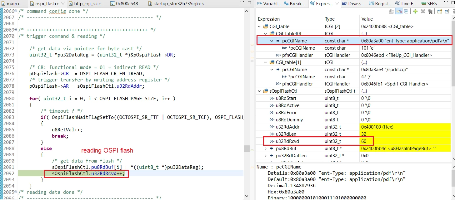

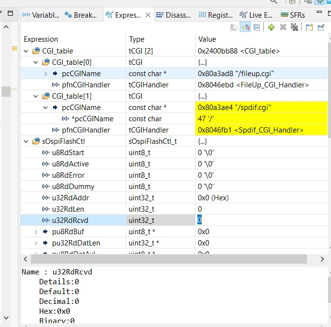

All of a sudden the compiler moved the variable CGI table to the start of AXI SRAM D1 - no more problems.
No matter what I tried, the compiler didn't move it anywhere else in further compilations.
But I still have the "application", which showed the same behavior when updating the bootloader.
And yes, the current app does the same:
It looks like the variable holding the CGI table pointers above gets reset while reading from OSPI flash, when the "bytes received counter" is incremented.
It looks like the pointer is moved to somewhere else, in this case to one of the http constants for pdfs...
Now I'd like to understand: how can this happen?
Picture 1: CGI table as it should be
Picture 2: CGI table changed by OSPI flash reading
waclawek.jan
May 17, 2024
This may be a case of runaway pointer which causes random places in RAM to be overwritten.
That's why I recommended to capture the moment when it's getting overwritten using data breakpoint (watchpoint).
However, note, that when using data breakpoints, execution does not stop exactly on the instruction which causes the access to watched variable/area, but a couple of instructions after that.
LCE
LCEAuthor
Principal II
May 17, 2024
@waclawek.jan thanks again...
How is that possible, any idea?
In this case, the CGI table is set / initialized at start, and then never written / set again.
I don't use any memory allocation - except for lwIP, which has it's own heap, and that is big enough for sure (checked with lwIP memory statistics, and confirmed by lots of troubles if it gets too small).
I now know how to solve this particular case, but I'd like to understand what's going on to prevent that in the future.
waclawek.jan
May 18, 2024
I put forth, I don't claim runaway pointer *is* the root of your problem (but it much sounds like that).
The causes of runaway pointer (or array index, which in C is the same) are many and may be very indirect. For example, accepting a pointer or index from "outside" of the program (e.g. from some data stored in external memory, which got damaged through hardware problem either with the memory or with transport paths; from communication with other system, etc.); bug in program using data from an area already reused (e.g. incorrectly used data from circular buffer already overwritten by other incoming data e.g. by DMA); bug in program stemming from atomicity-related issues (i.e. sharing nonatomic data between interrupt and "main", or  between threads in multitasking, which is the same). In other words, I can't pinpoint, but not even give you a clue, as for where the error stems from, as it may be very subtle and very much depends on everything (e.g. even timing) in your particular program and its surrounding environment.
Result of runaway pointer is damaged variable(s), but this variable has absolutely no relationship to the pointer which run away. So you can't/shouldn't investigate the ways how CGI table is intended to be set in your program. In other words, you should mentally abstract from your source, and think how the brutal (from Latin brūtus (“dull, ***”)) machine (the processor) works - it simply doesn't care about your source, variables, structures, etc.
That's why it's important to find the exact cause, not just cover up by a symptomatic patch.
