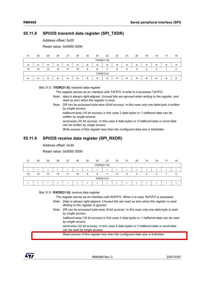

waclawek.jan
April 18, 2023
Oh, it's in the fine-print, indeed:
_legacyfs_online_stmicro_images_0693W00000biJezQAE.pngJW
Alefal
AlefalAuthor
April 18, 2023
STM32H757's reference manual is RM0399 (screenshot comes from RM0468).
Seems like they should add this line to the RM0399 too.
