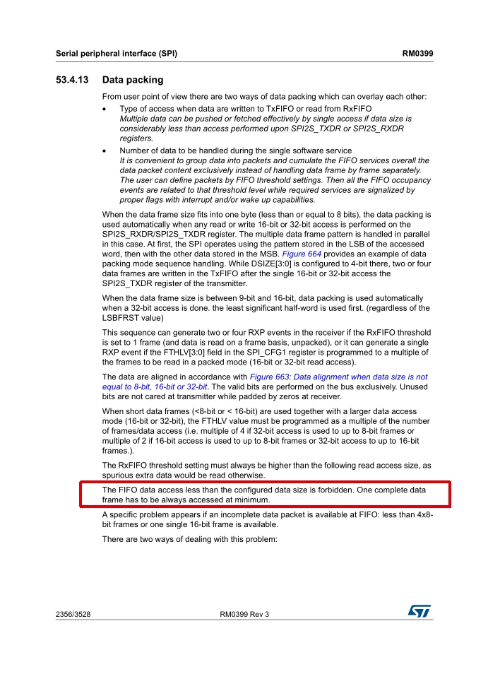

Moving from a audio effect prototype based on the STM32F407 to the STM32H757. Did a lot of stuff on the F4 with audio but on the H7 I'm getting stuck and can't get a simple audio loopback with DMA.
I'm using Cirrus Logic's CS5343 and CS4344 as external ADC/DAC connected to the I2S interface. I2S data frames are read and written in memory with DMA configured in circular RX/TX mode
Without DMA, audio loopback is OK. However, with DMA, the RX buffer isn't filled. The half complete and complete callbacks are triggered tho.
I'm aware that DMA can't access DTCM RAM and that with cache enabled, data coherency should be taken care of thanks to the MPU configuration and modification of the linker script :
MPU creates a region of 128kB device memory type (TEX : 0b000, not cacheable, bufferable, shareable)
RX and TX buffers (8kB each) subsections have been placed at 0x30010000 and 0x30012000 (SRAM1 in D2) in the linker script.
I tried to move the buffers in other RAM domains, make the MPU Region as shareable normal memory type but my Rx Buffer remains empty and/or doesn't update.
What I don't get is why my rx buffer isn't filled and updated by the DMA in the first place. If anyone got any clue or hints about what I'm missing, I'm all ears.

Maybe using 24 bit in I2S peripheral and half-word in DMA is not such a good idea?
In your I2S2_Init:
 hi2s2.Init.DataFormat = I2S_DATAFORMAT_24B;
DMA init:
hdma_spi2_tx.Init.PeriphDataAlignment = DMA_PDATAALIGN_HALFWORD;
hdma_spi2_tx.Init.MemDataAlignment = DMA_MDATAALIGN_HALFWORD;
I have both I2S and DMA set to 32 bit , that's working here on H723 / H735.

Humm, what a lucky choice of RM to find such a particular remark... 
Current RM0399 is rev.3 dated 27-Feb-2020, the remark probably appeared in some of the later revisions of RM0468 i.e. in 2021. All these while deeply in The Big Parts Shortage, so probably nobody complained yet. I guess a newer revision of RM0399 will contain it, but who knows when will such revision appear.
It's not uncommon that for newer informations or even errata you have to browse through other RMs, ST does not issue updated RM/ES regularly.
