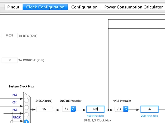

A new project with the button checked 'Initialize all peripherals with their default Mode'
will not find a solution if setting the clock to 400 MHz. Setting the dividers by hand works.
Solution: Uncheck USB_OTG_FS, because the clock solution process does not find a goal for 48 MHz.

    Joerg Wagner
    Senior III
    February 15, 2018
    Posted on February 15, 2018 at 22:17
    Hi.
    To reproduce #3 simpy follow this steps:
    - Open CubeMX 4.24 (or 4.23)
    - New Project
    - Choose Board, select Nucleo-H743ZI
    - Click on ''Start Project''
    - Choose
    - Then click the ''Clock Configuration'' tab and enter 400 MHz
    It hangs in an endless loop, no solution will be find.
    #4 was very hard to produce and did not appear in 4.24 anymore.
    #1: I disagree because it's fixed in CubeMX 4.24, see below in the code lines
    #2: Unfortunately still set to FREQ_LOW, see below in the code lines
