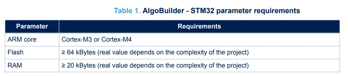

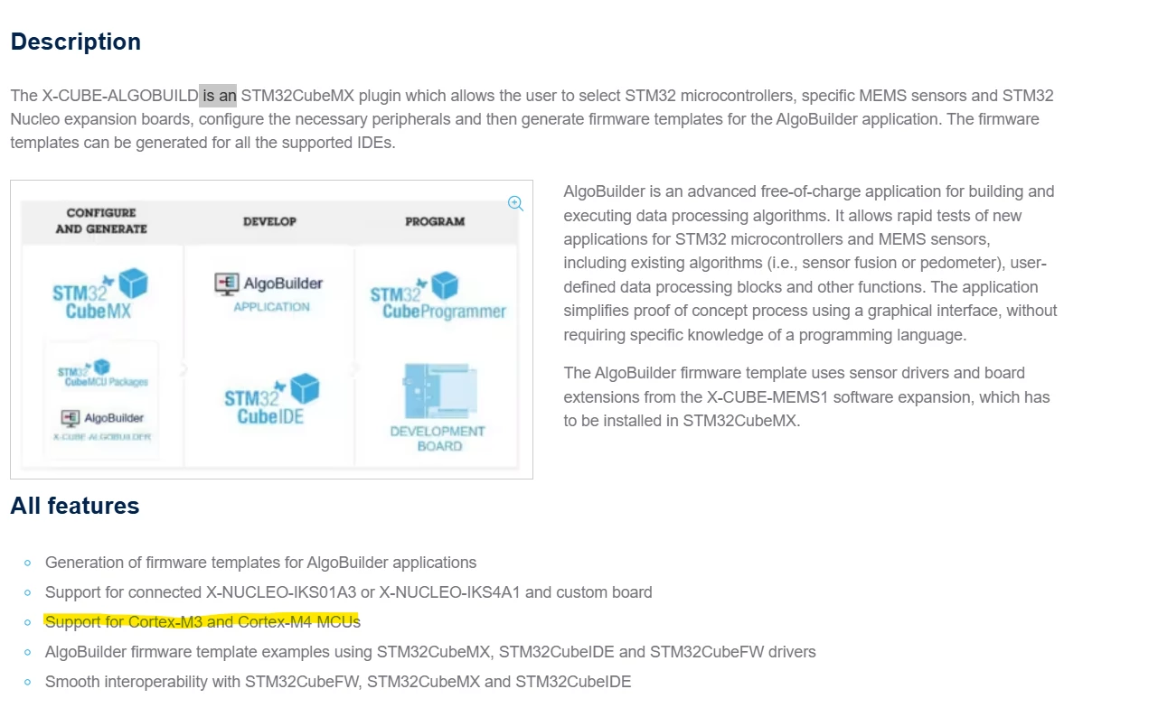

STM32H723 devices are based on the high-performance Arm Cortex-M7.
But, the AlgoBuilder requires an STM32 with Cortex-M3 or Cortex-M4. as mentioned in X-CUBE-ALGOBUILD - AlgoBuilder firmware template generator expansion for STM32Cube - STMicroelectronics and in STMicroelectronics.X-CUBE-ALGOBUILD_GettingStarted.pdf under this path \STM32Cube\Repository\Packs\STMicroelectronics\X-CUBE-ALGOBUILD\1.4.0\Documentation

Hello @Neeee and welcome to the community;
