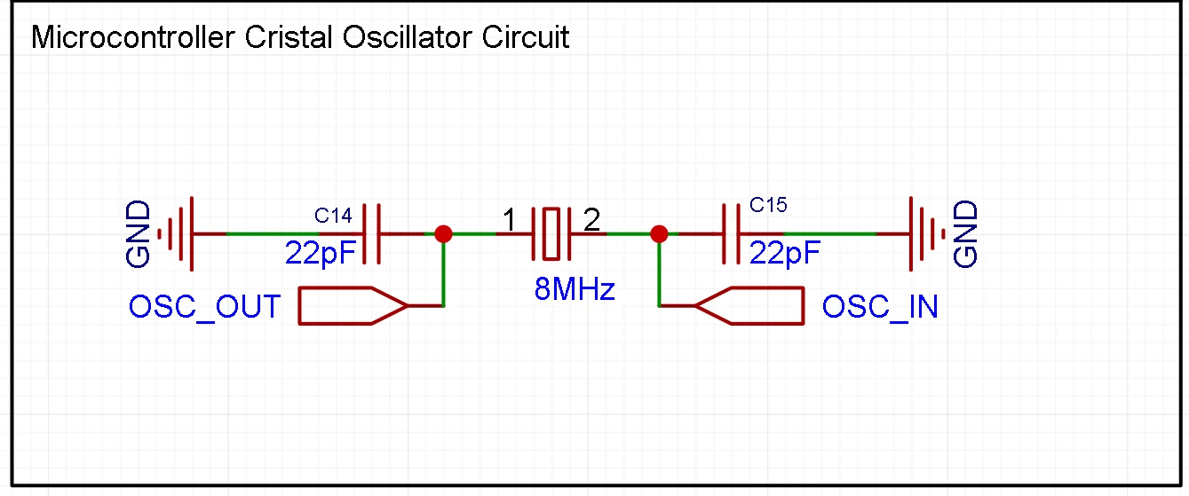

Hi, i am using a STM32F411 for the first time and i am not familiar with the crystal oscillator schematic symbol provided by EasyEDA. Can someone validate this circuit and, eventually, poit out what's wrong plase?
Any help would be apreciated

Pins 1 and 3 should be connected to OSC_IN/OSC_OUT. Pins 2 and 4 should be grounded.

You do not specify the Crystal You are using, without that I can not comment on the schematic., Please read the Application note AN2867 from ST.

I think the OP might be unfamiliar with Pierce oscillators (as "simple" as they are). There is a common idea that we can just drop in a 25Meg Xtal (basic part at JLCPCB) with some caps for the 20 pF loading.
I've seen a lot of examples online that just take a working example with an unknown xtal and bung in the same values as if it will work. The resistor is also critical and often omitted - I'm going to assume at lot of this descends from early Arduinos based on Atmel chips that are much slower and presumably less fussy about drive.

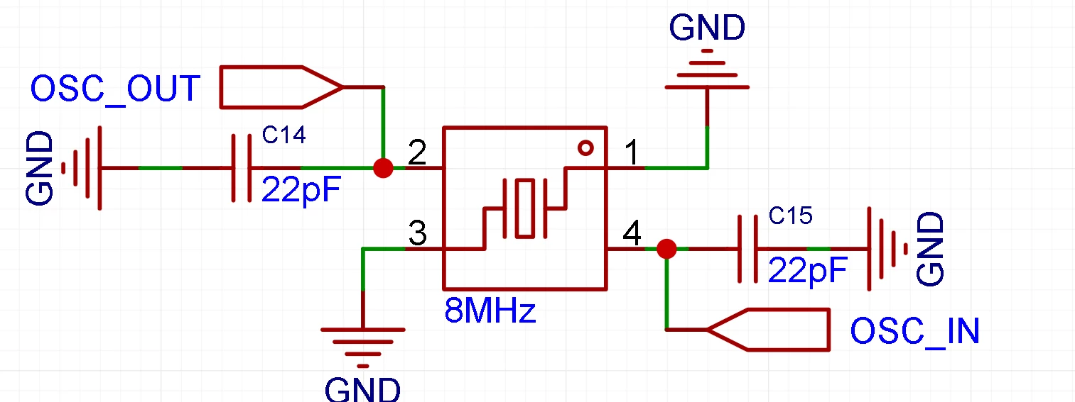

The answer @TDK gave corresponds with what i read in these days.
I also ordered my PCB and i will be delivered in a couple of weeks. If everything proves to work fine i will post my updated schematic.

Hi everyone
The PCB finally arrived and it's proven to work just fine: here is the updated crystall oscillator circuit i used
Here is also the link to the actual component i used: https://www.lcsc.com/product-detail/C889706.html?s_z=n_C889706
Thanks everyone for the support

I'm happy that your oscillator is working, but I don't think that You have read the AN2867, specially the capture 3.3 Loade capacitence, otherwise You had reduce C14 and C15. Even assuming that Your Cs is very Small (for example 2pF), with a CL of 8pF from the datasheet of Your crystal, C14 and C15 will be about 12pF and not 22pF.
This (wrong) value will propably not stop Your oscillator but the frequency will be shifted a little bit.

You should read the knowledge base article How to select a compatible crystal and load capacitors, who explains the topic from AN2867 mentioned be @MHoll.2 in a more practical way.
