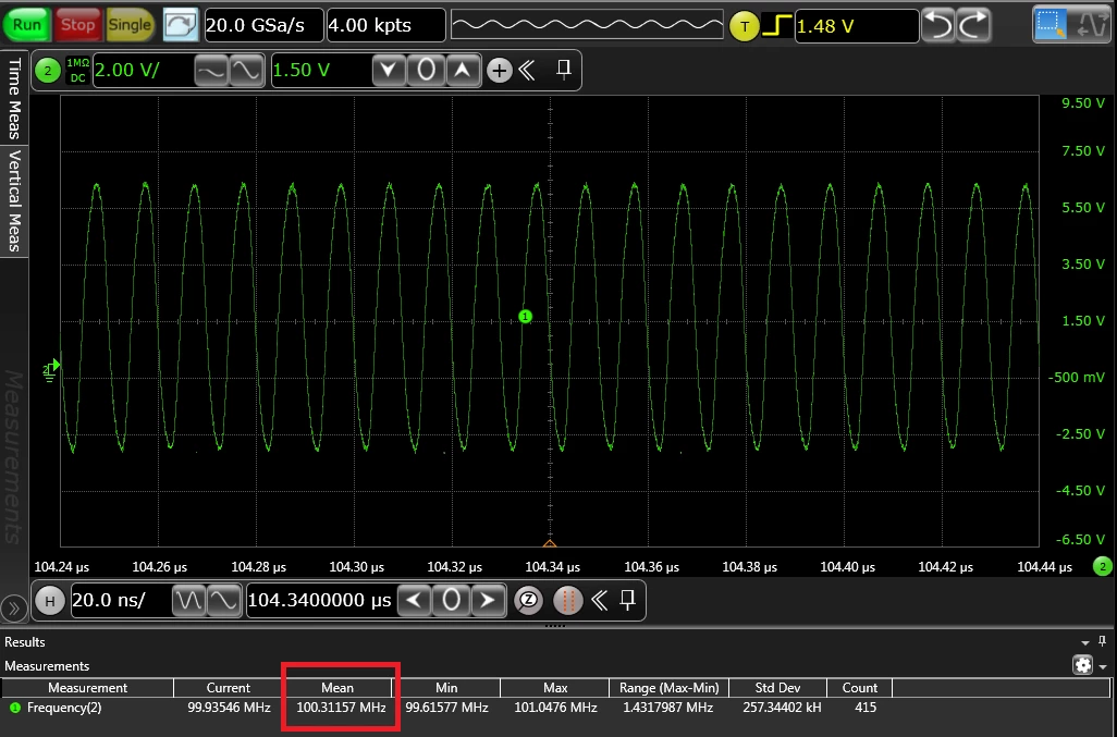

mƎALLEm
August 22, 2024
Hello @Ronil ,
I kindly requested an internal colleague to do the test on a Nucleo H753 with KEYSIGHT DSO9254A oscilloscope. 100MHz is output on the MCO pin like shown in this oscillo screenshot:
So you need to use an adequate oscilloscope and probes for these high frequencies.

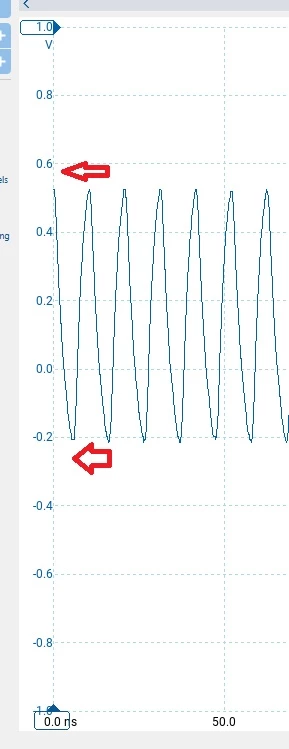

RonilAuthor
August 22, 2024
thank you so much, I use PiScope which operates until 500 Mhz, can you watch my script I expect receive 96 Mhz, but  is nothing

I only wonder why my amplitude is only 1 V, can I control the value of the amplitude of the signal?
I used and another scale but result the same
__HAL_PWR_VOLTAGESCALING_CONFIG(PWR_REGULATOR_VOLTAGE_SCALE0);
BarryWhit
Lead
August 23, 2024
Voltage scaling is unrelated to the amplitude of the crystal oscillator's output signal.
It's normal for the clock oscillator circuit itself (i.e. the chip's XTAL pins) to stabilize at this kind of amplitude. I'm not sure if the MCO output is supposed to be a buffered copy of the signal at the XTAL pins or a proper digital signal (but I note that the scope shows it looks like an analog sine wave). I'm not aware of any way to control the oscillator circuit's steady-state amplitude (It's the combined result of design choices by ST and the crystal used).
If you need a logic signal, you can try PWM with the GPIO pin set to a higher speed.

The PWM signal, AFAIK, is sent out through the same output driver, and is affected by the same GPIO speed register setting.
I don't know where you get this 20Mhz figure, your OP said you were able to go as high as 50Mhz. Did you set the GPIO speed registers to a higher speed and retest?
SoftLit's screenshot shows MCO output is ~3.3 Vpp. Are you sure your measurement equipment is set up properly?
