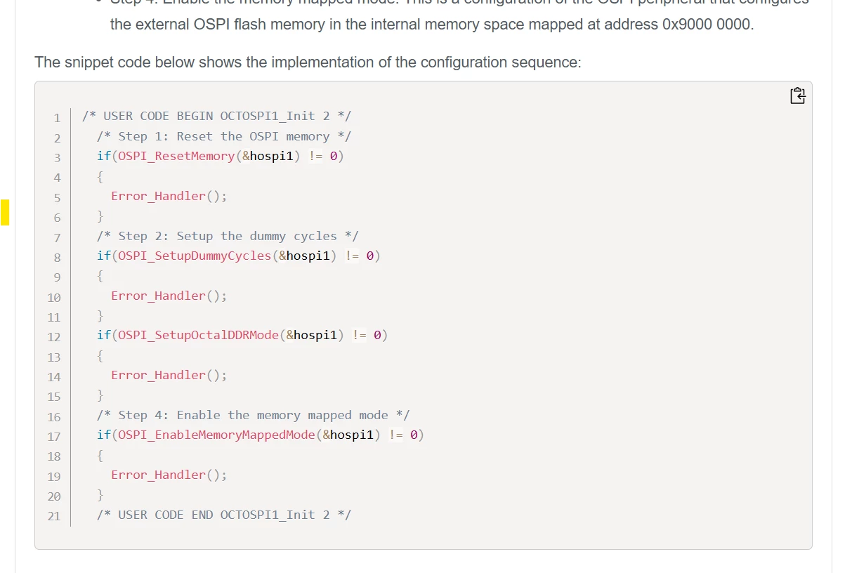

    In the post https://community.st.com/t5/stm32-mcus/how-to-set-up-the-ospi-peripheral-to-interface-with-the/ta-p/49474
    At last there is a snippet available to configure the ISSI flash in DTR mode , Can you provide us any example code for the same .

Hello @sohm,
Could you try to reset the memory device before the configuration?
For that, you need a reset enable command then a reset command must be issued.
I advice you to check this sequence, it’s common that the application needs to configure the memory device. An example of a commonly needed configuration is presented below:
1. Set the dummy cycles according to the operating speed (see relevant memory device
datasheet).
Note: The dummy cycles of the STM32 MCUs are equivalent to the latency term used by the external memory side.
2. Enable the Octo-SPI mode or 16-bit mode.
3. Enable DTR mode.
