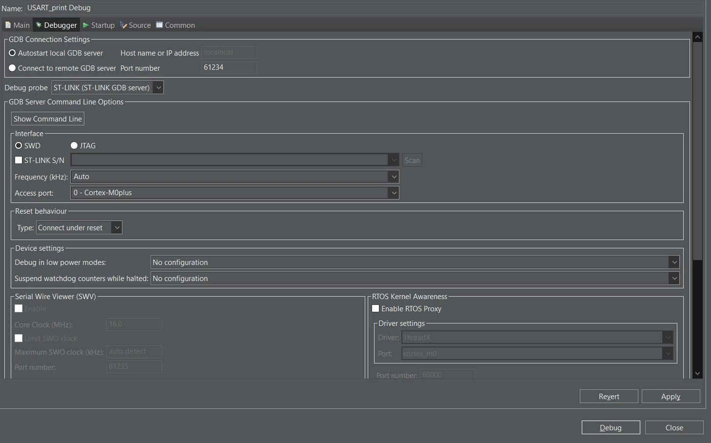

I am trying to print data over USART on the stm32g030c8t6. My code is as follows:

I am not being able to enable the SWV in the debugger to view the printed data. An image of the debugger window is as follows:
0693W00000aHDHDQA4.pngOn using a serial terminal like Putty, a connection with the COM port is established but no data is read. Can someone please tell me what mistake I may be making.

Hello @YBend.1​ ,
A similar question is already asked here.
SWV options is not available with Cortex-M0+.
When your question is answered, please close this topic by choosing Select as Best. This will help other users find that answer faster.

The Cortex-M0 lacks SWV, so it's the wrong setting/term to be using.
You'll instead be using a USART, so you need to make sure the plumbing there works end-to-end.
Check wiring, clocks, pin configurations, etc.
Make the USART2 work properly, using regular HAL functionality.
Trace signal with a scope, perhaps output stream of 'U' characters.
