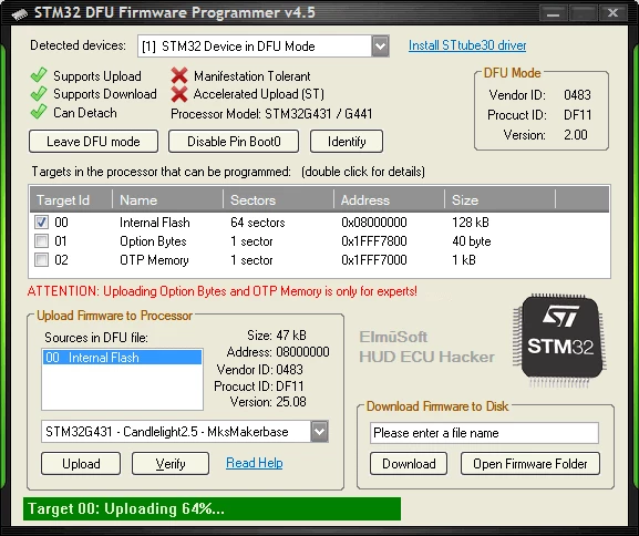

I wrote also a Firmware Uploader which allows ordinary users without programming skills to upload their firmware with one click to their STM32 processor. It is based on the very sloppy open source code in the DfuSe application from ST where I had to fix dozens of bugs and added new features.

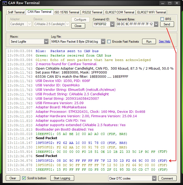

I also wrote a CAN Terminal that allows to communicate with CAN bus, see the traffic, send packets, write logfiles and even write macro scripts to simulate any CAN bus device.
