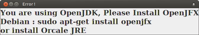

Can not start STM32CubeProgrammer under Debian
Posted on January 11, 2018 at 11:54
Under Linux Debian Stretch:
- if I use the shortcut nothing happens
- if I type ./STMicroelectronics/STM32Cube/STM32CubeProgrammer/bin/STM32CubeProgrammerLauncher,
I have this error message: Error: Could not find or load main class com.st.app.Main
What should I do in order to run Cube Programmer ?

    Aymen Abderrahmen
    Visitor II
    Jan 12, 2018 1:37 AM UTC
    Posted on January 12, 2018 at 02:37
    Hi Cédric,
    You are surely using OpenJDK, which is unsupported. Please install oracle Java or install Openjfx package (sudo apt-get install openjfx).
    BR,
    Aymen.

    Cedric Boudinet
    Jan 12, 2018 9:41 AM UTC
    Posted on January 12, 2018 at 09:41
    It works after installing openjfx
    Thanks a lot

    ADry
    Jun 22, 2019 7:22 AM UTC
    I have some problems with launch CubeProg from Ubuntu.
    $ ./STM32CubeProgrammer
    /usr/local/STMicroelectronics/STM32CubeProgrammer/bin/STM32CubeProgrammerLauncher
    JavaFX NOT installed => warn user
    But openjfx installed:
    $ dpkg -l | grep openjfx
    ii libopenjfx-java                      11.0.2+1-1~18.04.2                     all         JavaFX/OpenJFX - Rich client application platform for Java (Java libraries)
    ii libopenjfx-jni                       11.0.2+1-1~18.04.2                     amd64       JavaFX/OpenJFX - Rich client application platform for Java (native libraries)
    ii openjfx                              11.0.2+1-1~18.04.2                     amd64       JavaFX/OpenJFX - Rich client application platform for Java
    ii openjfx-source                       11.0.2+1-1~18.04.2                     all         JavaFX/OpenJFX - Rich client application platform for Java (sources)
    $ update-java-alternatives -l
    java-1.11.0-openjdk-amd64     1111      /usr/lib/jvm/java-1.11.0-openjdk-amd64
    Please any help!
    ADry
    Jun 22, 2019 8:04 AM UTC
    SOLVED.
    Need doungrade jdk & jfx
    # apt install apt install openjdk-8-jdk openjfx=8u161-b12-1ubuntu2 libopenjfx-java=8u161-b12-1ubuntu2 libopenjfx-jni=8u161-b12-1ubuntu2
    than
    # update-alternatives --config java
    and set java-8-openjdk
    And hold the version:
    echo "openjfx hold"|dpkg --set-selections ; echo "libopenjfx-java hold"|dpkg --set-selections ; \
    echo "libopenjfx-jni hold"|dpkg --set-selections ; echo "openjfx-source hold"|dpkg --set-selections
