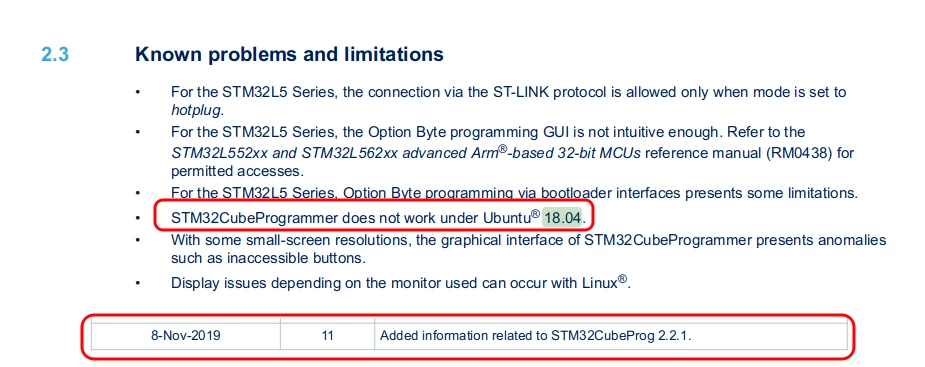

    Carlos' advisory above may have been valid 3 months ago but it's NOT TRUE now -- I can vouch for having it working on an Ubuntu 18.04 desktop, after installing JFX.
    BUT.. am not in the office today (Sunday) and am trying to get it going on a laptop, trying to remember what else I had to do... sorry not hugely helpful but I assure you it will run on 18.04. I use it daily.

    SOLUTION for Ubuntu 18.04 CURRENT 22 Feb 2020:   The detail advice is provided in ST's USER MANUAL for the Programmer, which is here:
    https://www.st.com/content/ccc/resource/technical/document/user_manual/group0/76/3e/bd/0d/cf/4d/45/25/DM00403500/files/DM00403500.pdf/jcr:content/translations/en.DM00403500.pdf
    Relevant instructions for Ubuntu 18.04 are:
    To get STM32CubeProgrammer working with Ubuntu ® 18.04
    1. Install OpenJDK 8
    a) sudo apt install openjdk-8-jre-headless
    2. Set OpenJDK 8 as your default Java Runtime Engine
    a) sudo update-alternatives --config java
    3. Install OpenJFX
    a) sudo apt purge openjfx
    b) sudo apt install openjfx=8u161-b12-1ubuntu2 libopenjfx-jni=8u161-b12-1ubuntu2
    libopenjfx-java=8u161-b12-1ubuntu2
    c) sudo apt-mark hold openjfx libopenjfx-jni libopenjfx-java
    To install the STM32CubeProgrammer tool, you need to download and extract the zip
    package and execute SetupSTM32CubeProgrammer-vx.y.z.linux, which guides you through the installation process.
    I've just done this on Ubuntu 18.04 on an i5 and it works fine now.
    (And I remember now this was what I had to do a few months back on the desktop mentioned above).
    Good luck all.

    I tried your way but that didn't work for me. Solved : see my update above -- I find the instructions from the User Manual work fine:
    https://www.st.com/content/ccc/resource/technical/document/release_note/group0/0e/66/57/b4/f9/ee/4f/73/DM00441049/files/DM00441049.pdf/jcr:content/translations/en.DM00441049.pdf

    PLEASE help i think that ubuntu 18 is very mainstream and this should work when the oracle JDK and JRE are installed as per the book and same for the openJFX.
    Thanks by advance !
    This is really hard to believe that with about 12 years of experience as a developer i cannot get STM32cube to work.
    Not a good look and first impression to say the least...
    And btw why arent all these instructions about jfx not included in your installer or in a README ?
