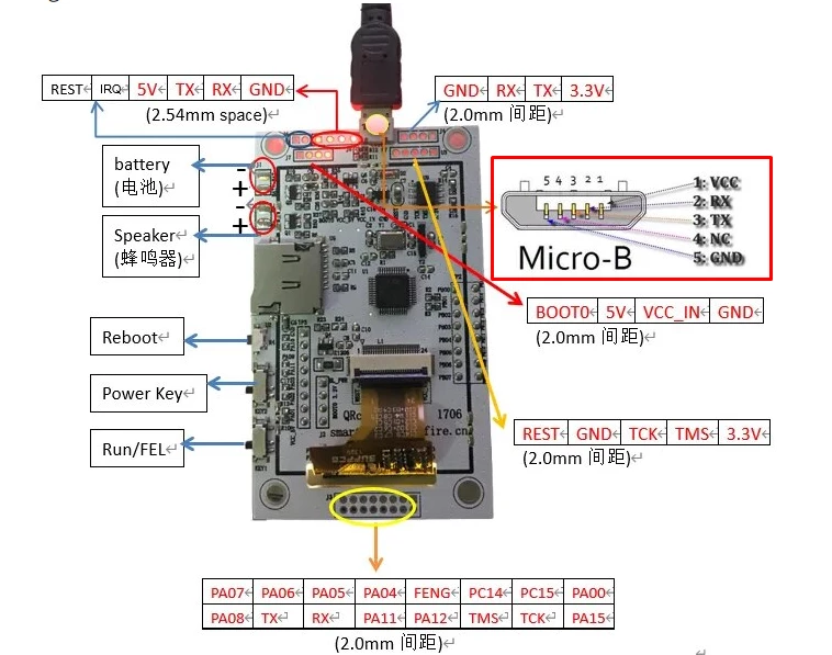

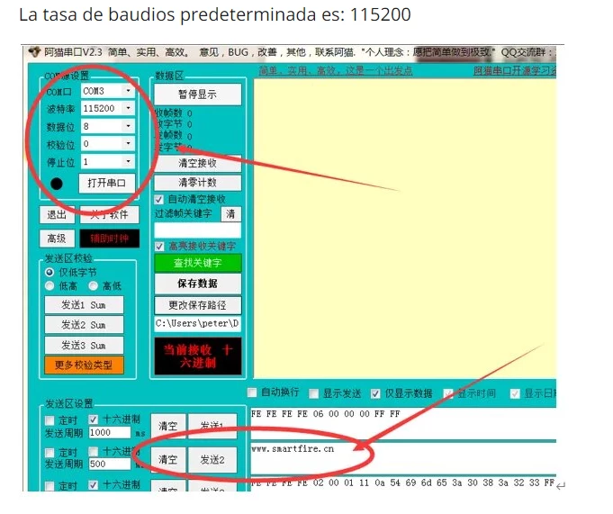

The interface looks like TTL serial so yes it can be managed from a PC with a USB to TTL adapter. On that aliexpress page click on VER MAS and it will show the pinout and programming details.  Enjoy :)

That would suggest if you have a USB-to-CMOS Serial adapter to provide power and serial connectivity you could use a Terminal application or your own code to send command/data packets to the display in the manner the vendor documents/describes.

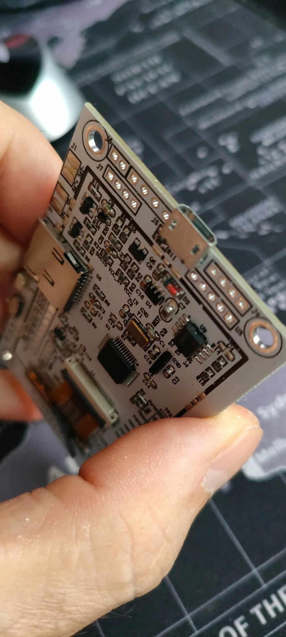

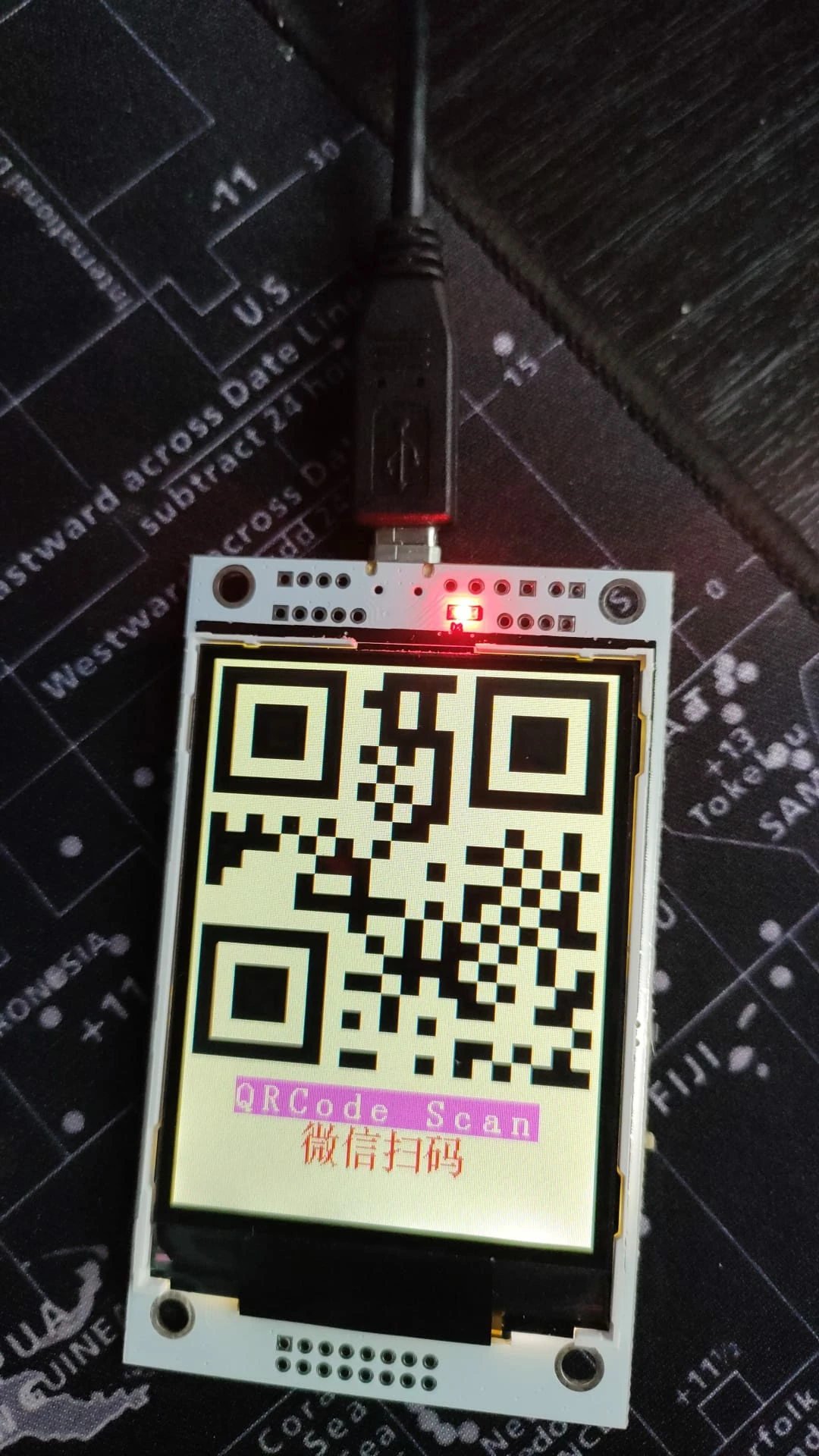

i attached 2 pictures when i show the device has an USB connector. When i connect it, the device starts and seems to work. But i have some questions:
- Why is needed to provide power? is not ok like now?
- The device has no other connector where to connect another one or pins holes...
- When i connect the USB, i do not see COM Port on Windows 10. Windows doesnt recognize the device.
I dont know what to do... :(

Looking at the image attached, seems the Micro-B USB connector is what i need to use. The question is: any normal USB wire is ok for this?

This connector is not USB. It is TTL serial, with power.

They've chose not to implement USB, but rather use the standard connector as a means to power (say USB charger), and provide serial wiring for an MCU, rather than the D+/D- connectivity for USB.

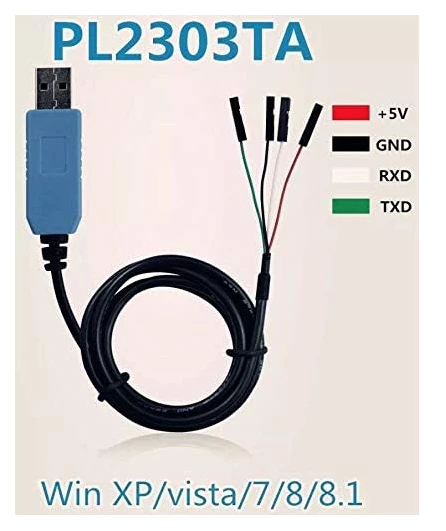

Hi again. Finally i solved the situation. I do not use the integrated USB port in the card because i do not have a wire in this moment.
But i have the wire on the picture attached. Once connected to the board, all is working.
Thanks very much for your support. You put me in the right direction.
