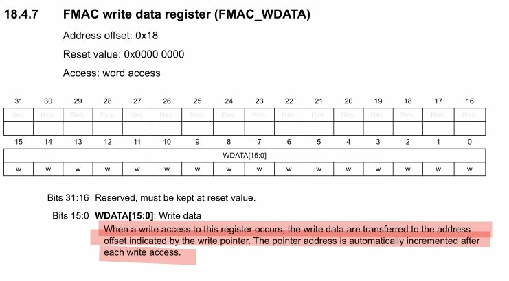

DMA to peripheral address range: I agree...but I don't think the FMAC's 'internal memory' is mapped like this. I figured there would simply be a base address, but there's nothing in the documentation other than the FMAC config registers.  Is there a mapped address space for FMAC memory?
Regarding the double buffering thing: I don't think that will work. X1 needs to be loaded by 16 writes to WDATA. This can be done with memory to memory DMA, but the FIR function appears to be disabled until all the values are loaded.

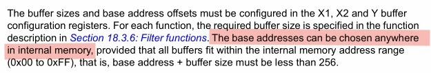

But you can split up the internal memory as you wish. You can remap the base address (relative offset *within* internal memory) before you start up the FMAC, and you change the size of the buffers you want FMAC to work on. I think this could totally work, but I have no experience that proves it.

So you already know about the WDATA register. At this point, I'm not quite sure what you're asking about.
Access to internal memory is through these WDATA/RDATA registers and an internal auto-incremented pointer. You can absolutely DMA to that peripheral register.

I think a separate FMAC only bus may be kind of what's happening.  It seems a DMA request from the FMAC or a write to WDATA is the only way to get info into the FMAC internal memory.

I'm pretty sure when FMAC is doing its "pull" thing via DMA, it is simply triggering a DMA request which ultimately results in a write to WDATA taking place over the bus. There is nothing magical going on.
Fine, and wouldn't a DMA write to WDATA triggered by the producer peripheral work?

I haven't tested, but setting up a 16 value DMA transfer where the source address is incremented and the destination isn't would implement the WDATA DMA write required.  However, this takes up time in an interrupt before the FIR operation can be executed.
