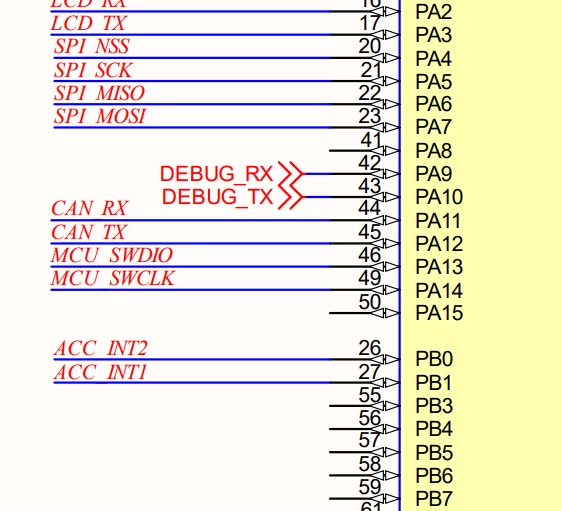

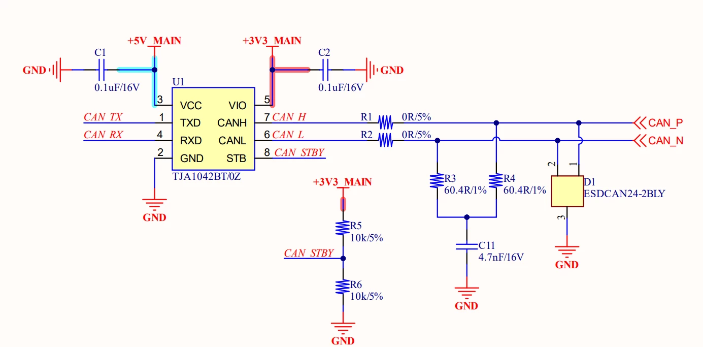

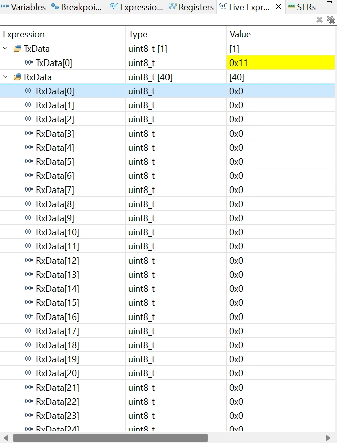

I am currently working on a Battery Management System (BMS) and an instrument cluster. I need your assistance with some issues I’m encountering while communicating between the BMS and a custom cluster board using CAN.
We have two custom cluster boards equipped with STM32F098RCT6 MCUs and TJA1042 transceivers. I successfully established communication between the two boards and received the RxData in the debug terminal.
When I attempt to establish communication between the cluster board and the BMS, no data is received in the debug terminal. Despite numerous attempts, I have been unable to achieve successful communication.
Please provide some insight about this.

You need to ensure that BMS is sending frames to STM32. Did you verify that with an oscilloscope or CAN bus analyzer ?

Could you please also your schematics? especially CAN part STM32/Tranceiver.
Meanwhile, refer to this article: https://community.st.com/t5/stm32-mcus/can-reception-issues-reasons-and-general-troubleshooting/ta-p/689741
October 24, 2024
We require a bitrate of 500,000 bps. To achieve this, I selected the appropriate prescaler, BS1, and BS2 parameters.
Here is the schematics:
  In the transceiver, we grounded the STB pin.

What debugging and instrumentation do you have at each node?
Do you have a CAN Bus Analyzer?
