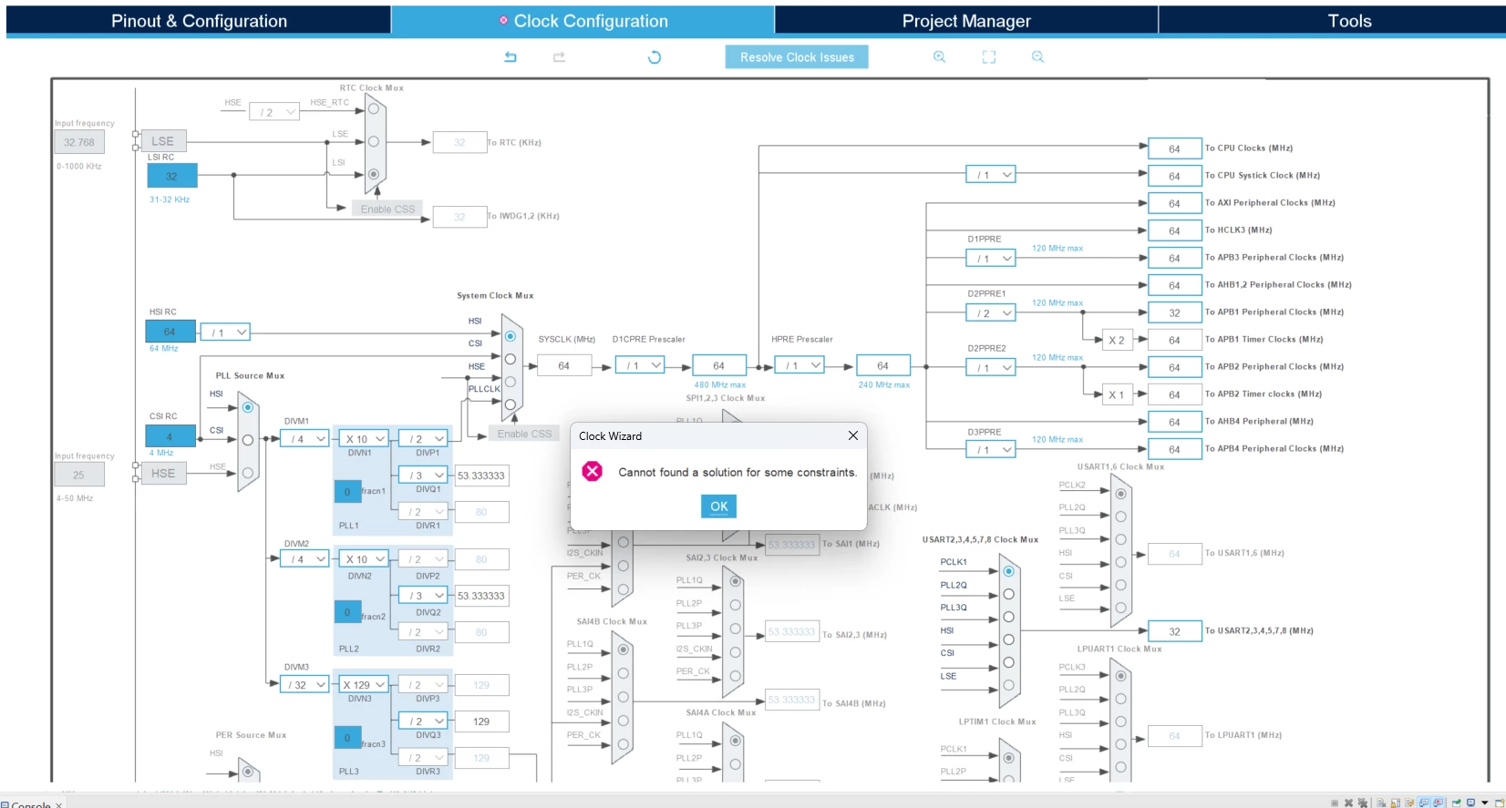

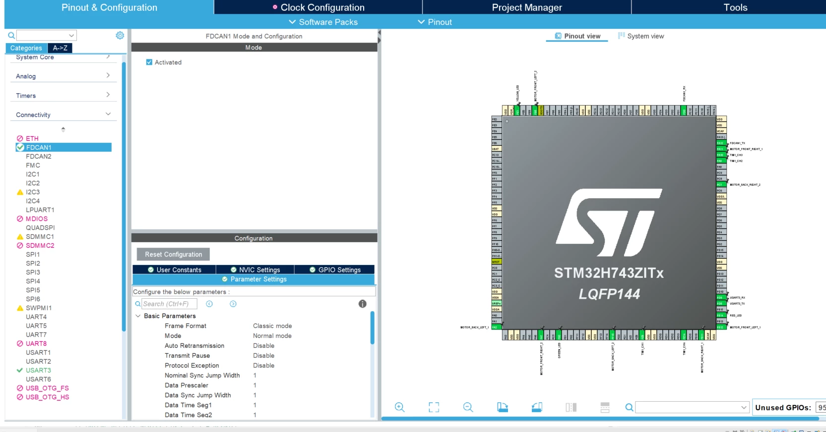

I’ve recently started using ST products and the IDE with CubeMX, which is why I’m asking for your help. I’ve just begun developing a communication system using a Nucleo H743ZI2; my goal is to set up a UART and a CAN bus.
The UART is done; I used DMA access to optimize it. However, when I try to enable the CAN bus in Cube MX, I run into a problem with the clock configuration related to the bus.
When I use the “Resolve Clock Issues” function, I get the error: “Cannot find a solution for some constraints.”
Does anyone have any ideas to help me solve this problem?

Hello @AmGo and welcome to the ST community,
What system clock you are trying to set? from the screenshot the system clock source is generated directly from HSI. Not possible to find other value for system clock other than 64MHz. You need to select PLL source for that.
For CAN communication you need to use HSE with a crystal or any other precise clock source.
In the case of Nucleo-H743 use HSE in bypass mode, so the clock source is generated by the ST-link. But for that you need to ensure that STLINK-MCO is generated from the HSE STLINK module. Please read this article: How to use STLINK-V3 MCO output on Nucleo boards as a precise clock source for STM32

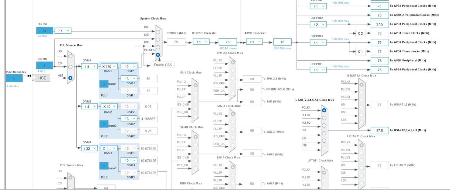

However, some points are still unclear to me. I don't quite understand the purpose of the 5MHz input frequency. Also, when I use “Resolve Clock Issues,” my board’s frequency jumps to 75 MHz. Is it possible to set it back to 64 MHz like before ? I haven’t been able to do that. If so, I’ll need to change all my prescaler and ARR values for my timers.
The answer is in the article itself:
5MHz was the only option generated by the ST-LINK module based on a crystal while avoiding the decimals.
This is what you need to configure in your case (even I don't know why you specifically choosing 64MHz as system clock):
In RCC menu, select Bypass Clock source:
Hope it's clear now.
AmGoAuthor
March 17, 2026
UPDATE : I managed to set my board's clock speed to 64 MHz. However, I'd still like to understand what impact this 5 MHz difference has and what it corresponds to : Is it the clock speed generated by my ST-Link ?
mƎALLEm
March 17, 2026
Yes. By selecting Bypass mode, the clock source arrives to OSC_IN pin to feed the RCC which is generated by ST-LINK.
