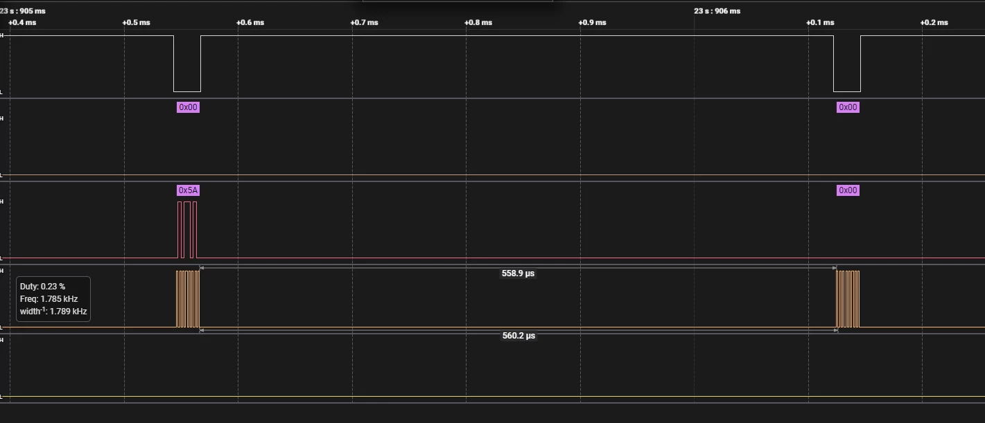

So far, we are seeing this happen on the SPI lines through a logic analyzer:
And we are not sure why...

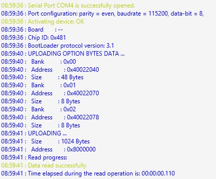

Good point, the VCC of the V3SET expects 3.3V so we moved the pin to a 3.3V pin.
We were able to successfully connect the Nucleo board to the bootloader using the VCP interface and getting this output from the log:
We did also switch the SPI pins a couple of times and does not seem to change behaviors.
