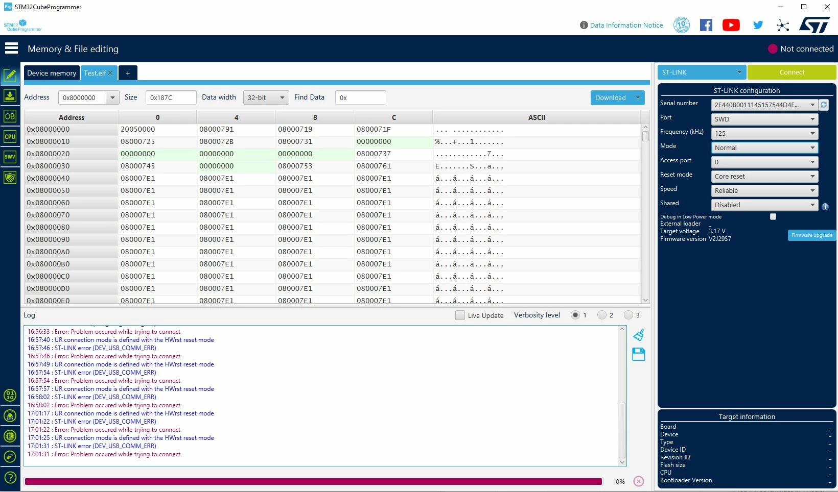

I am an absolute beginner in STM32 ecosystem. This is my first time programing an STM32. My MCU is STM32F756VGH6 in TFBGA100 package. I wrote a simple led blink program and encountered a problem while trying to flash the MCU (got some kind of error while trying to flash directly from the STM32CubeIDE). After consulting with my friend, I tried only building the project in the STM32CubeIDE and using STM32CubeProgrammer to flash the MCU. However, there was no luck yet... While trying to flash the .elf file from the project`s debug folder I was constantly getting error ,,Problem ocurred while trying to connect". I guess its worth mentioning that I was also constantly getting message that I should update my stlink`s firmware, but that process was not successful either.

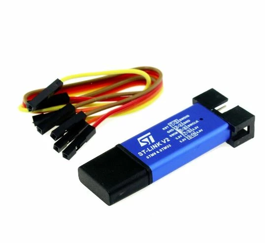

For the record, my stlink is not an original one (picture down below), but it worked for my friend, and also a few years ago I programmed an STM8 with it, so I guess this should not cause any problems - the programmer has to be working.

There have been a lot of posts lately from people with counterfeit programmers with this error. Seems STM32CubeIDE may have been updated to reject them.
Programmers (at least STLINK-V3MINIE) and nucleo boards are cheap, recommend getting one of those. I doubt ST is making any profit off of them.

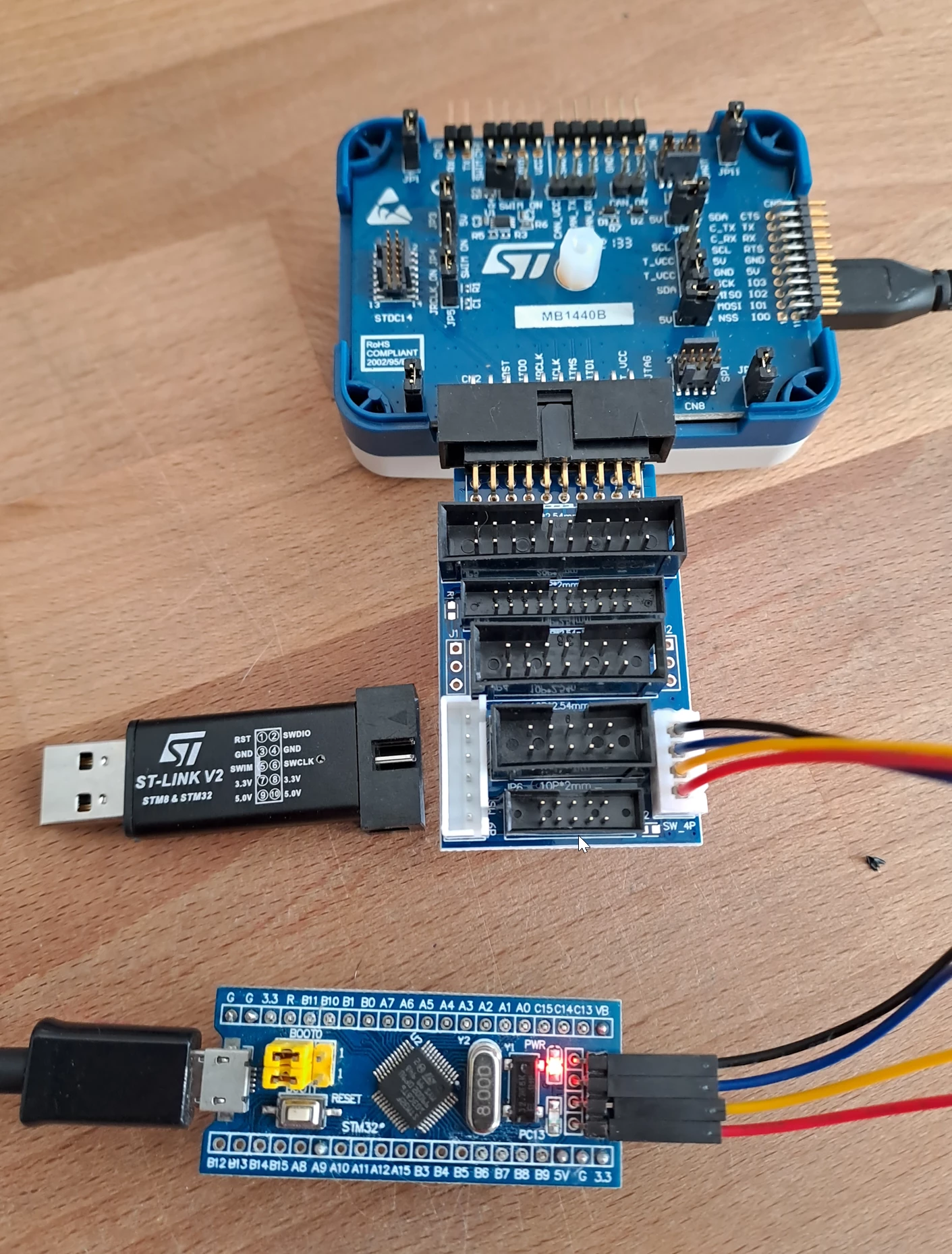

Johi
Senior II
July 28, 2023

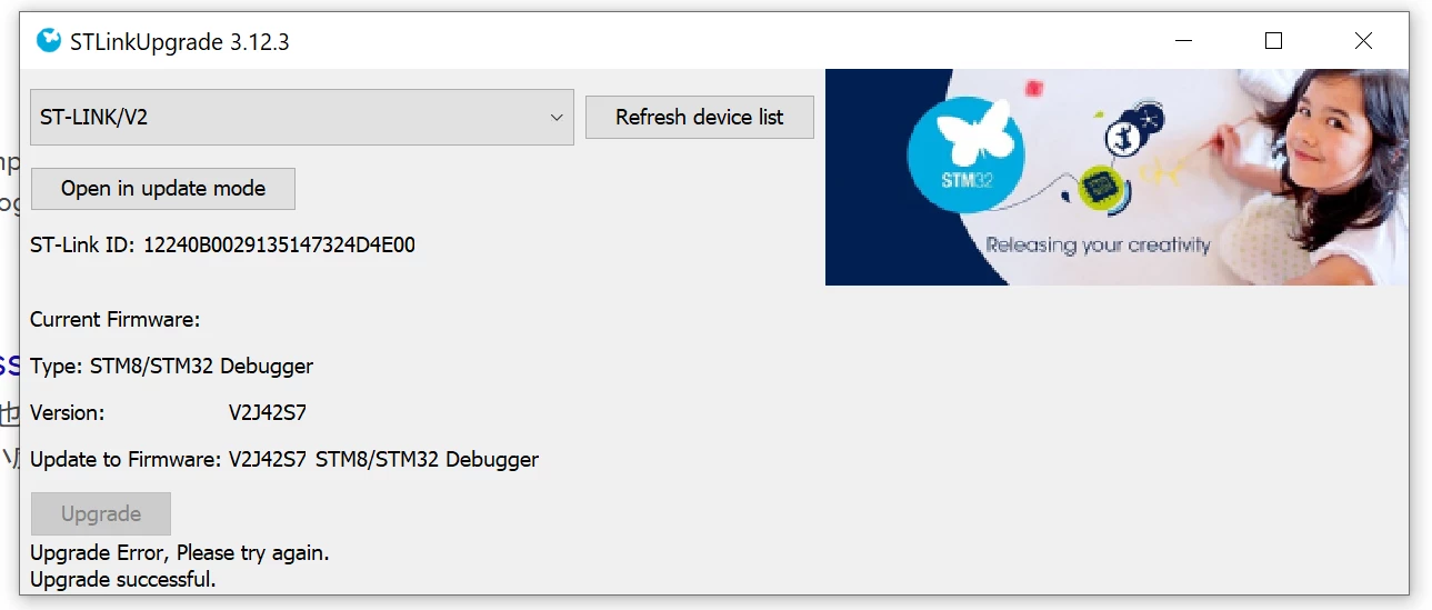

I did some experiments with an old blue-pill including an old programmer identical to the on of the OP from similar origin. (If I am not mistaken, the black V2 ST-Link programmer used to work with STM32CubeIDE properly)
My findings point in the same direction as indicated by @TDK:
  • STM32CubeIDE is refusing to connect to the blue pill but request a firmware upgrade.
  • Firmware upgrade process gives strange feedback messages (upgrade succeeded and failed together ?):
Trying to reconnect -> same cycle restarts
Using STLINK V3-Set, programming and debugging works as it should.

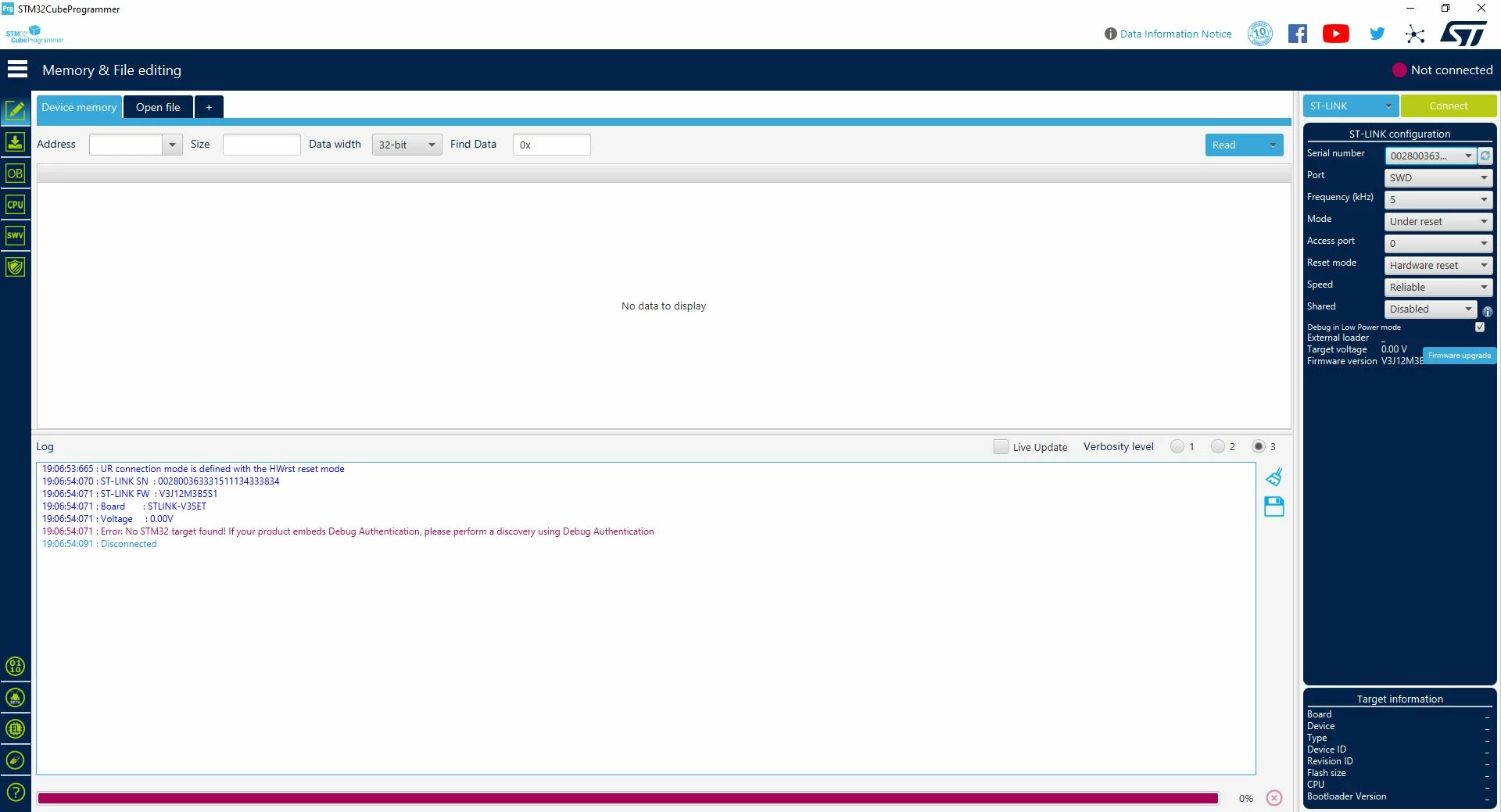

I got an original stlink V3 with the latest software. Also wrote a simple LED blik program that does compile, however, I encountered problems while flashing again.
No STM32 target found! If your product embeds Debug Authentication, please perform a discovery using Debug Authentication
Thats what the STM32CubeProgrammer tells me when I press ,,Connect" button in the STM32CubeProgrammer... Some other details:

October 30, 2023
Should work. Double check your pin connections. Shouldn't need to, but you can click "connect under reset" to prevent bad code from re-assigning the SWD pins.
How confident are you that the BGA is properly soldered?
Are VCAP decoupled to ground with a 2.2 uF cap? Are VCAP voltages ~1.2V?
Are VDDA and all other VDD pins powered? VSS/VSSA all connected? Other schematic errors?
Typically BOOT0 is pull down to GND, not to 3V3, so that user code is run on startup. Not the problem here though.

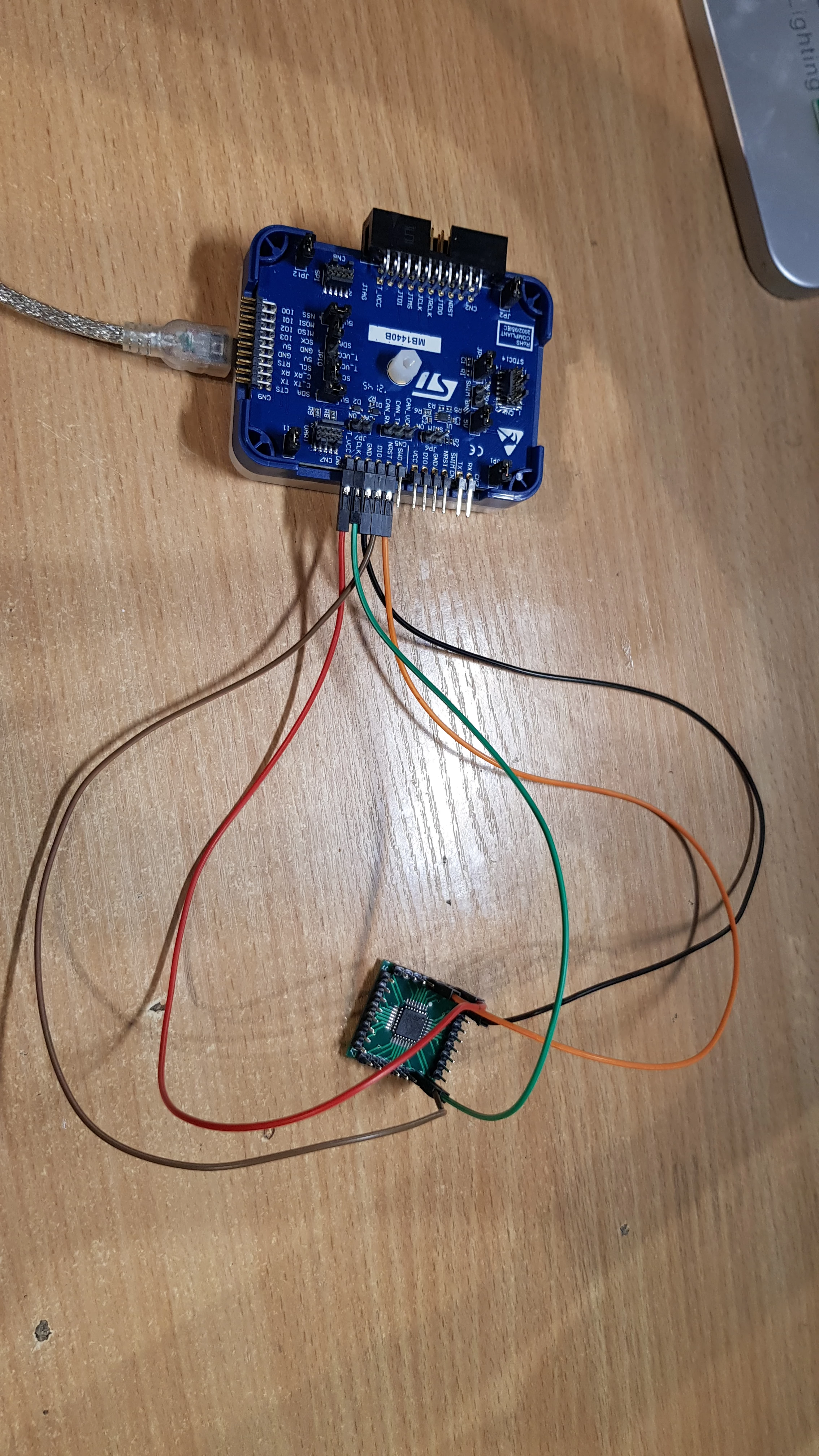

Vilius
ViliusAuthor
October 31, 2023

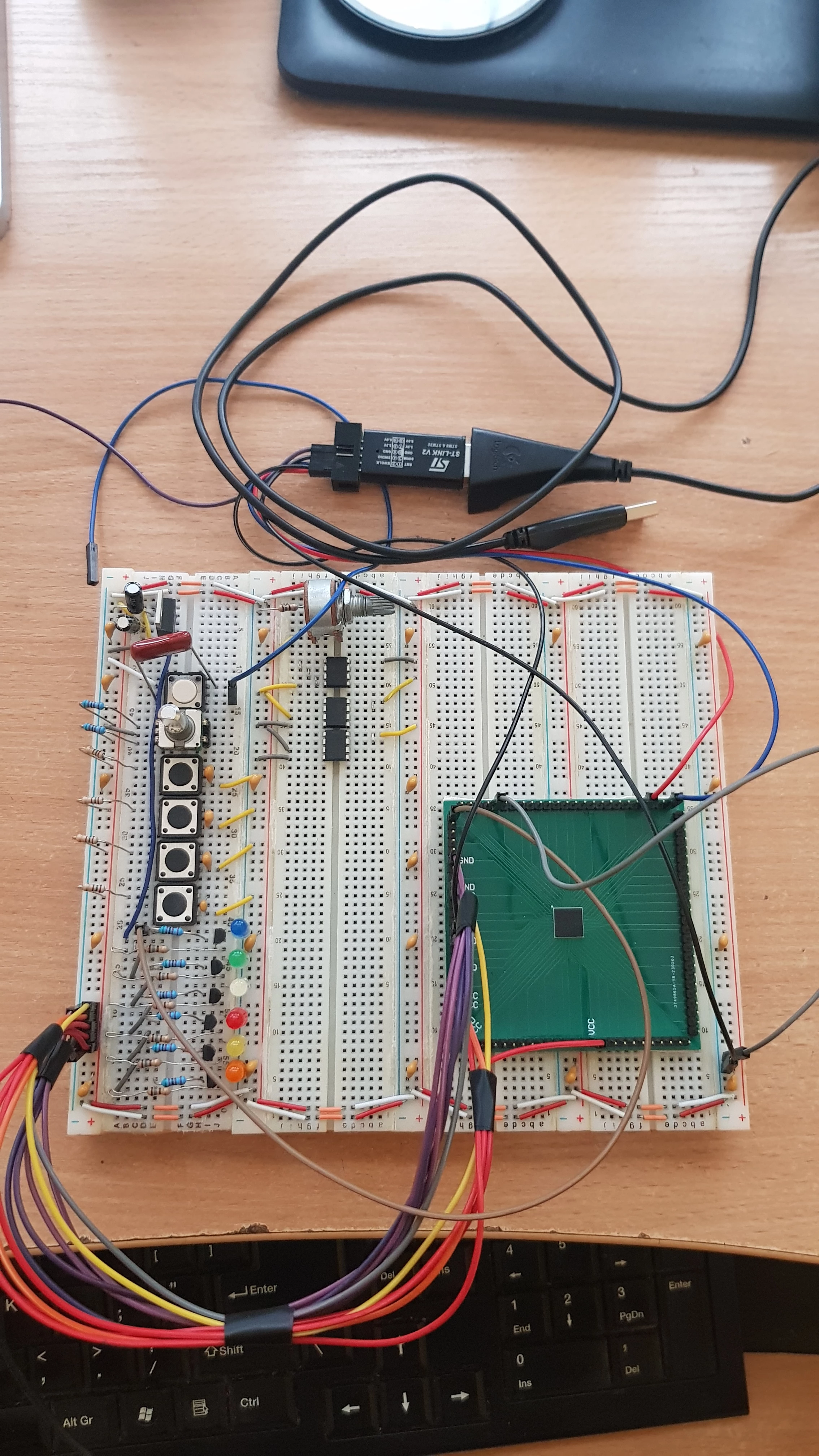

Ok, after few hours I lost the connection I wrote about in the last post. Now I get exact same error just like yesterday when I try to connect my MCU to the programmer...My wiring is in the picture below. I use a quality micro USB cable connected to USB 3.0 port on my computer. I dont see any other hardware issues at all.

Pavel A.
October 31, 2023
The "authentication" message is misleading, not relevant here. Check the flying wires from ST-LINK to the target.

ok, so you are experienced professional . i am not...just playing around with electronics 40 y.
but on your pic with your almost empty breakout board - where are all decoupling caps, the crystal oscillator etc ... bottom side?

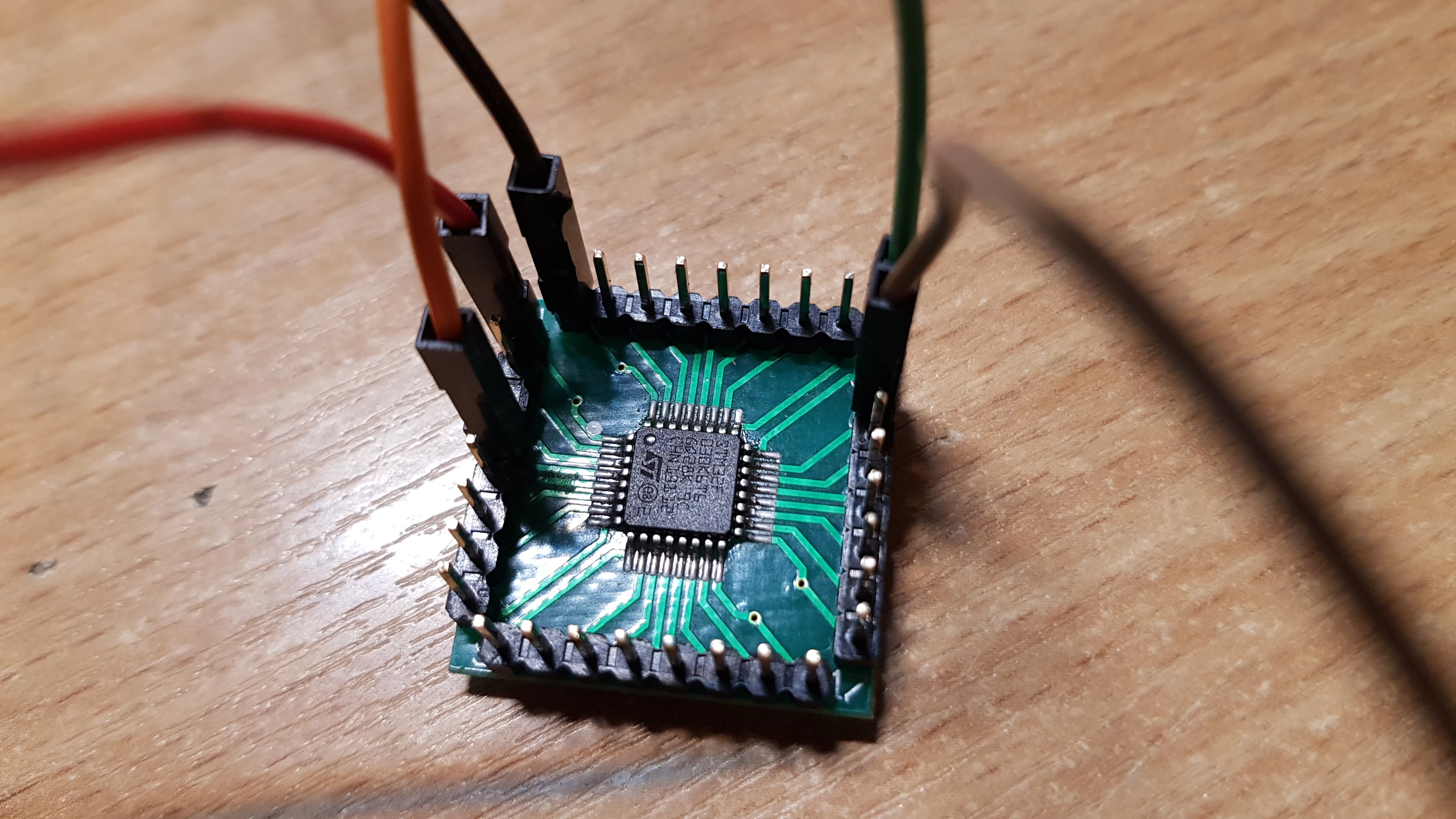

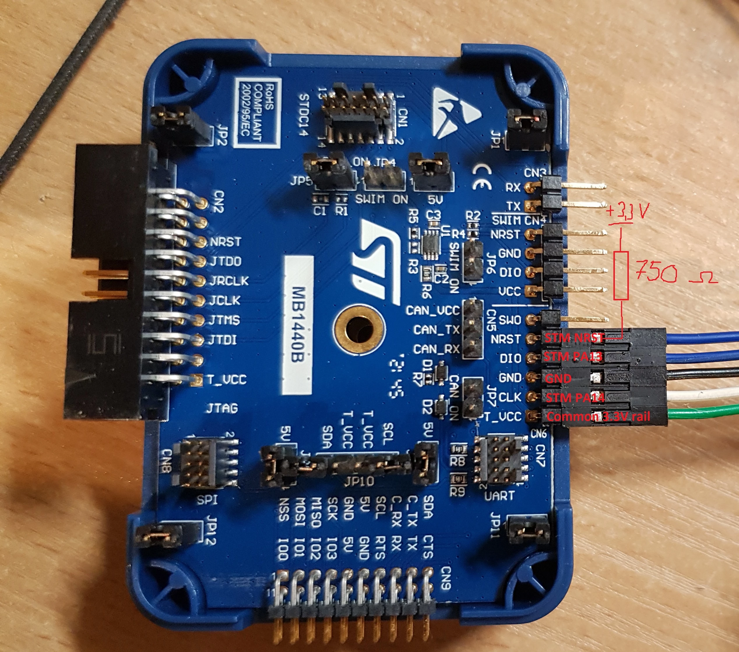

Ok, update again.
I took a spare STM32F030K6T6 in LQFP32 package. I soldered it straight to breakout board without any capacitors etc. I connected the jumpers for SWD programming. I guess this time it is as simple as it gets... I still get the same ,,No device found" error. I choose the lowest 5 Khz speed... Interesting, that logs show voltage of 0V, (VDD of STM32 connected to the VCC pin of stlink) And I also get same error text file as soon as I connect my stlink to the PC. I am clearly missing out some settings. Any ideas?
AScha.3
November 5, 2023
at this target voltage
st-link dont work - it assumes, no target can work at 0V .
so connect st-link vdd (input) to target vdd (3v3).
you have to connect 3v3 power to your target !!!! the st-link only checking voltage - NO power output !!!
