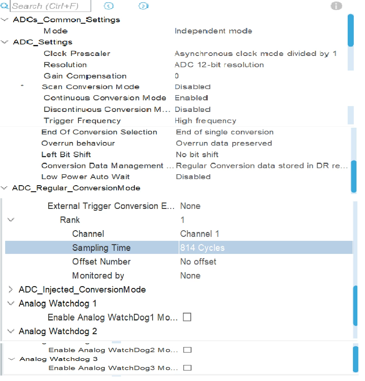

hi, im working on ADC, but ADC is not working, it is getting into infinite loop in this stage  while ((hadc->Instance->ISR & tmp_flag_end) == 0UL)
and my code follows like this
HAL_GPIO_WritePin(GPIOH, GPIO_PIN_7, GPIO_PIN_SET);
   // get ADC value
   HAL_ADC_Start(&hadc1);
   HAL_ADC_PollForConversion(&hadc1, HAL_MAX_DELAY);
   raw = HAL_ADC_GetValue(&hadc1);
   HAL_ADC_Stop(&hadc1);
   HAL_GPIO_WritePin(GPIOH, GPIO_PIN_7, GPIO_PIN_RESET);
   HAL_Delay(1000);
  data= (float)(5*raw/4095);
  uint8_t length= sprintf(msg, "%.3lf\r\n\0", data);
  HAL_UART_Transmit(&huart1, msg, length, 100);
it is getting stuck in ADC poll for conversion. UART is working perfectly fine.
changed the frequency, checked by changing with channels and different ADC bits. and no option for changing to synchronous, its working on async.

0693W00000Y7TSiQAN.pngthese are the configuration need to take care while designing.

The STM32U5 family has an internal switch on the VDDA, it is necessary to activate it by software.
Check this question if it helps you:
https://community.st.com/s/question/0D53W00001XwdhxSAB/how-to-enable-adc1-on-nucleou575ziq

@RomainR.​ thanku.. but no luck,, not working.. is their anything i have to enable
RomainR.
January 4, 2023
Bad news.
Are you using a custom board  ?
Are the product pins VDDA, VREF+, VSSA and VREF- correctly supplied?

no not custom board, yes all pins correctly supplied..

It would be useful for the community if you could explain what you have changed in your code ?
