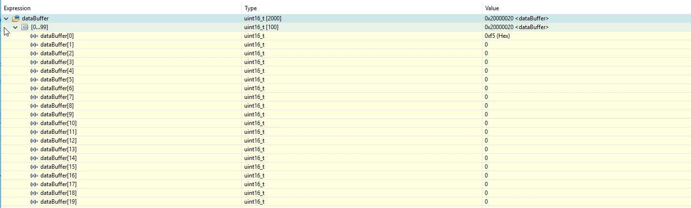

I'm currently trying to use ADC1 + DMA1 + TIM1 on STM32F091CC. I've run into two problems:
1 - DMA is not incrementing the memory buffer('Increment Address' is checked on CubeMX and hdma_adc.Init.MemInc = DMA_MINC_ENABLE). It overwrites every data read on the same address.
2 - Regardless of Data_Width value, DMA is only copying the first byte to the destination address.(overwriting previous values - see 1 and attached pictures).

Calling function:
uint16_t dataBuffer[2000] =
{ 0 };
bool helperFlag = false;
int main()
HAL_Init();
SystemClock_Config();
MX_GPIO_Init();
MX_ADC_Init();
MX_USART1_UART_Init();
SB_PowerAudioEnable();
HAL_UART_Transmit(&huart1, 'TEST AUDIO - START\n', 19, 50);
MX_DMA_Init();
MX_TIM1_Init();
SB_Test_Audio_RawChannel_4khz();
while (1)
void HAL_ADC_ConvCpltCallback(ADC_HandleTypeDef* hadc)
helperFlag = true;
uint8_t SB_Test_Audio_RawChannel_4khz()
uint8_t asd = 0;
HAL_ADC_Start_DMA(&hadc, (uint32_t *) dataBuffer, 30);
HAL_TIM_Base_Start(&htim1);
while (helperFlag == false)
asd++;
HAL_TIM_Base_Stop(&htim1);
HAL_ADC_Stop_DMA(&hadc);
return HAL_OK;
Has anyone dealt with something similar before?

BarryWhit
Lead
June 21, 2024
This was fixed twice (because it came back once). It seems to have been resolved conclusively with CubeMX V6.6.0.
Note that old ioc file need to be fixed manually - it is not enough to upgrade CubeMX/CubeIDE.
Guru Jan made a comprehensive post collecting together the storm of threads opened by folks injured by this
CubeMX: ADC and DMA initialized in the wrong order
The wiki also details how to manually update the call order:
MX_DMA_Init order in the main.c file generated by STM32CubeMX, How to fix?
and another helpful post about this is
Stm32cubemx Tips & Tricks: How To Fix MX_DMA_Init Call Rank In Stm32cubemx Generated Projects
