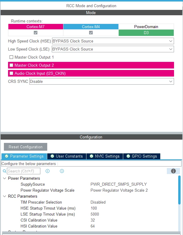

I have started a new project with the option "Start My project from ST Board". I can see that in System Core -> RCC the following information
I can see in the main.c that this information is the same:

Thanks

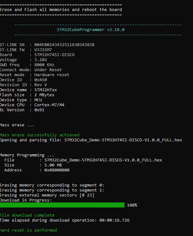

I have download these file: https://www.st.com/resource/en/compiled_demos/stm32h745i-disco_demo.zip
and I have launch "program_hexfile.bat" with the following output
But the screen does not show anything, only a white screen...
I wonder if the board is broken. It is strange to be able to program it without error.
Is it posible that the core is OK but the periferics are boken?

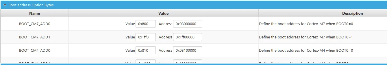

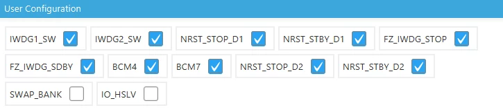

One thing, did you modify the option bytes? especially the boot options?
RafaelSAuthor
Jan 8, 2025 8:32 AM UTC
I will try the algorithm BubbleSort as soon as possible, thanks.
I have not modified the option bytes. I attach a picture
Thanks
mƎALLEm
Jan 8, 2025 10:02 AM UTC
Did you change the boot options or not?
RafaelSAuthor
Jan 8, 2025 10:11 AM UTC
I have not changed the boot options.
