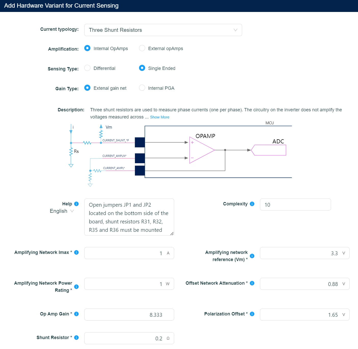

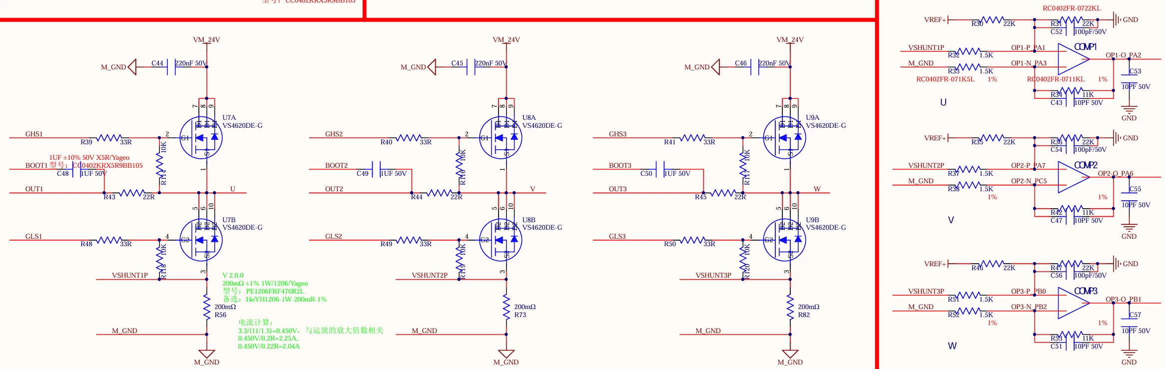

I have a DIY board similar to EVSPIN32G4. Below is the three-shunt sensing circuit(In internal OpAmps, differential, external gain mode)

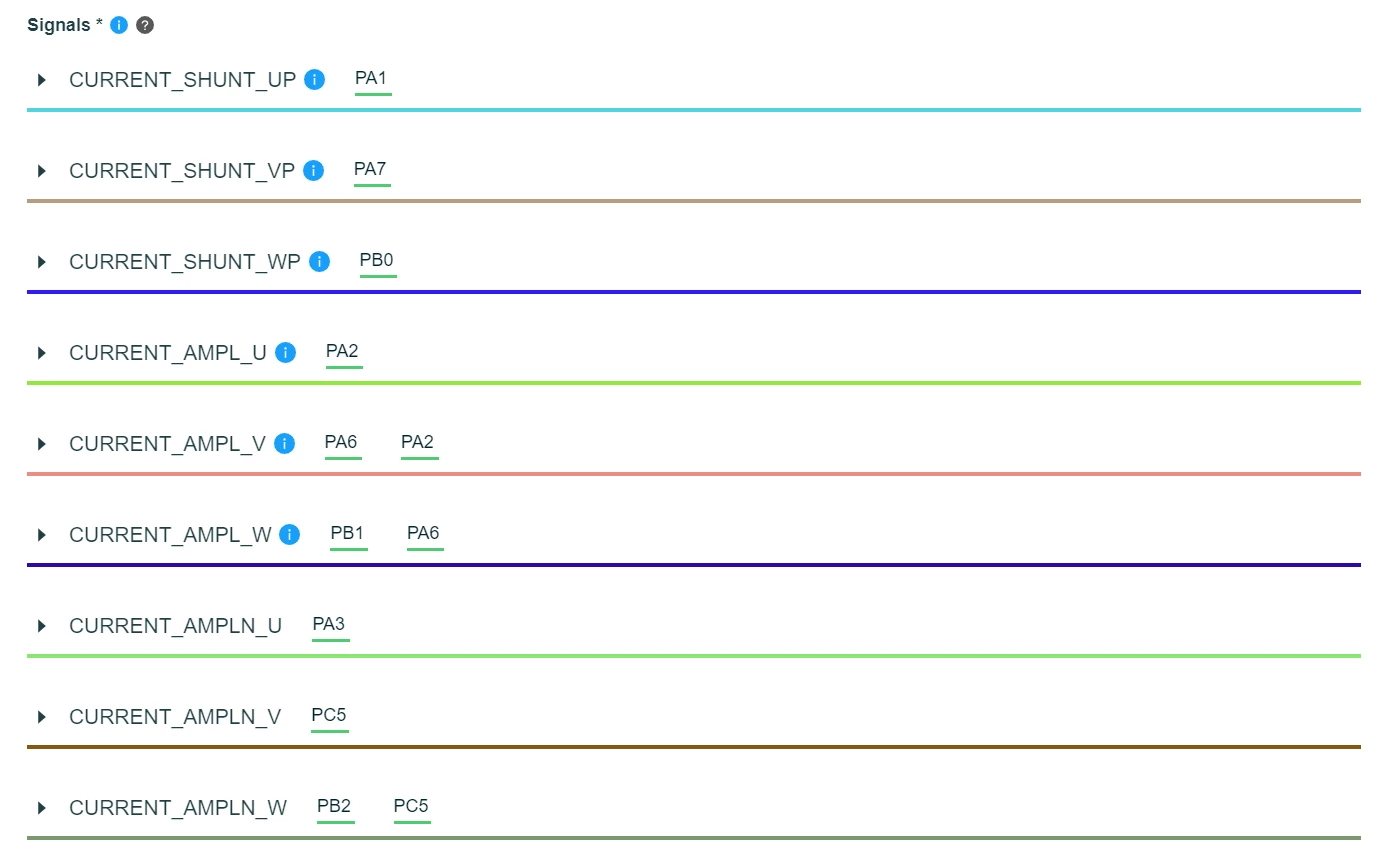

Because the STSPING4 doesn't support internal OpAmps, differential, external gain mode, I just use the below config to generate the project(seems differential or single-end does not influence the code, yes?), see the project in the attachment:

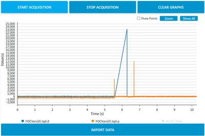

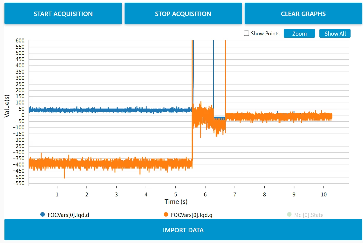

Following is the Iq and Id read by cubeMonitor(start motor at 5.5s):
