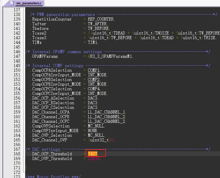

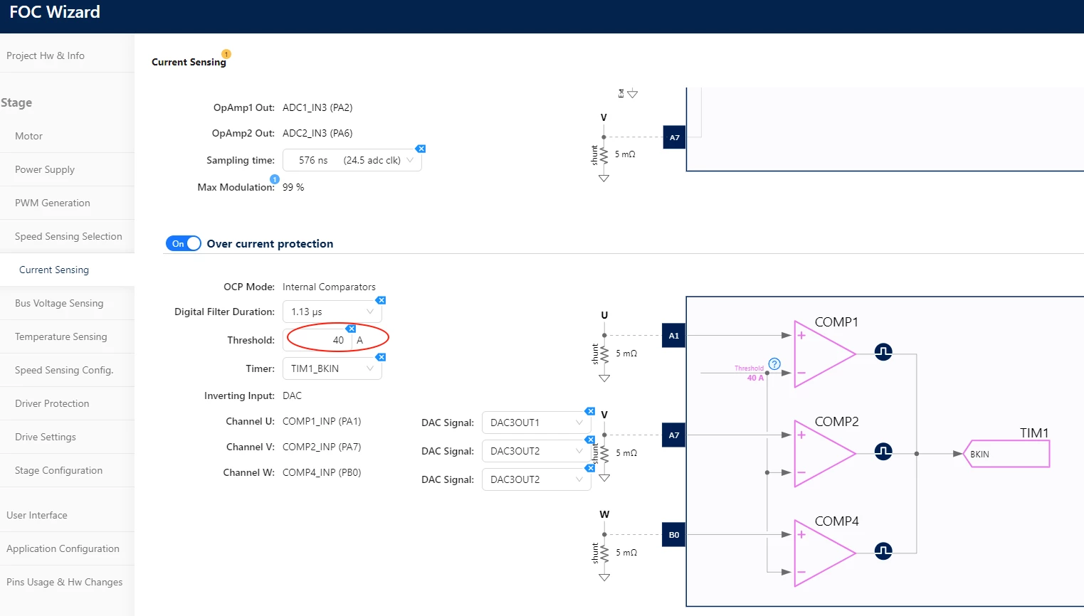

I have an EVSPIN32G4 evaluation board with a sampling resistor of 0.005Ω.
Why does a current of 40A correspond to a threshold of 7427 (0.37V)?
