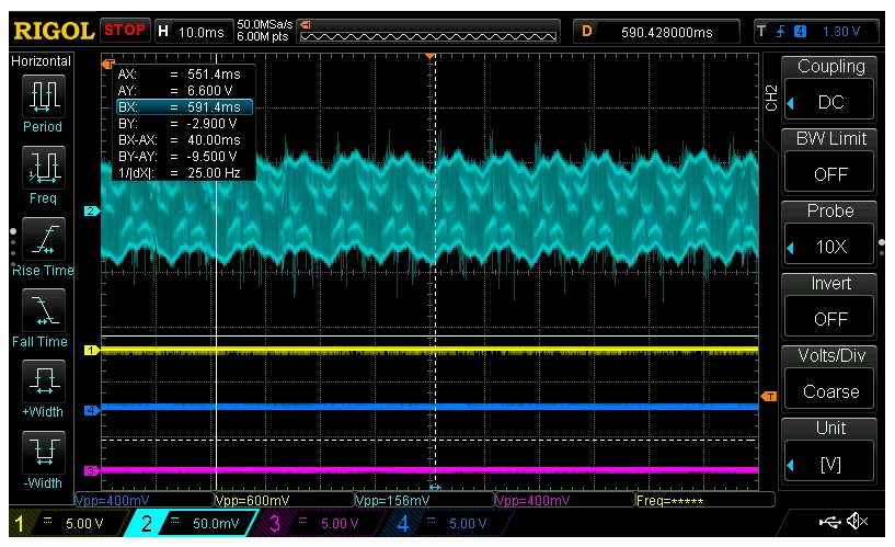

I keep investigating why I have problems driving my motor with negative speeds.
I captured the phase voltage directly on the motor leads (yellow, cyan and magenta channels) and the current on the DAC output (Ia or Ib) and I noticed this peaks on the current waveform.
Zooming in, the currents themselves don't look bad at all
However I do not understand where does peaks are coming from
0693W00000JODRdQAP.pngAny ideas will be greatly appreciated.

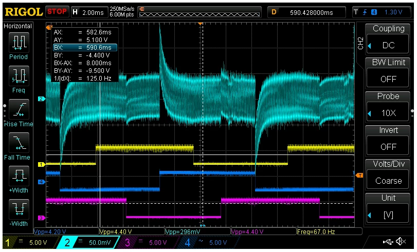

Apparently those peaks in my current signal are somehow correlated to the switching of the hall sensors, instead of measuring the voltage in the motor phases, I measured the hall sensor signals and the output of the DAC (Ia or Ib current) and those peaks appear exactly when the H2 (on the J3 header of the IHM08M1) switches.

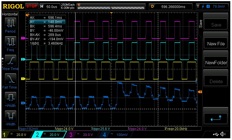

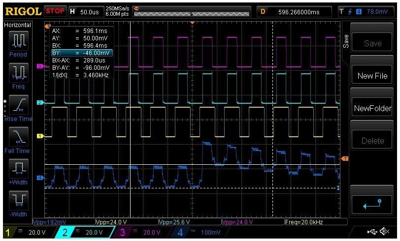

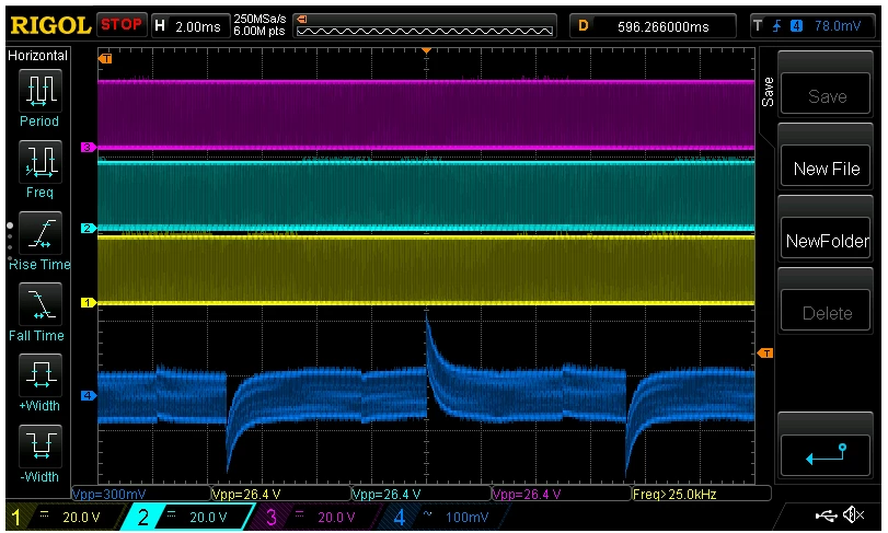

I created a new dummy project using a sensorless approach, but still with the hall sensors connected to the board, the strange waveform is still present
0693W00000JOHqwQAH.pngHowever, when I disconnected the hall sensors from the board, the waveform looks quite different:
0693W00000JOHrkQAH.pngNow I am a quite confused why this can be happening...

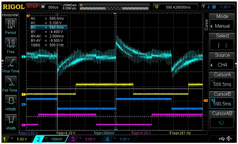

Hello, how do you measure the current? Are you using a DAC or current probe to your oscilloscope? If you are using a DAC, what pin of the board are you connecting from?
der.ule
der.uleAuthor
Feb 3, 2022 11:48 AM UTC
I'm measuring the current from the DAC output (don't have a current probe available at the moment). I'm connecting the oscilloscope in the middle pin of J7 and its ground lead connected to the test point J8.
MK.1
Feb 3, 2022 12:40 PM UTC
Look carefully at the board diagram and you will understand that the signal from the DAC does not get to this connector in any way :)

Well, after a lot of testing, I want to log my experience here in case it helps somebody else:
While looking for a solution to my problems I stumble upon this thread, he had the same setup as me, it turns that I was measuring just noise (and the PWM). In summary, the IHM08M1 is somehow targeted to be used by the Nucleo F302R8 and the Nucleo F401RE and if you are using something else (like in my case Nucleo F303) you will need to grab the soldering iron and fiddle around with some resistors.
