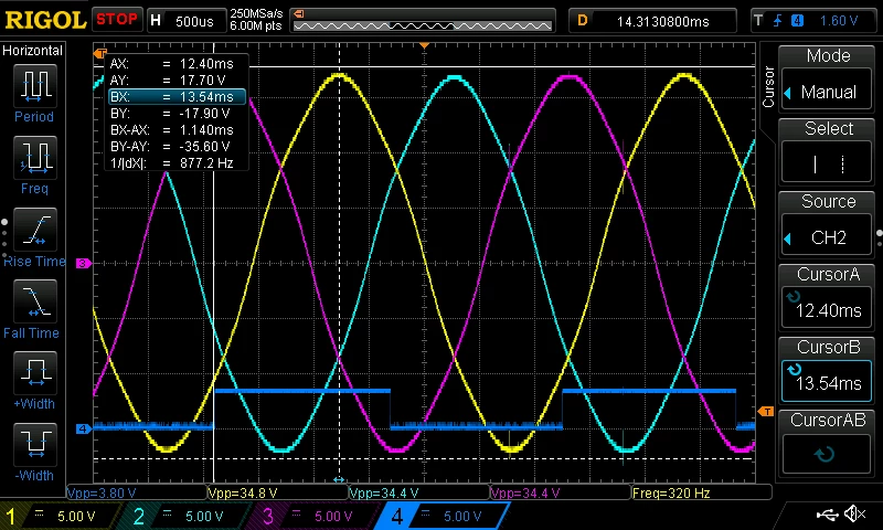

I keep investigating why I have problems driving my motor with negative speeds.
I captured the phase voltage directly on the motor leads (yellow, cyan and magenta channels) and the current on the DAC output (Ia or Ib) and I noticed this peaks on the current waveform.
Zooming in, the currents themselves don't look bad at all
However I do not understand where does peaks are coming from
0693W00000JODRdQAP.pngAny ideas will be greatly appreciated.

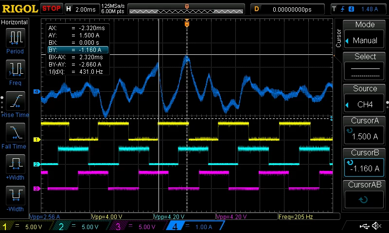

I got my hands on a current probe today and this is what I got from Phase_U at 3000RPM (scaling: 1mV/10mA)
MK.1
Feb 15, 2022 8:26 AM UTC
why does your oscilloscope show a negative current value on a positive half-wave? sorry, didn't look there

Please bring the oscillogram of the Hall sensors to the Back EMF Phase_U

I'm not sure what I am suppose to do as I am not using an observer, but the hall sensors.

I think your problem with the reverse rotation of the motor is due to the incorrect electrical angle of the shift of the Hall sensors. This can be easily checked with an oscilloscope. Draw a diagram.
MK.1
Feb 16, 2022 11:26 AM UTC
0693W00000JQ1ITQA1.jpgspin the motor by hand and watch BEMF

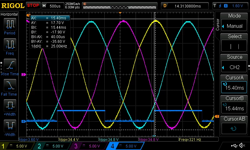

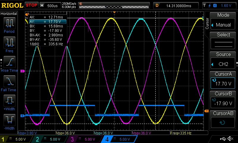

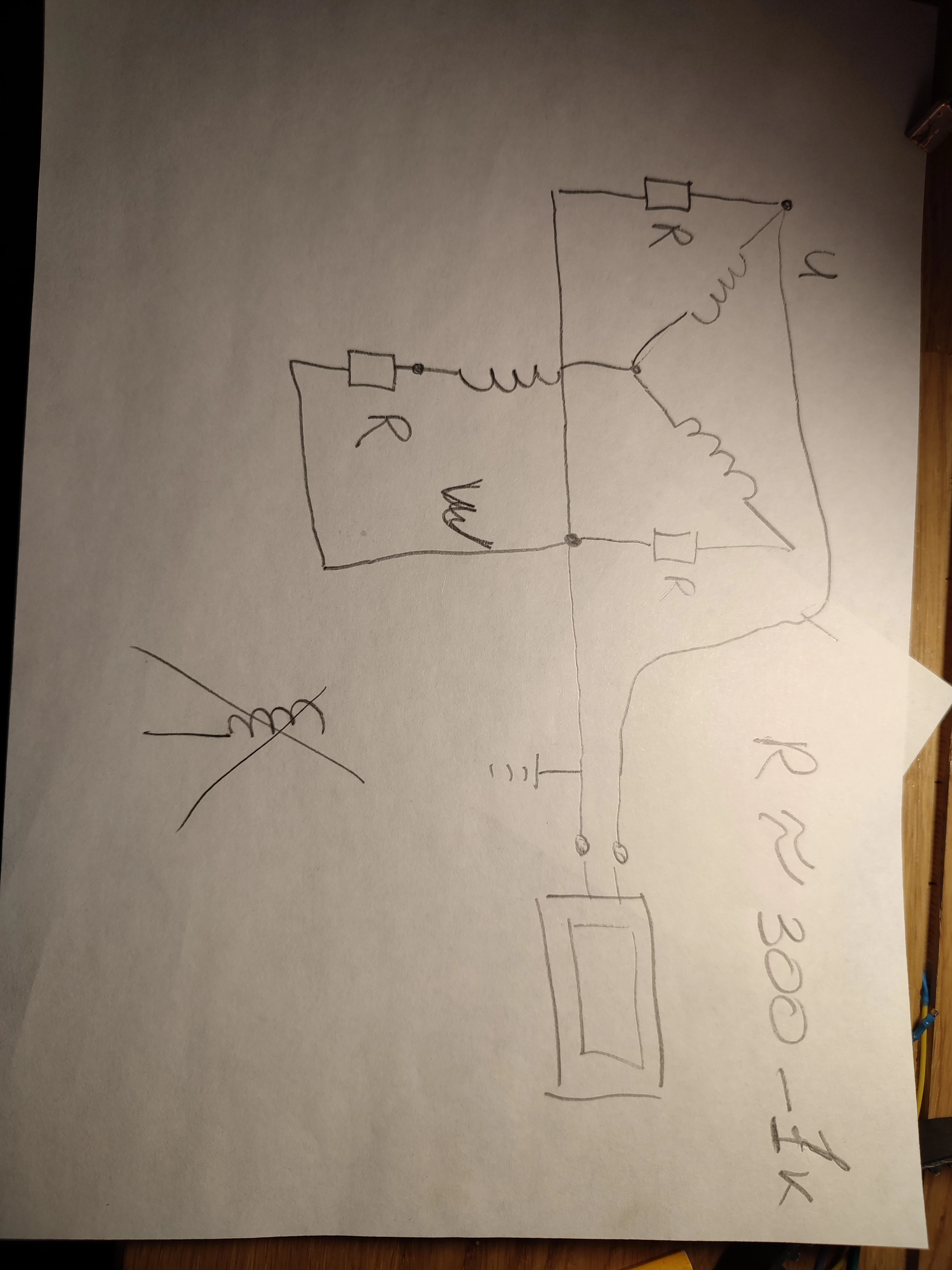

Well I was sure I had done this measurement before (after all this is how I calculated my kV, but only with one phase), I could not find any of my old information, so I repeated the measurements today.
Three phases (P1: Yellow, P2: Cyan, P3: Magenta) and H10693W00000KaHmdQAF.pngThree phases (P1: Yellow, P2: Cyan, P3: Magenta) and H2
0693W00000KaHmTQAV.pngThree phases (P1: Yellow, P2: Cyan, P3: Magenta) and H3

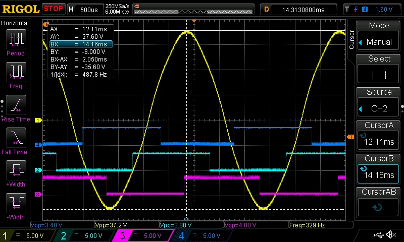

0693W00000KaHmOQAV.pngThree halls (H1: Blue, H2: Cyan, H3: Magenta) and phase 1 (U/L1/P1)

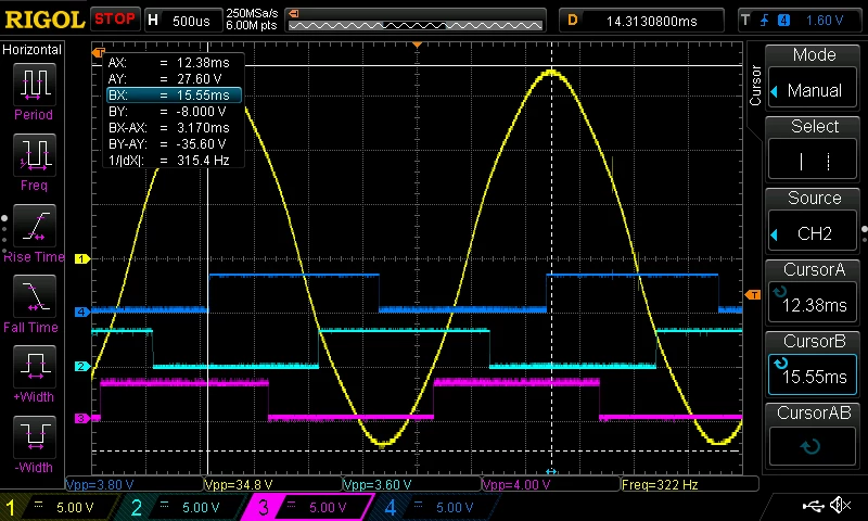

0693W00000KaHm4QAF.pngThree halls (H1: Blue, H2: Cyan, H3: Magenta) and phase 2 (V/L2/P2)

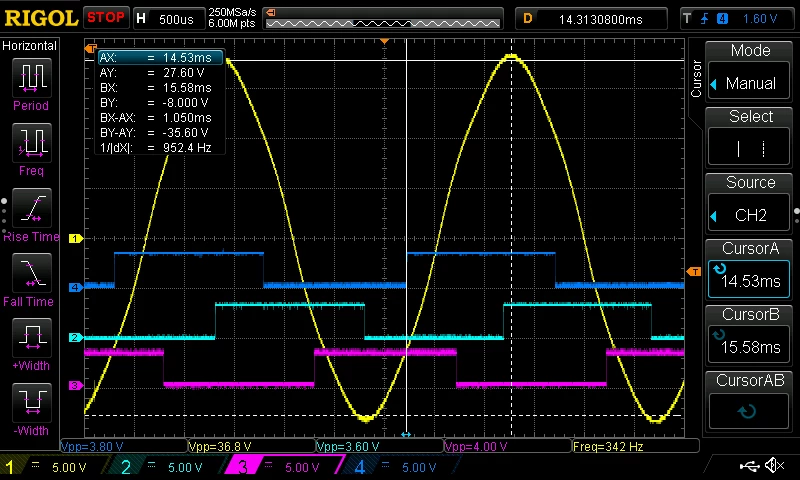

0693W00000KaHluQAF.pngThree halls (H1: Blue, H2: Cyan, H3: Magenta) and phase 3 (W/L3/P3)

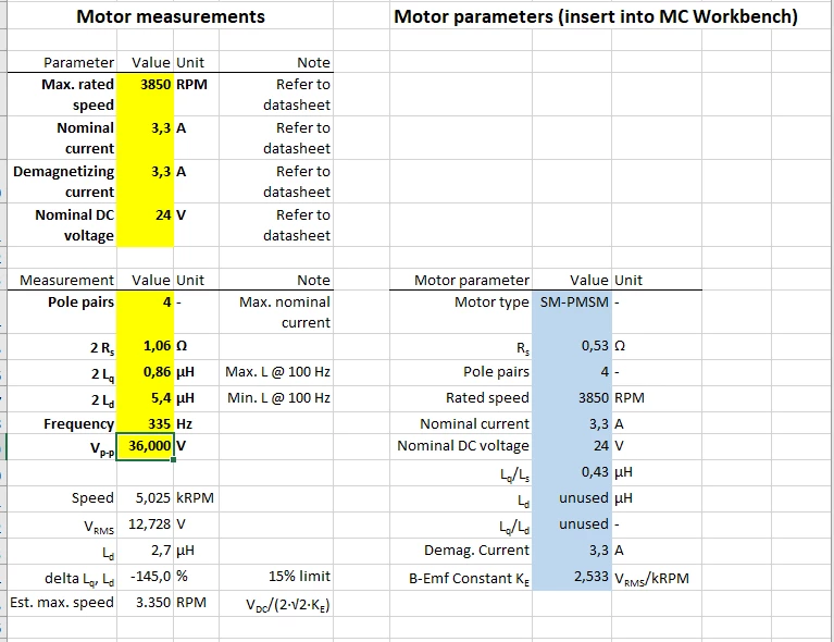

0693W00000KaHlkQAF.pngI used the motor calculator from ST to calculate the kV which turns out to be this time 2,53 Vrms/kRPM (I had a value closer to 4 last time, not sure if those resistors to form the virtual ground have an influence in my measurement)
0693W00000KaHkIQAV.png EDIT: I don't know why but my images did not appeared in the post the first time.
