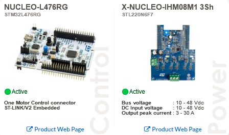

Control Board: Nucleo-L476G
Power Board: X-Nucleo-IHM08M1 3Sh

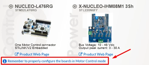

Configuration:
Completed the configuration using this link:
Control Board:
Removed JP1, plugged JP5 as shown & LD3 turned ON.
Plugged in two jumpers on CN2.
Soldered bridges SB55 OFF, SB16 & SB50 ON.
Power Board:
Soldered jumpers J5 & J6 for 3Sh as shown.
Removed R181.
Plugged JP1 & JP2 as shown.

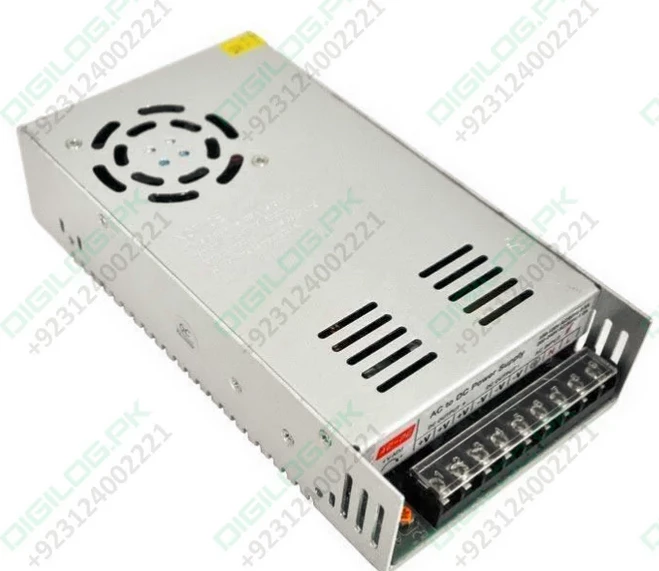

Power Supply:
Supplies 12V at max 40A as shown below.
