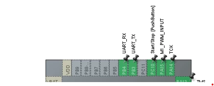

For the current setup, I have USART1 configured for MCP using the MC Workbench but ST-LINK also uses this USART.
I was trying to read user input from the comm port using an application like Putty or Ucon (since ST-LINK is over USB on this comm port) but this particular USART is configured for MCP and probably my inputs are not correctly transferred to the memory.

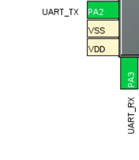

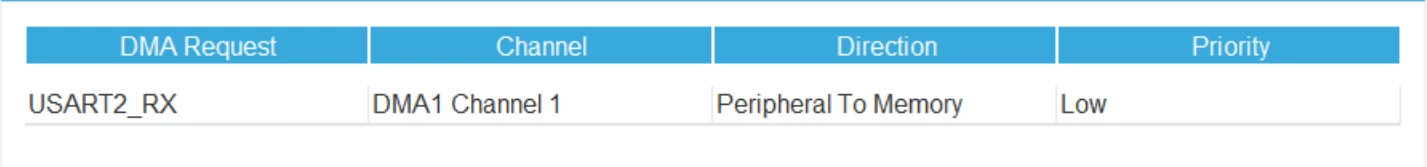

I configured the USART2 in Asynchronous Mode and also Enabled the DMA1 on Channel 1 (Peripheral to Memory in Normal Mode).
These Pins PA2 & PA3 are available over the Comm port so I am able to send my input over Putty but not quite.

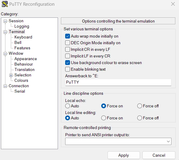

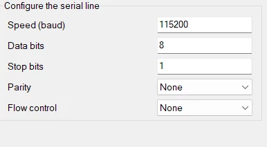

Is there something missing from the putty or the terminal configuration or this code.
My putty is configured as follows :
