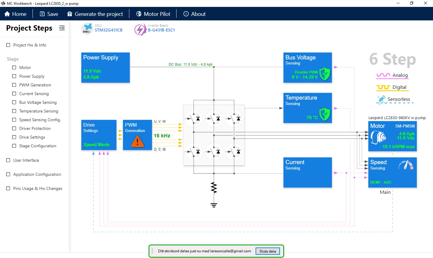

Hi!

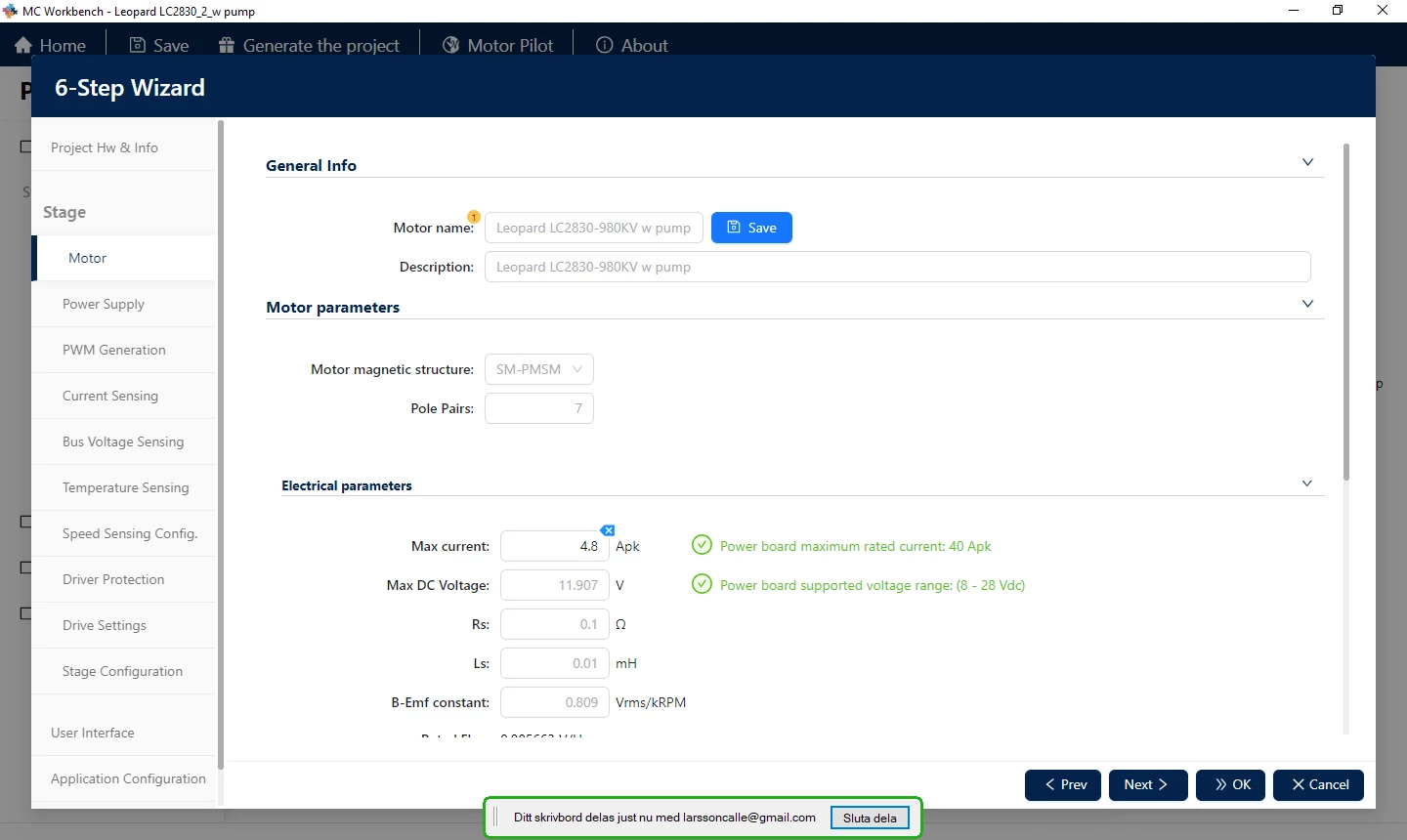

Trying to use a Leopard LC2830-980KV motor with the B-G431B-ESC1.

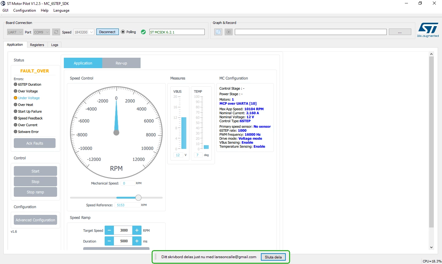

I have managed to program the device with the MC Workbench and can run the motor using the Motor Pilot software. However I can't seem to get the speed over 2100 rpm for some reason.
I can get the motor to speed up to 2100 pretty rapidly when playing with the rev-up settings, but when I request a faster speed it just stays at 2100 rpm and starts to draw more current until eventually my power supply (5A) goes into over current.
Any tips on what I can check/test?
Thanks,
Carl

Hello @carllarsson,
You can go to our Motor control Wiki page, there are two chapters about 6-step algorithm, and please check "6-step Optimization and troubleshooting of sensor-less firmware parameters" chapter.
On the other hand, MCSDK 6.3.0 has been released (refer to this post) and please consider using it as many 6-step enhancements have been introduced.
