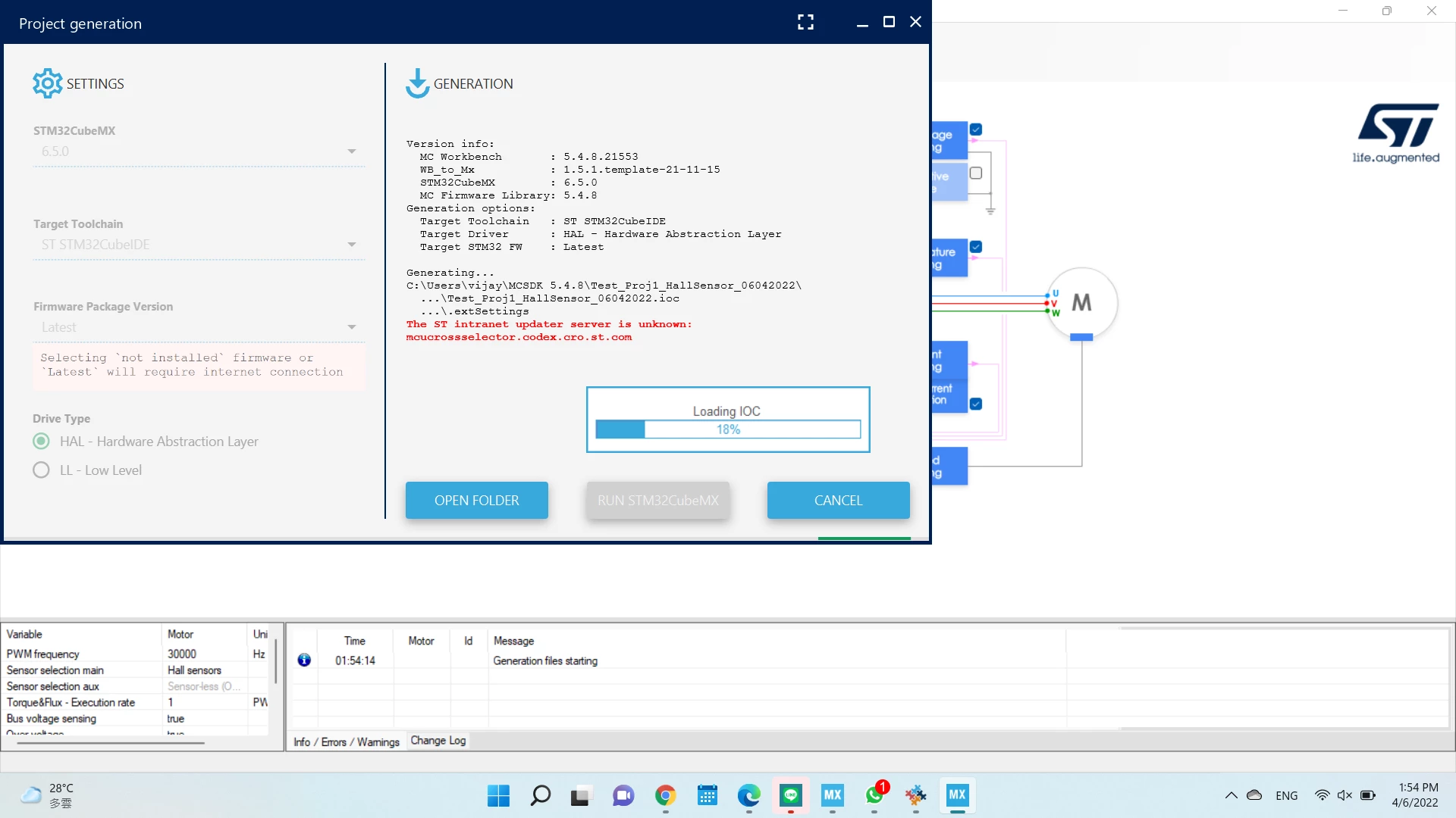

MC Workbench GENERATION reports errors for any of the included example projects.
  • March 4, 2022
  • 20 replies
  • 8158 views
Help! I'm new to ST development tools. All I'm trying to do right now is generate an MC Workbench example project. Any example project.
MC Workbench GENERATION always reports the following error:
"The ST intranet updater server is unknown: mcucrossselector.codex.cro.st.com"
Any suggestions greatly appreciated.

I am also facing the same issue. However, in my case:
Motor COntrol Workbench: 5.4.8
ST CubeMX: 6.5.0
CubeIDE: 1.9.0
When Click on generate new Project, it generates the source file with many errors.
cedric H
Technical Moderator
April 6, 2022
Hello @hwa​
The MotorControl Workbench generates a file with the .ioc extension in your project folder.
Once this file is generated, MotoControl Workbench calls cubeMX in background to generate your project.
The issue your are reporting comes from cubeMX for a reason that I ignore.
Could you try to open cubeMX tool, and load from there your ioc file generated by the MC workbench.
From cubeMX you have a "Generate Code" blue button, it will generate your project.
Let me know if that does the job.
Regards
Cedric

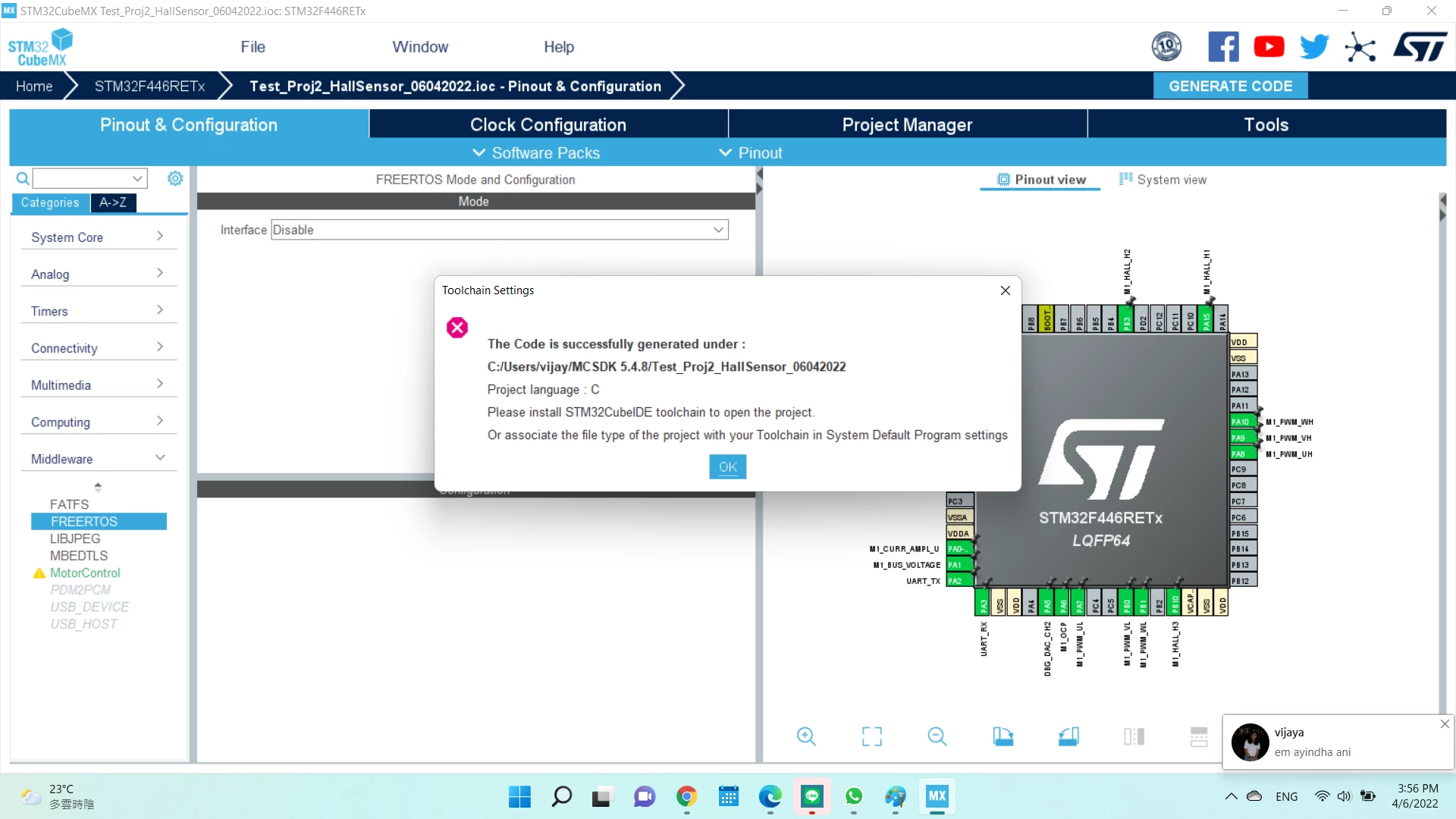

Vijay Ganisetti
April 6, 2022
Hi @cedric H​ ,
Opened CubeMX and generated Code, but an error exists. Previously, in older versions, this error doesn't exist.
Help me to solve this issue.
cedric H
Technical Moderator
April 6, 2022
@Community member​,
I do not see any error in your attached screenshot, the pop-up window states that your code is successfully generated.
You selected the STM32CubeIDE toolchain, and it seems that this toolchain is not installed.
If you want to generate a project for another compiler, you can configure it in "Project Manager" tab.
Or you can download stm32CubeIDE for free here.
Cedric

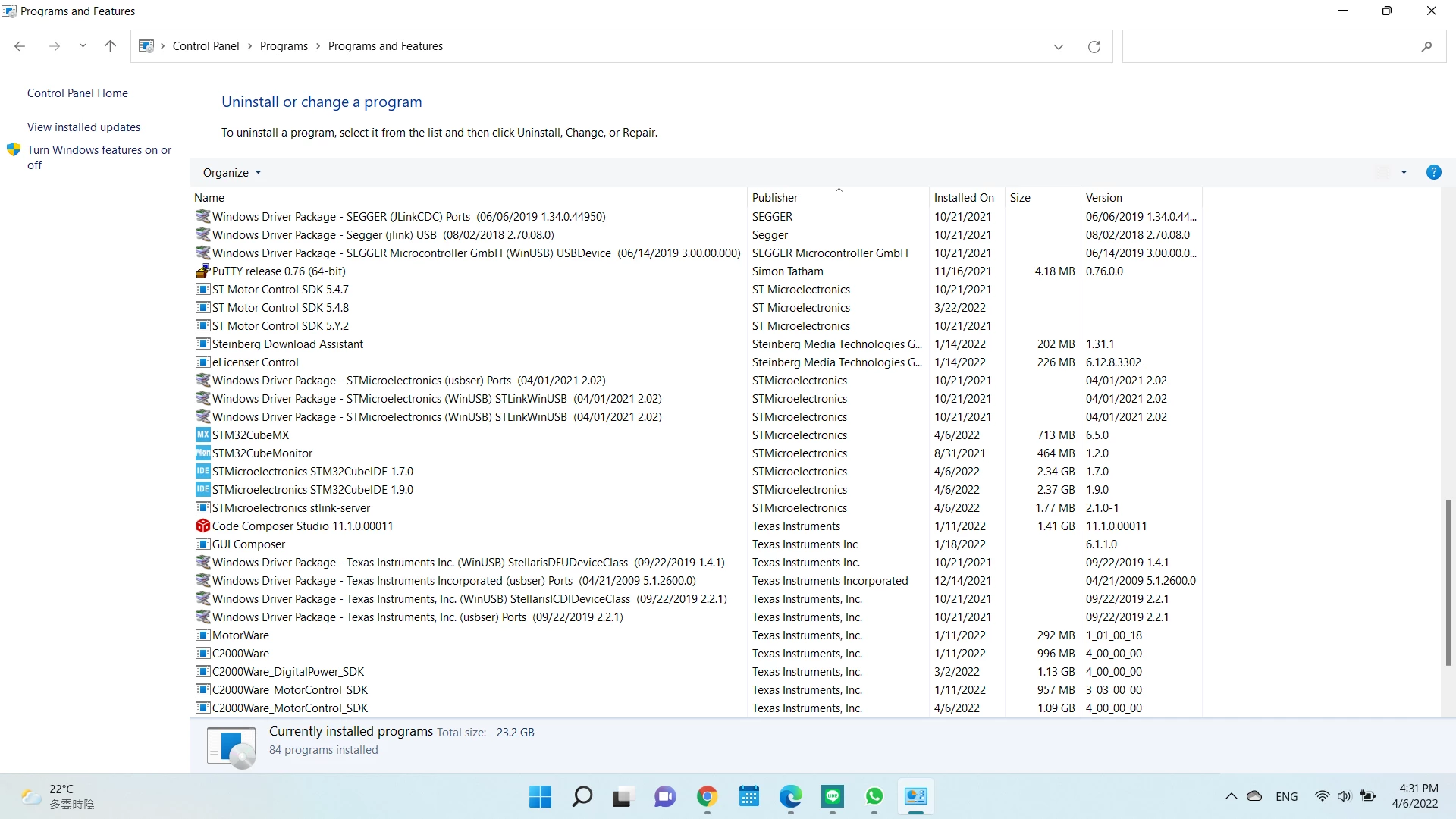

Vijay Ganisetti
April 6, 2022
Hi @cedric H​ ,
I already installed latest version, cubeiDE 1.9.0
cedric H
Technical Moderator
April 6, 2022
Ok, then you should be able to open your generated project by double clicking on your .cproject file located here :  C:\Users\vijay\MCSDK 5.4.8\TestProj1_HallSensor_06042022\STM32CubeIDE
It is weird that cubeMX did not find your cubeIDE installation.
Cedric
