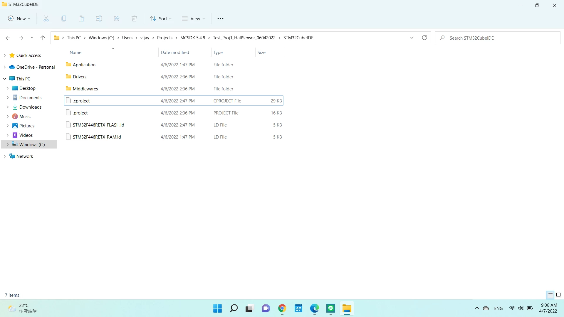

Vijay Ganisetti
April 7, 2022
Hi @cedric H​ ,
Cannot open it by double clicking, it doesn't show any suggested IDE icon.
Should i re install again??
cedric H
April 7, 2022
Hello @hwa​,
It looks like your project is corrupted with some files missing.
There are two things possible with the ESC board.
  • Starting from an example with additional code.
  • Starting from the board selector without any additional code.
Two examples are provided, one to make use of potentiometer, one to control the speed from a PWM Timer input (basically used by flight controller)
If you want to start from the example, you must select it from the "Example projects" list proposed at the first window. You shall not open the example from the stmcx file. The example flow requires you click on update button at the generation phase.
If you start from a new project an select the ESC board from the inverter list, you will be able to generate your project with "generate" button only. You will be able to control your motor with MC Pilot and start/stop button only.
May I ask you to start from scratch two new projects :
  • One from "New project" button and selecting B-G431B-ESC1 from inverter list
  • One by clicking in one example from the example list.
Both projects must compile and successfully.
Hope it helps
Cedric
