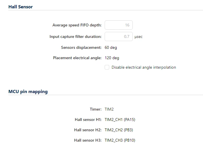

    J'ai configurer le contrôle moteur avec un capteur effet hall en auxiliaire.
le moteur tourne mais les valeur des registre ne change pas. elle prennent une valeur différente a chaque démarrage mais ensuite ne change jamais.
Comment vérifier ces paramétrages ?
Pourquoi les valeur de registre ne change pas ?
J'ai vérifier tout le câblage, il est bon.
J'utilise une nucléo-G431RB et X-NUCLEO-IHM08M1
Merci pour votre aide

    Hello @Christophe65,
    As Hall Sensor is set Auxiliary, motor will spin even if Hall Sensor is not functional.
    Could you please check with a scope HALL sensor signals?
    On the other hand, you can also display these parameters with high-speed plotting as described here.

    The registers I want to read are those related to the Hall effect sensor with the ST Motor Pilot V1.2.9 - MC_FOC_SDK:
    I am using the Motor Pilot to study motor control and plan to use the SDK to control a brushless motor with a Hall effect sensor to operate an industrial door.
    The value of this register changes every time the motor starts and then remains constant.
    Thank you for your help.

    My problem is solved. After analyzing the signals, I realized that I had forgotten to add Pull-Up resistors on the outputs of the HALL sensor."
