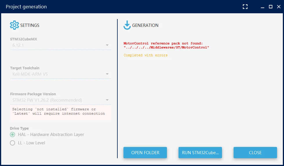

how to deal with ST Motorl Workbench to Project generation problem??
2024-10-30 16:22:59,914 DEBUG [Main.lambda$run$0] Arguments: [-ioc, E:\Document\Ufactory\xArm\SDK\jointMotor\850\st_afr\Noname\Noname.ioc, -xdm, E:\Document\Ufactory\xArm\SDK\jointMotor\850\st_afr\Noname\Noname.wb_def]
2024-10-30 16:22:59,925 DEBUG [ArgsValue.readPropertiesFile] [AppConfig] pack.source = "D:\Sofeware\Program\DriveTool\STM32_MCSDK\Soft\MC_SDK_5.Y.4\Middlewares\ST\MotorControl"
2024-10-30 16:22:59,931 DEBUG [ArgsValue.readPropertiesFile] [UserConfig] pack.source not found
2024-10-30 16:22:59,931 DEBUG [ArgsValue.getConfigProperties] pack.source = "../../../../Middlewares/ST/MotorControl"
2024-10-30 16:22:59,943 DEBUG [ArgsValue.lambda$retrieve$2] CLI_ARG[xdm]: E:\Document\Ufactory\xArm\SDK\jointMotor\850\st_afr\Noname\Noname.wb_def
2024-10-30 16:22:59,943 DEBUG [ArgsValue.lambda$retrieve$2] CLI_ARG[ioc]: E:\Document\Ufactory\xArm\SDK\jointMotor\850\st_afr\Noname\Noname.ioc
2024-10-30 16:22:59,945 DEBUG [ArgsValue.retrieve] {xdm=E:\Document\Ufactory\xArm\SDK\jointMotor\850\st_afr\Noname\Noname.wb_def, updftl=templates/wb_ioc_mc-middleware.ftl, mx_timeout=-1, exp=templates/wb-defines_where_and_what.txt, ioc=E:\Document\Ufactory\xArm\SDK\jointMotor\850\st_afr\Noname\Noname.ioc, pack=../../../../Middlewares/ST/MotorControl, ftl=templates/wb_ioc_template.ftl}
2024-10-30 16:23:00,077 DEBUG [Main.run] Targeted MCU family = F4
2024-10-30 16:23:00,125 DEBUG [Main.run] Minimum associated CubeMx to the `F4` targeted MCU family is `4.25.0-a0`
2024-10-30 16:23:00,170 DEBUG [WindowsCubeMxFinder.lambda$findThem$2] Found 64-bit subkey HKEY_LOCAL_MACHINE\~~~\Uninstall\STM32CubeMX
2024-10-30 16:23:00,172 DEBUG [WindowsCubeMxFinder.lambda$findThem$2] Found 64-bit subkey HKEY_LOCAL_MACHINE\~~~\Uninstall\STM32CubeMX(1)
2024-10-30 16:23:00,183 DEBUG [CubeMxCtx.EXE_version] Loaded path: 'D:\Sofeware\Program\Cubemx\Sofe\STM32CubeMX.exe'
2024-10-30 16:23:00,183 DEBUG [CubeMxCtx.EXE_version] Loaded updater jar: 'D:\Sofeware\Program\Cubemx\Sofe\plugins\updater.jar'
2024-10-30 16:23:00,208 DEBUG [CubeMxCtx.EXE_version] Loaded path: 'D:\Sofeware\Program\Cubemx\S6.9\STM32CubeMX.exe'
2024-10-30 16:23:00,209 DEBUG [CubeMxCtx.EXE_version] Loaded updater jar: 'D:\Sofeware\Program\Cubemx\S6.9\plugins\updater.jar'
2024-10-30 16:23:00,254 DEBUG [CubeMxCtx.EXE_version] Loaded path: 'D:\Sofeware\Program\Cubemx\Sofe\STM32CubeMX.exe'
2024-10-30 16:23:00,255 DEBUG [CubeMxCtx.EXE_version] Loaded updater jar: 'D:\Sofeware\Program\Cubemx\Sofe\plugins\updater.jar'
2024-10-30 16:23:00,256 DEBUG [CubeMxCtx.EXE_version] Loaded path: 'D:\Sofeware\Program\Cubemx\S6.9\STM32CubeMX.exe'
2024-10-30 16:23:00,257 DEBUG [CubeMxCtx.EXE_version] Loaded updater jar: 'D:\Sofeware\Program\Cubemx\S6.9\plugins\updater.jar'
2024-10-30 16:23:00,289 DEBUG [CubeMxCtx.EXE_version] Loaded path: 'D:\Sofeware\Program\Cubemx\Sofe\STM32CubeMX.exe'
2024-10-30 16:23:00,290 DEBUG [CubeMxCtx.EXE_version] Loaded updater jar: 'D:\Sofeware\Program\Cubemx\Sofe\plugins\updater.jar'
2024-10-30 16:23:00,294 DEBUG [CubeMxCtx.EXE_version] Loaded path: 'D:\Sofeware\Program\Cubemx\S6.9\STM32CubeMX.exe'
2024-10-30 16:23:00,294 DEBUG [CubeMxCtx.EXE_version] Loaded updater jar: 'D:\Sofeware\Program\Cubemx\S6.9\plugins\updater.jar'
2024-10-30 16:23:06,230 DEBUG [CubeMxCtx.EXE_version] Loaded path: 'D:\Sofeware\Program\Cubemx\Sofe\STM32CubeMX.exe'
2024-10-30 16:23:06,230 DEBUG [CubeMxCtx.EXE_version] Loaded updater jar: 'D:\Sofeware\Program\Cubemx\Sofe\plugins\updater.jar'
2024-10-30 16:23:06,238 DEBUG [CubeMxCtx.EXE_version] Loaded path: 'D:\Sofeware\Program\Cubemx\S6.9\STM32CubeMX.exe'
2024-10-30 16:23:06,239 DEBUG [CubeMxCtx.EXE_version] Loaded updater jar: 'D:\Sofeware\Program\Cubemx\S6.9\plugins\updater.jar'
2024-10-30 16:23:06,299 DEBUG [EnvironmentChecker.checkPack] STM32CubeMX.Version: 6.12.1-RC4
2024-10-30 16:23:10,342 ERROR [LineInfo_to_exitCode.manage_MCPackNotFound] MotorControl reference pack not found: "../../../../Middlewares/ST/MotorControl"

    Hello @muzili,
    Please use CubeMx 6.4.0 version as specified on MCSDK 5Y4 release note.
    On the other hand, you can also use the latest delivery MCSDK 6.3.1 available here.
    If you agree with the answer, please accept it by clicking on 'Best answer'.Best regards.GMA
